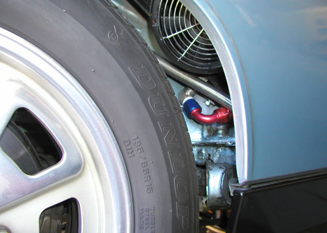

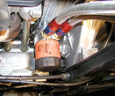

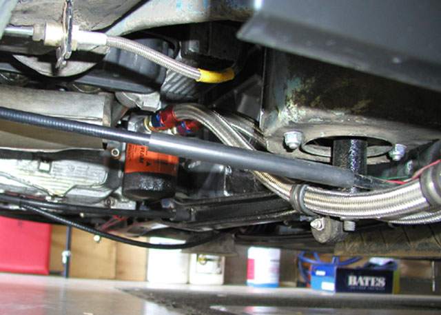

I have sucessfully installed an oil cooler (the real radiator type, not a cheap one that looks like a base board heater) in the forward right rear wheel well and used a small 6" 12v fan to move air through it. When I turned the fan on, I could watch the oil temp decrease and the oil pressure increase. I connected it with a MOCAL thermostat sandwich adapter plate under the oil filter, also used Aeroquip AN-10 S.S. braided lines and fittings. Worked Great!
I may have some pictures on my other computer, I'll have to check.
Disclaimer: This was a street car, not a race car.

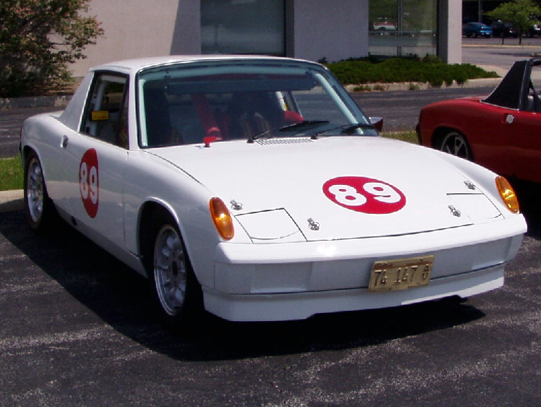

I don't have a pic of this, but one of the guys that comes to our 914 breakfast has one mounted on the engine lid. Works well and yes this is a track car but it also sees street use, he drives it to the diffferent track events (Hi Jon (IMG:style_emoticons/default/wavey.gif) )
I will get a pic of his setup at our next breakfast on August 14th.

Some pics of my oil cooler and thermostat sandwich plate!

post Jul 23 2004, 08:03 PM

Dominic
post Jul 23 2004, 08:04 PM

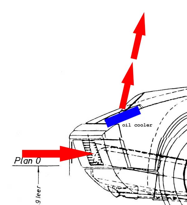

I thought about venting out the headlight bucket like this or mounting the cooler behind the foglight grille.
Now I have decided to try running dual coolers at the rear of the car. There is a production 914 that has run this way for years very succesfully. Don't think this arrangement would be good for a street car though.
Another issue is that the length of oil lines to the front is almost double than runnig even both coolers at the rear. For a wet sump like a TIV, I think this could be an issue.
