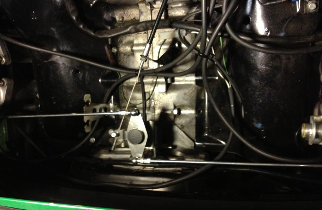

One thing I need to email everyone about is that you may find it worked better to route the throttle cable between the engine shelf and the engine tin. The angle is slightly better for the cable to mount in the new black bracket.
Also, use the picture in the first post as a guide.

Got it, looks great, BUT where's the return spring? I thought it was supposed to have one built in.

No specific torque. Just snug it down against the washers.

Got mine today. (IMG:style_emoticons/default/monkeydance.gif) Did a trial fit. Perfect. Thanks Mark. Is this bracket painted or powder coated? I might need to bend it a little and end up needing some touch up.

Got mine installed late yesterday. Ball sockets that actually pop off. I still need to synch and remove the crossbar plate from the top of the carbs. But synching should be a lot easier.
