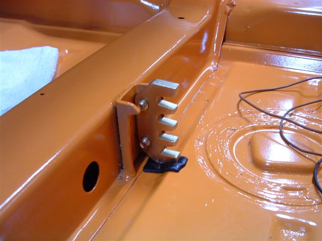

seat tilt adjustment bracket

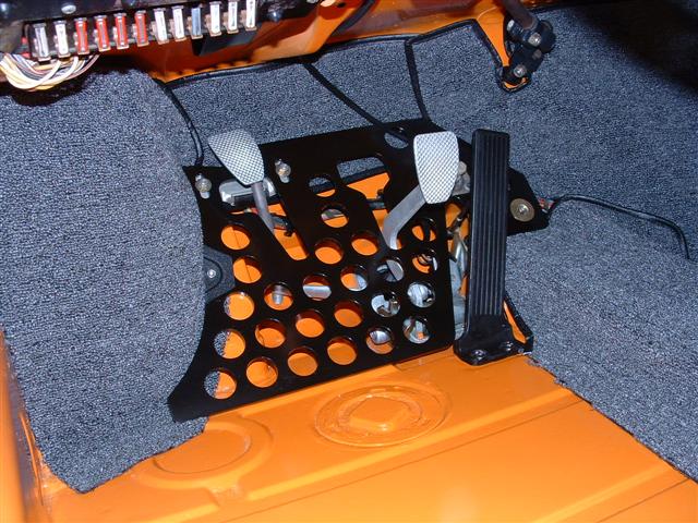

Engman's pedal board in place -another great piece!

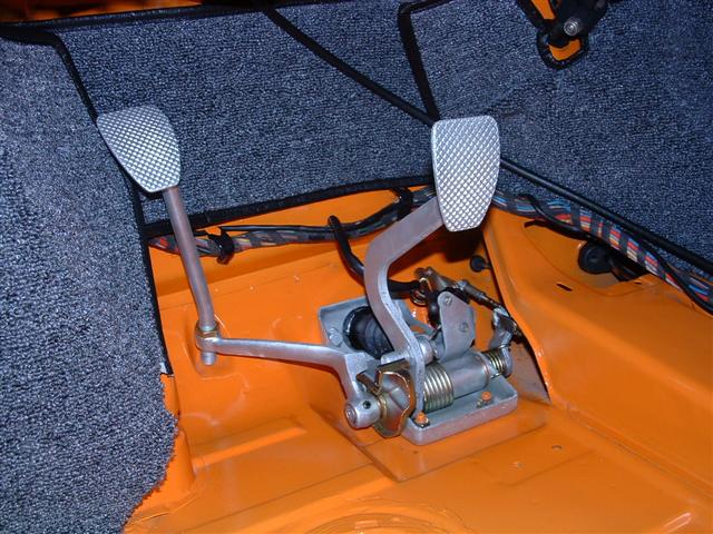

Doug Leggins
post Sep 14 2005, 12:02 AM
Post #24
Posts: 1,358
Joined: 6-February 03
From: Nashville, Indiana
Member No.: 261
Final pedal area

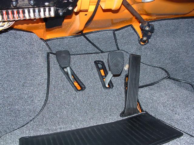

Doug Leggins
post Sep 14 2005, 12:05 AM
Post #25
Posts: 1,358
Member No.: 261

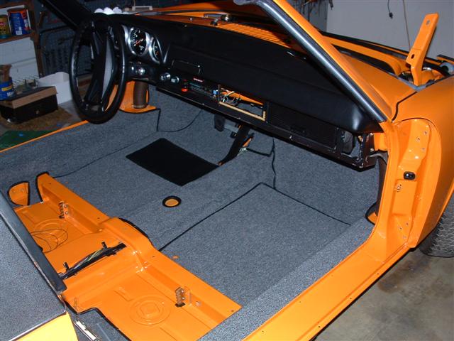

Carpet mostly in place. This is the current status of the interior.

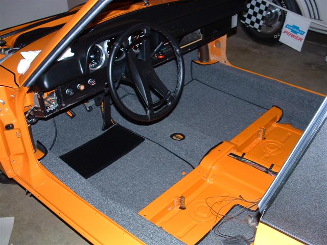

Doug Leggins
post Sep 14 2005, 12:06 AM
Post #26
Posts: 1,358
Member No.: 261
interior again

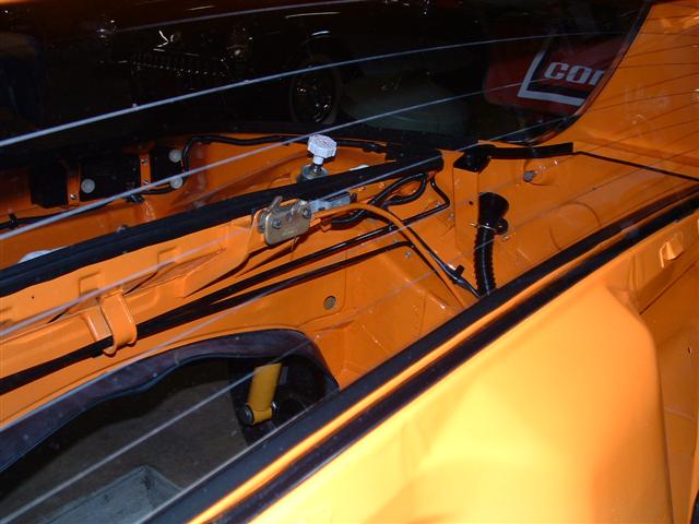

I installed the rear trunk lid torsion bars last night. The one that engages on the driver's side rear trunk roller was a real PITA! I had to disassemble the drain funnels, pop out the targa latch cup, and twist, bend and pull the torsion bar forcefully yet being careful to not scratch the paint. A real PITA! But it is in now (IMG:http://www.914world.com/bbs2/html/emoticons/biggrin.gif) The other torsion rod is not bad at all.

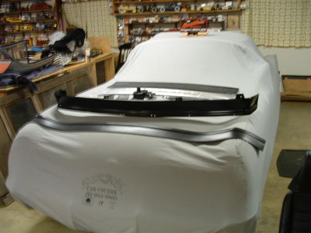

Progress today.
I was able to make good progress on the front bumper area. Damn near got done as much as I hoped I could get done in one evening (IMG:http://www.914world.com/bbs2/html/emoticons/laugh.gif) . That doesn't happen often enough -I am usually lucky to get done half of what I thought i could.
Here's what it looked at the start of the evening.
Doug Leggins
post Sep 14 2005, 11:42 PM
Post #34
Posts: 1,358
Member No.: 261

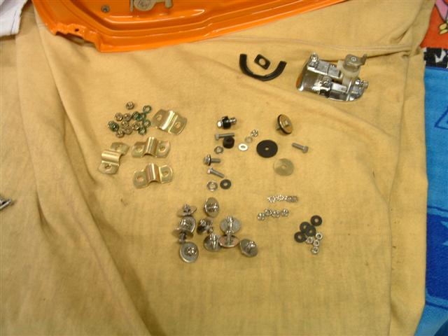

Had my hardware gathered and ready.

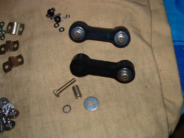

bumper bones and hardware

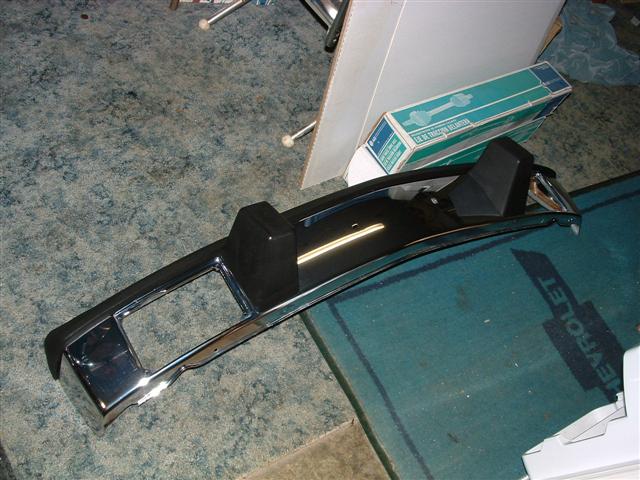

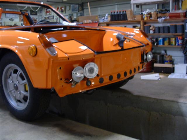

I got a good deal on a 73/74 front bumper months ago. It is in excellent condition. But I did run into a problem with it. The bumper was about 1/2" too narrow to fit on the car. Discovered that the short return on the driver's side was bent in. A little (IMG:http://www.914world.com/bbs2/html/emoticons/smash.gif) and it fit fine.

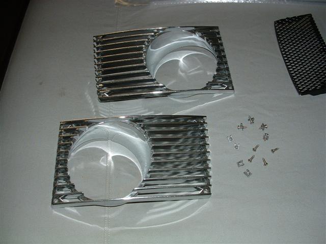

I have several hours of polishing in each of the fog light grills. They were covered in that green corrosion stuff that forms on these parts. A whole lot of scrubbing with chrome polish turned them back into excellent condition.
I also cleaned up the speed nuts for attaching the grills to the bumper, and painted them with metal mask paint from POR products. New SS screws too (IMG:http://www.914world.com/bbs2/html/emoticons/biggrin.gif)

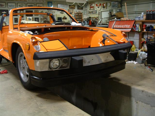

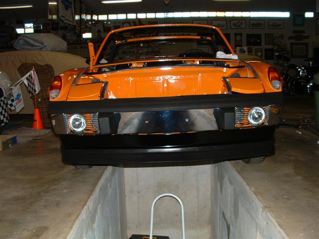

Monday I picked up the fiberglass portion of the front flex dam from the painter. I should have fitted it prior to paint. I had to use a dremel tool to trim a little to get it to fit better.
Doug Leggins
post Sep 15 2005, 12:02 AM
Post #39
Posts: 1,358
Member No.: 261
Still need to adjust the fog lights and add a couple more fasteners. But nearly got it completely installed.
Doug Leggins
post Sep 15 2005, 12:03 AM
Post #40
Posts: 1,358
Member No.: 261
last pic today, hopefully more tomorrow.
