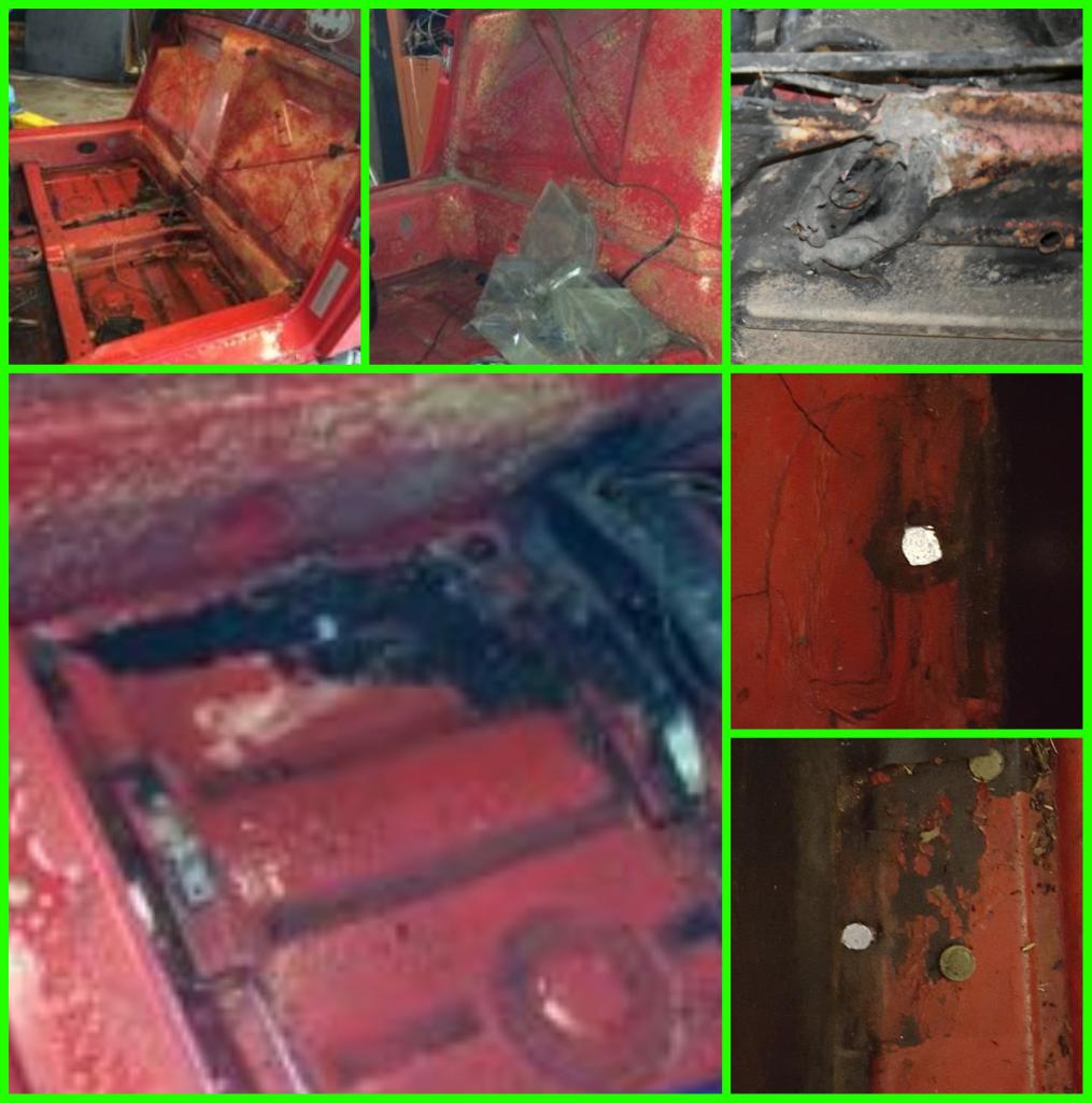

I actually just discovered that there are 4 plugs that look the same as those pictured above in the bottom of the Frunk (I couldn't see them from above because they had been painted over). There were two empty holes in the middle of the frunk floor. Is that where the two drain tubes that Mark makes go?

QUOTE(doug_b_928 @ Jun 21 2017, 03:39 PM) *
Yes

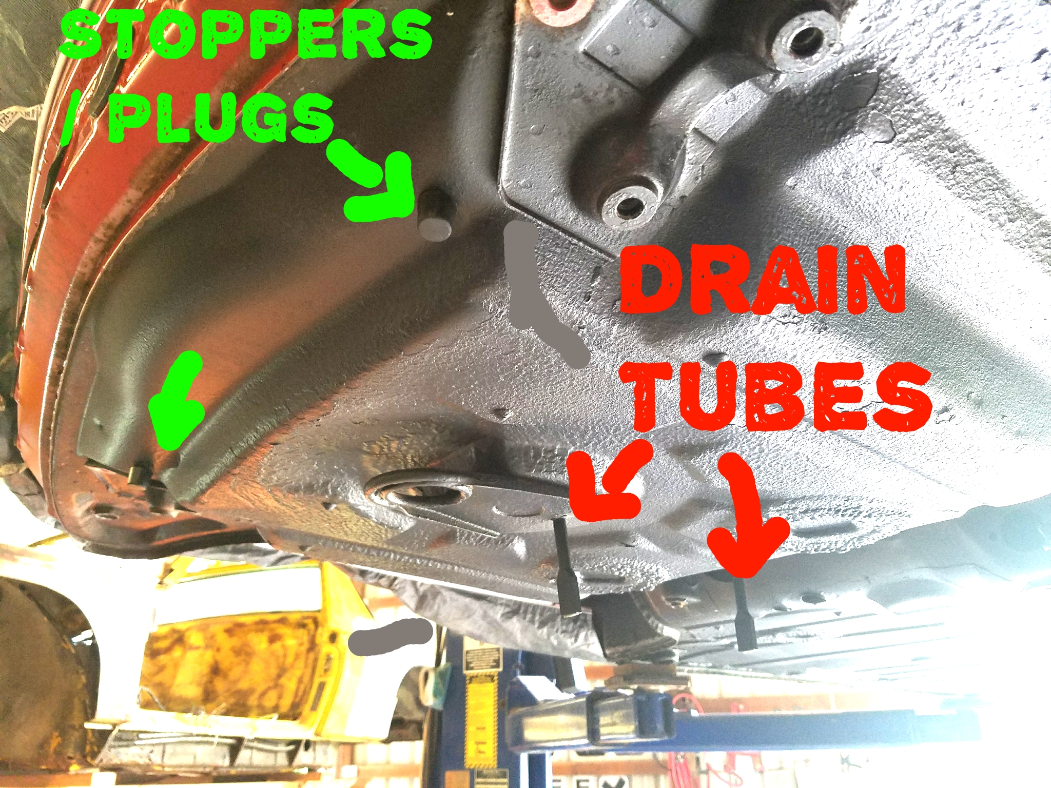

You could use stoppers or drain tubes.

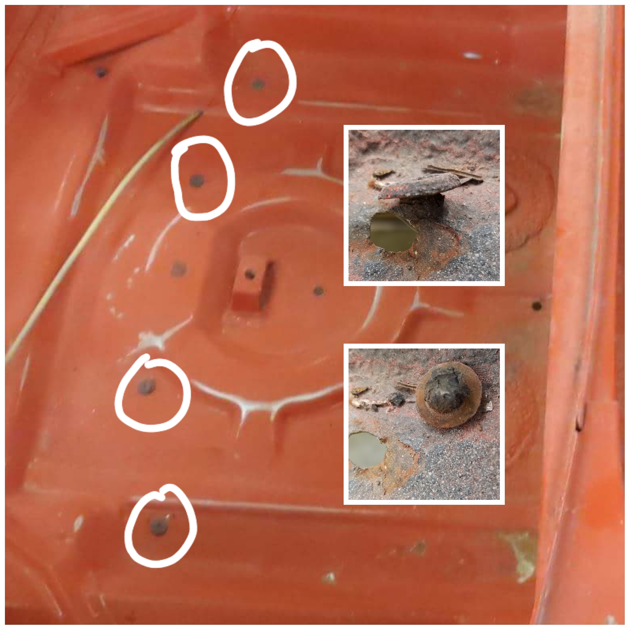

Great pics! I'm missing one of the stoppers and both tubes. The little plugs that you have in your frunk (4 of them between the stoppers and tubes) look to be what should be in the passenger floor as well. Stoppers would certainly do the trick if the holes are the same size.

QUOTE(doug_b_928 @ Jun 21 2017, 09:02 PM) *
These? That's one we don't make yet but seem pretty important for keeping your trunk dry. (And possibly to plug previous owners "fix")

Yep, those are the ones I was referring to and they look like the ones that 'Garland' posted. I measured the holes as follows:
Stoppers: 9.0-9.5 mm
Drain tubes: 9.5mm
passenger floor: 8mm
4 plugs in frunk: 7.0-7.5mm
The holes for the 4 plugs in the frunk are .5mm smaller than the ones in the passenger floor, but I'd think the design of them would mean that the same plugs should work fine in the passenger floor.
Mark/Matt, if you decide to make the plugs they'd be a great addition to your 'ultimate restoration kit'.
