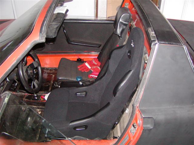

Any update on this guys? How about a picture of the seats just sitting in the car, I'd like to get an idea of the height of the back relative to the rear window. TIA!

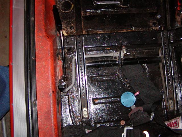

Aight, heres how far i've gotten...
First is the seat sitting on the 914 rail (stock rail.. not my modified one)
Seams fine.. My head is about level with the top of the seat. im 6'..

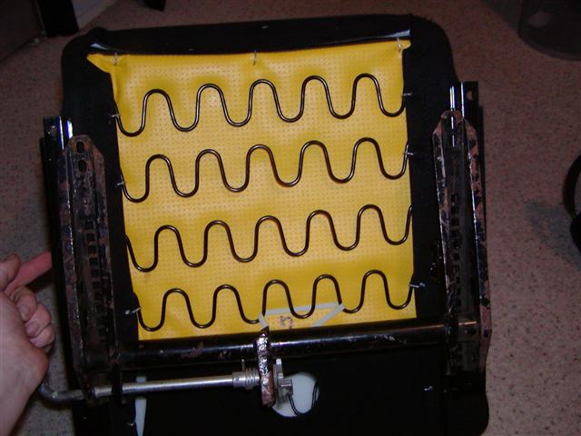

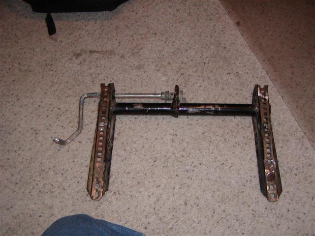

Next, my modified seat rail.
(extra seat rail... lol)
Cut off the 914 part.. and moved the lever pivot over.. Got to move it back, I moved it to far... (vice is a little difficult to use...)

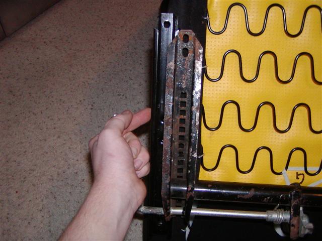

Next is how it compares to the provided seat rails. I will use an L shaped steel bracket to mount the two together... Welded bracket to the 914 seat rail. bolted to the 3A rail.
dan10101

And close up..

And the lever of the stock one.. For comparison purposes..
Hope this helps you guys see what all im doing.
It is completely possible to just mount the given rails to the body of the 914, completely taking out the 914 rails.. but I wanted some hight adjustment, so I decided to try the long way...

looks like putting the seat with the provided rails on top of the 914 unit would add a lot of height. i already brush the roof with my bald head and i am 6'2.
i am following this thread as i have been unlucky in finding a nice set of stock seats in the cheap price range i am willing to pay....
