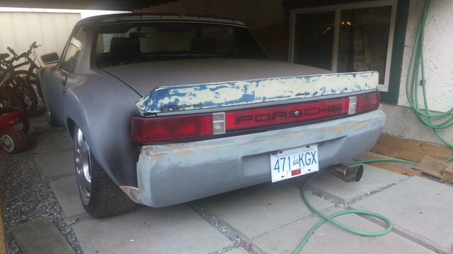

I thought I update my little progress that has been done to this car.

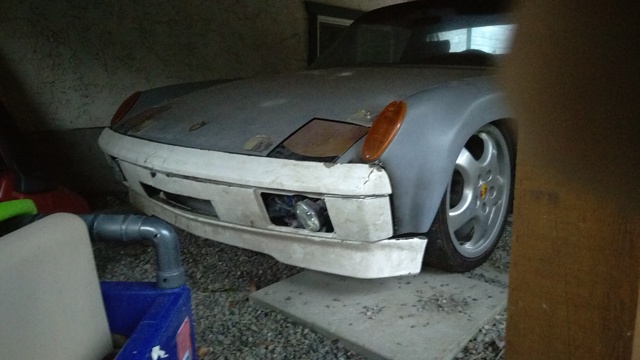

During winter I decided to ditch the 916 front bumper and go back to the stock bumper. Working on it under the deck is a pain in the ass.
(IMG:http://www.914world.com/bbs2/uploads_offsite/i106.photobucket.com-1888-1464919241.1.jpg)
I drove it out from under the deck.
(IMG:http://www.914world.com/bbs2/uploads_offsite/i106.photobucket.com-1888-1464919241.2.jpg)

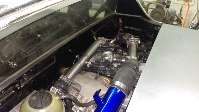

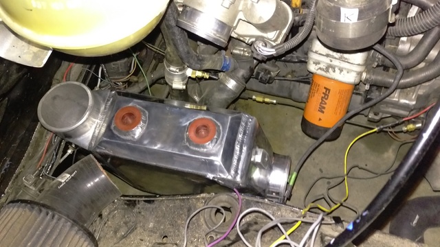

I removed the old intercooler and have started my water to air conversion, but i could only find one spot to put it in.
(IMG:http://www.914world.com/bbs2/uploads_offsite/i106.photobucket.com-1888-1464919241.3.jpg)
Which meant I had to redo most of my boost pipes.
(IMG:http://www.914world.com/bbs2/uploads_offsite/i106.photobucket.com-1888-1464919241.4.jpg)

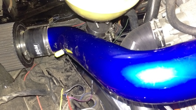

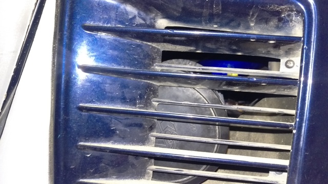

So now I had to find something else that needs cold air, and found a 3 inch cold air intake by chance at the local wrecker for $9 that i chopped down to size, I will paint it later I'm not a fan of the blue.
(IMG:http://www.914world.com/bbs2/uploads_offsite/i106.photobucket.com-1888-1464919241.5.jpg)
(IMG:http://www.914world.com/bbs2/uploads_offsite/i106.photobucket.com-1888-1464919242.6.jpg)

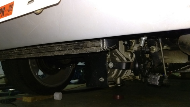

But now I needed somewhere to put the heat exchanger. I mounted it up front without looking first, and found no more room for the additional water lines. So I settled on the other extreme the rear of the car.
(IMG:http://www.914world.com/bbs2/uploads_offsite/i106.photobucket.com-1888-1464919242.7.jpg)
