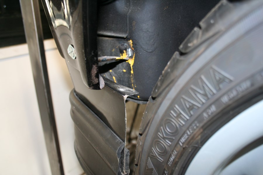

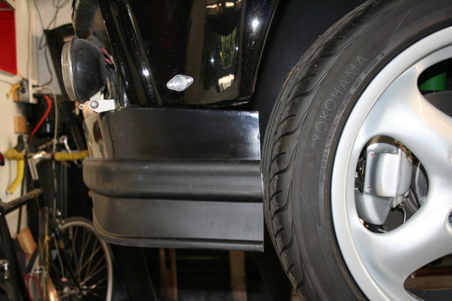

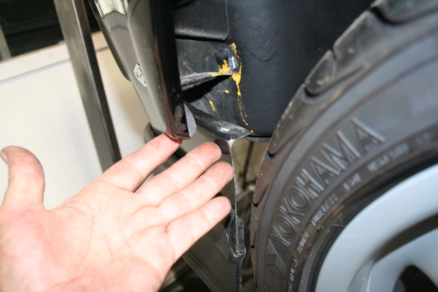

So, I'm congratulating myself on finally getting the five lug conversion and flared fiberglass fenders done and then... OK, what now genius? My front spoiler and air dam don't quite match up. As the Gov. of Texas says, "oops". (IMG:style_emoticons/default/lol-2.gif) The spoiler is fiberglass and I'm wondering if it can be heated with a heat gun and "bent" to match the fender flare? I don't want to but I could also cut it off just before the dzus fastener.

El, no you can't heat fibreglas. Use some tag board, cut a pattern, use masking tape to attach it to your spoiler, rub on a little automotive wax over the masking tape. mix up some fibreglas and lay it up. After it dries you can peal it off the tape, pull the pattern off and grind and glas the new piece you made to match up to your flare. Use a little body filler over the top to blend it in and bomb can the spoiler black again.
Purchase the flared rockers from AA. You may have to reshape them but it's way better for a novice to try to reshape fibreglas than try to hammer out the factory rockers.

Thanks for the tip Rick. I tried painting, maybe I should try my hand at fiberglass as well. (IMG:style_emoticons/default/laugh.gif) I bought fiberglass rockers from QRS and they seem to fit pretty good. I'll post more pics as I go along.

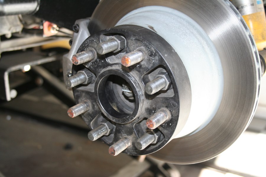

"I got some 1 1/2 inch spacers at the Parts Heaven swap meet and I think they will work out OK. I just wish I could use these spacers without using lug nuts on the spacers. Now I've got to order 10 more lug nuts. These wheels and spacers are "lug centric", soooo, I've ordered 10 more lug nuts."
You are saying both spacers are too deep for 100 studs? Wow

If I could, I would press out the lug bolts on the spacers and just use the long lugs on my rotors. If the spacer and wheel were "hub centric" maybe I could do that? Because both are "lug centric" I'm not sure I can. I am also told that with a spacer that wide, I should use the lugs on the spacers.

Thats what I did, pressed out the studs on the spacer then just slid it over the 100mm studs. Mine are hubcentric.

Still trying to decide what to do with this spacer. It kind of looks like a truck wheel. (IMG:style_emoticons/default/laugh.gif) When I removed the wheel today, I noticed that the spacer to the wheel is "hub centric", which means to me, the spacer almost becomes part of the wheel. What I'm getting at is even though the spacer is 1 1/2" wide, I'm thinking of pressing out the studs on the spacer and just using the studs on the rotor.
