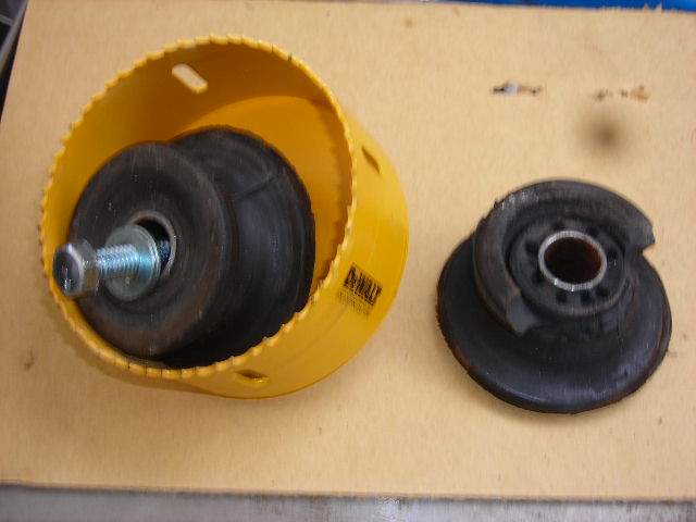

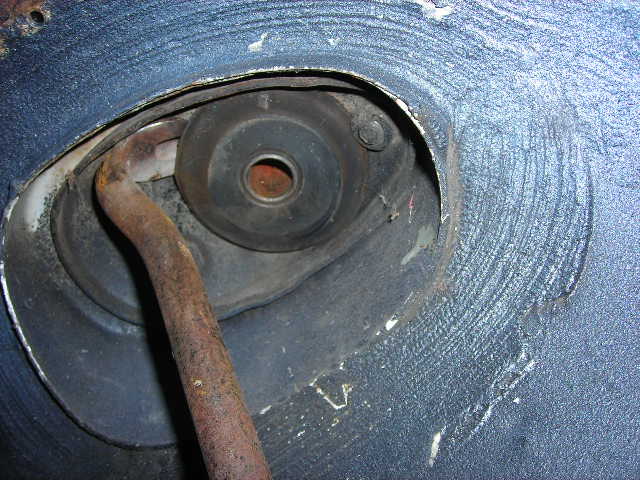

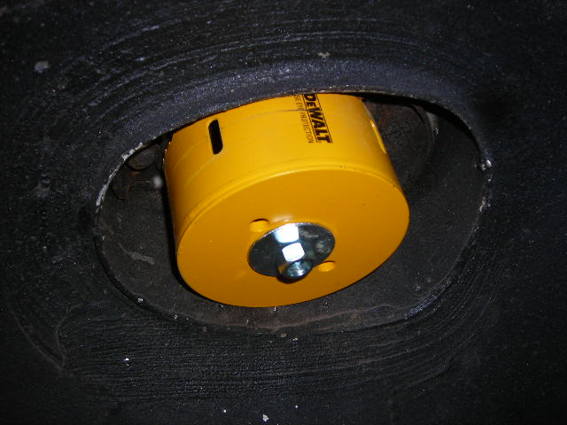

I am installing the poly two piece...
neo914-6 How do you remove the front strut top bushing? Sep 12 2007, 12:09 PM
Joe Ricard Press
or
torch Sep 12 2007, 12:22 PM
drgchapman Burn it out with a torch, just like the A arm bush... Sep 12 2007, 12:30 PM
RoninEclipse2G propane torch and a decent mask so you're not ... Sep 12 2007, 12:37 PM
neo914-6 tried propane but couldn't stand the smell / f... Sep 13 2007, 10:20 AM
McMark Cool! :thumbsup: Sep 13 2007, 10:23 AM

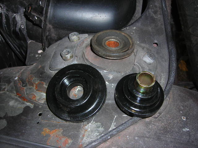

Blood red 914-6gt So how do the new ones look when they are in, and ... Sep 13 2007, 10:49 AM
neo914-6
So how do the new ones look when they are in, and... Sep 13 2007, 03:23 PM

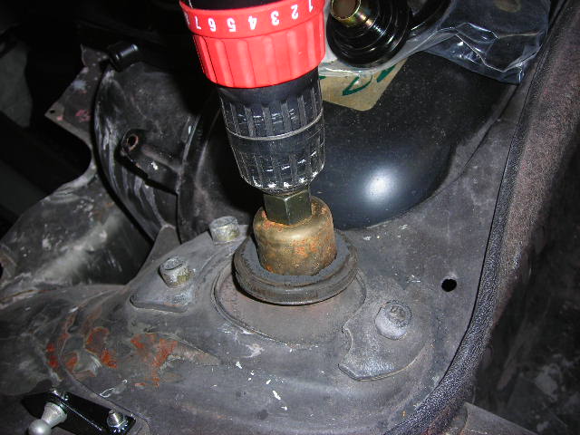

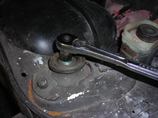

purple I have a question...how do you get the nut off th... Sep 13 2007, 05:24 PM
neo914-6
I have a question...how do you get the nut off t... Sep 14 2007, 08:35 AM
purple
I have a question...how do you get the nut off ... Sep 14 2007, 10:39 AM![]() ![]() |
