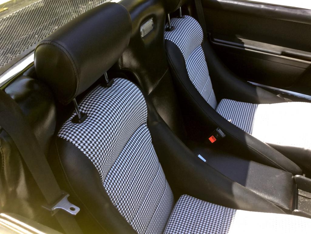

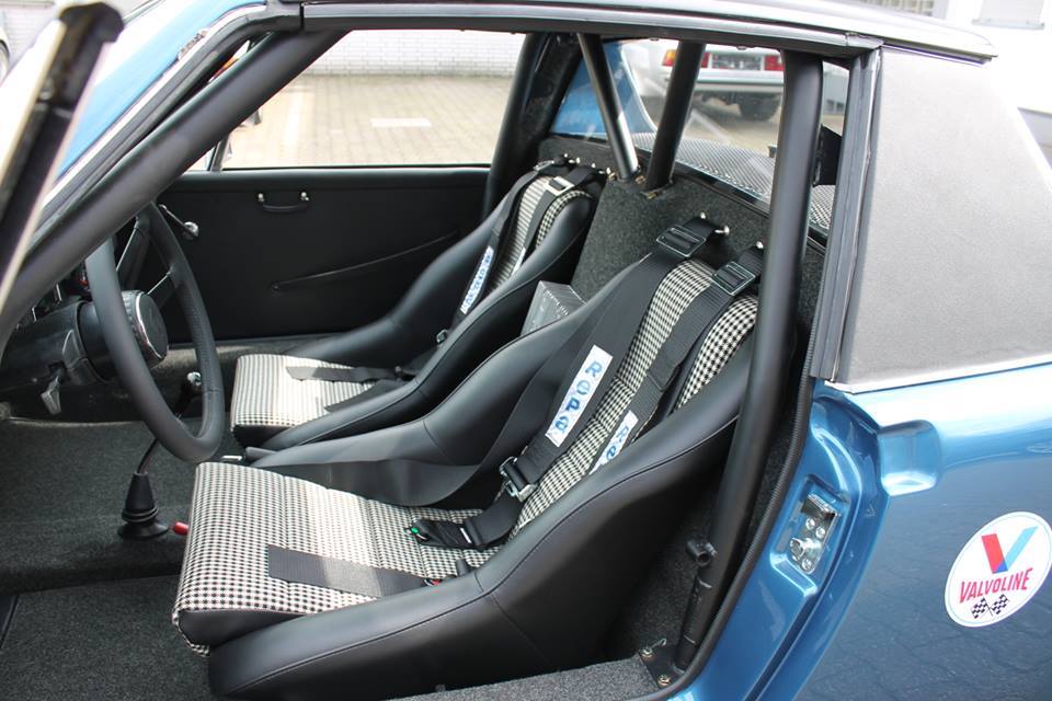

I sort of hate to say it but I’m putting mine in to decide how well I like them. Later possibly recovering using the Pepita design for the seat and back. This photo is of the seats I’m replacing and that’s the look I like although houndstooth. I also feel the seat should be kept as original, mixed emotions!Attached Image

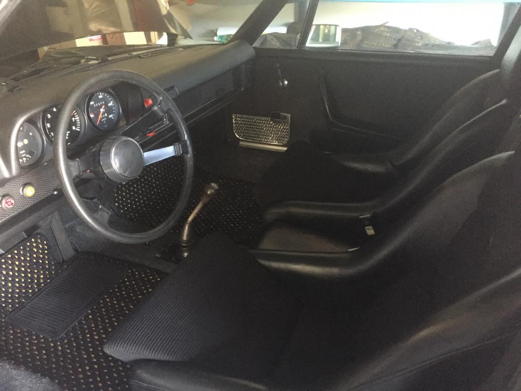

The ones I showed are the italian D'eser brand seats, http://www.deser.it/
I've been in conversation with them and asked about fitment in a 914 and they sent me the above picture. Doesnt show the belt situation tho as those four points doesnt seem to have anywhere to connect too down at the hips.

Hot setup might be the "corduroy" from the seat centers in the current 911 GT3 Touring. Really (!) nice and probably a lot more durable. If it's anything like the current Houndstooth, which is very cool also, there will be two different thicknesses for the seat cushion and the seat back. No, really.... (IMG:style_emoticons/default/shades.gif)

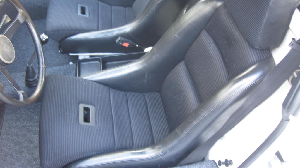

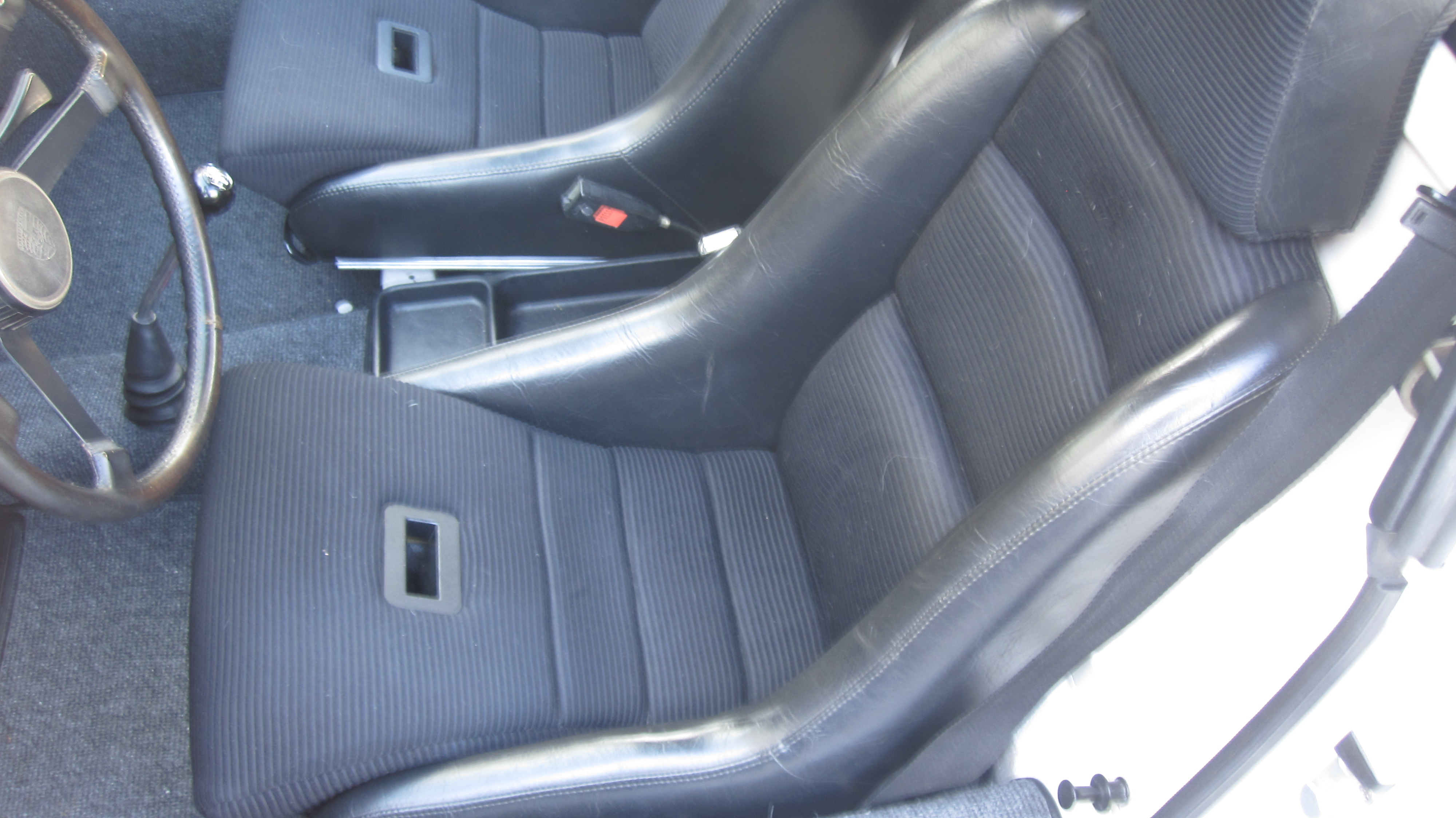

QUOTE(rgalla9146 @ Jan 27 2019, 08:51 PM) *
I have a pair of Sheel/Mann seats.
AFAIK the rails are standard 914 parts.
One of my seats slides easily. The other does not.
I believe care must be taken that the rails are both parallel and on the same plane.
I'll know better in a few days.
Update on Scheel corduroy inserts.
I've had these Scheel Mann seats for many years.
I was very disappointed with their appearance when it came time to install them.
I took them to a upholstery shop my wife had used for a pair of chairs.
They said the original material was very sturdy and could be re-stretched nicely.
I'm very happy with the results.
Check the 'before' shots in post # 4
Now for the Scheel/Mann logo emblems.
