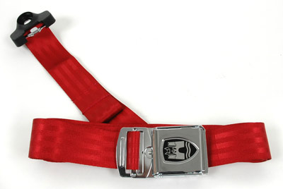

I experienced this firewall recess issue on my 70 car and have yet to chagne them. I'm probably going to replace them with stuff from this place:
http://wescoperformance.stores.yahoo.net/seatbelts.html

I ordered a set of these belts today so I'll post here whn I get them installed. Theya re supposed to be here within a day or two, so this weekend I'll try to get them installed.
-Tony

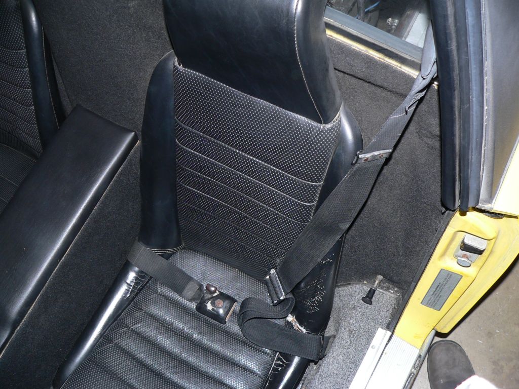

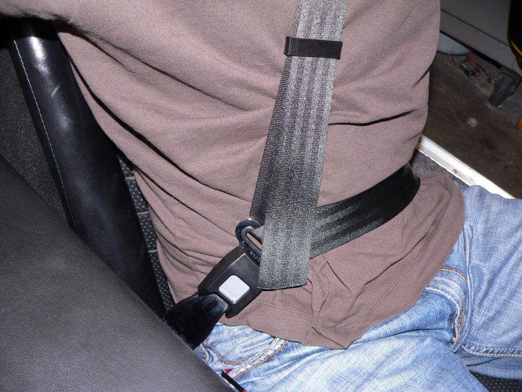

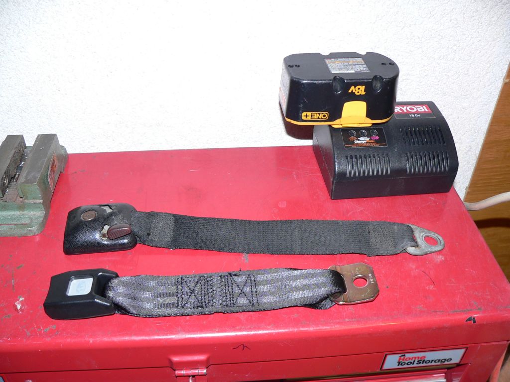

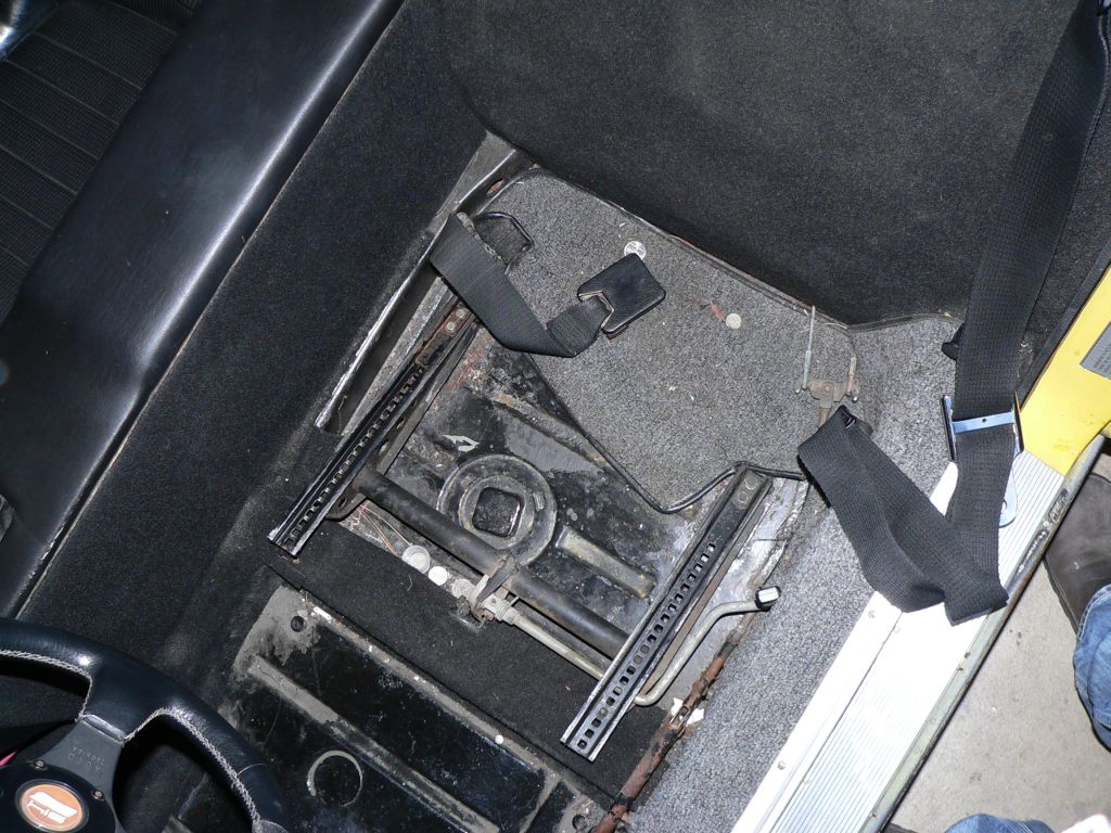

As promied, pictures of the seatbelt installation. These aer seatbelts from Wesco Performance.
A couple notes:
1. The shoulder bolts ued in the 914 are larger than the holes on the new seatbelts. The good news is that the thread is the same for the new hardware, so if you don't need shoulder bolts for the lap belt, you can do what I did and use the new hardware that comes with the seatbelts.
2. Make sure and retain the thick washers used in the OEM seat belt installation. There needs to be some space between the seatbelt mounting plates and the body of the car.
3. If you retain the OEM hardware and enlarge the holes, you can retain the plastic cover that goes over the shoulder strap bolt up by your shoulder. I didn't care, but it might be a good measure of safety to not have an exposed bolt where your head may be flying around in an accident. I will probably do something to change that...
