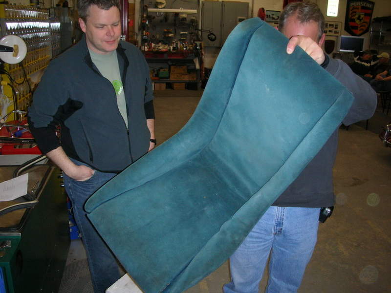

Since I'm not completely pleased with my Sheel seat, I'm always looking for alternatives. I found this picture of a 904 seat. Almost looks like a modified 914 seat doesn't it? It looks comfortable. Anyone have a Speedster bucket seat in theirs? Thoughts?

They are comfortable IMO. Very similar to speedster seats. Try www.fibersteel.com/OldSite/Seats.htm

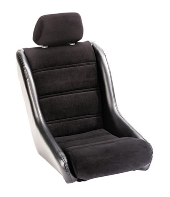

Corbeau classic 2 is another nice one that is similar to the 904 and 914 GT seat. Lot cheaper too (IMG:style_emoticons/default/shades.gif) Probably won't fit into the backpad though (IMG:style_emoticons/default/sad.gif)

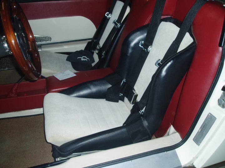

Look at this seat. It's a reproduction 550 seat. I bet you could modify a 914 seat to look very similar.....

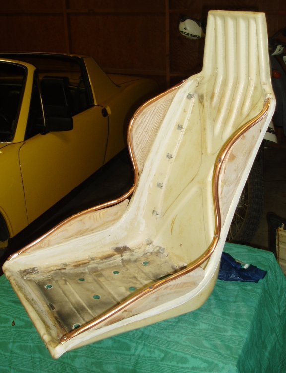

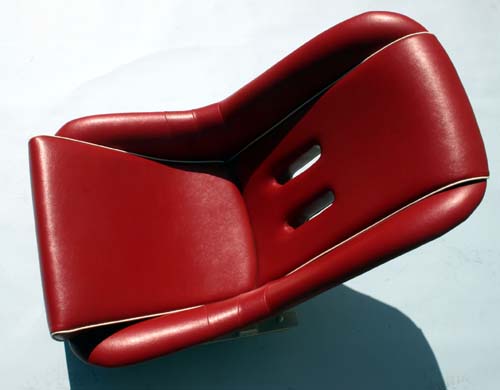

Here's mine after I re-worked them. I used copper pipe for the frame then cut 3/4" plywood to fill the gap between the pipe and the stock seat then glassed over the whole thing.
Here's the before shot;
Here it is in the car. I cut off the headrest to emulate the 356 seats. My headrest is now attached to my harness bar.

Very nice work. Looks like you used 1/2 inch soft copper for the framework ? After you glassed it all in are the side extension pieces stiff enough to handle getting in and out of the car ? I may have to " borrow " your idea.

Had two in my last "teener." Will not fit into the backpad but are otherwise comfortable and a reasonable price.

...............just a note of intrest, the original 550 seats were made in aluminum.,and were slightly smaller and narrower than a speedster seat., the reproduction 550,s I have driven were UNCOMFORTABLE as hell...the seats are too narrow., a speedster seat(they were made in steel,lots of nice breathing holes, without any padding is what I used for years. a padded speedster seat is also UNCOMFORTABLE it,s also too narrow....The 914 OEM seat is just right....MM
