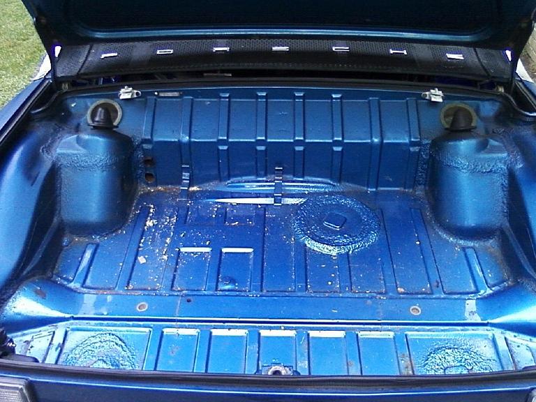

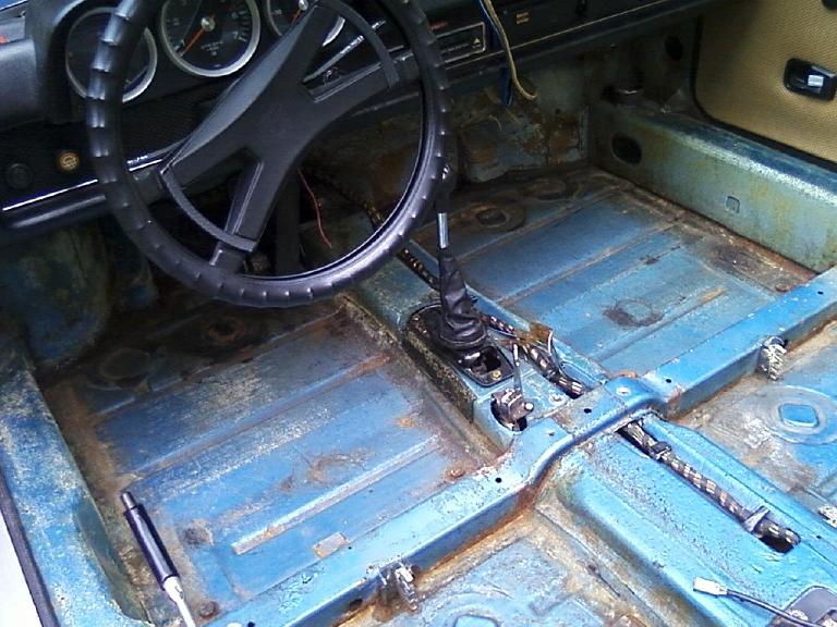

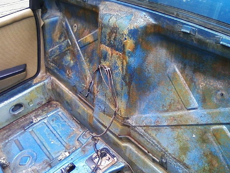

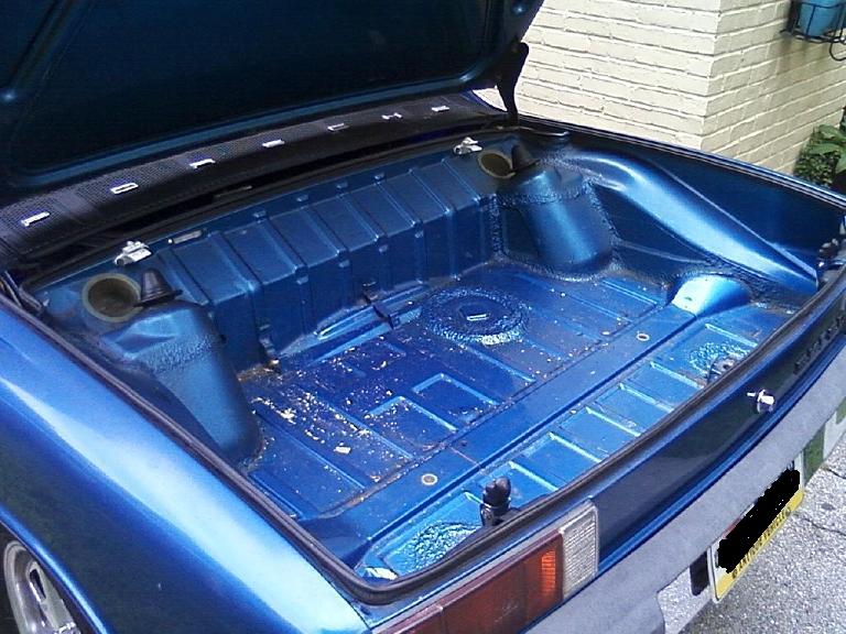

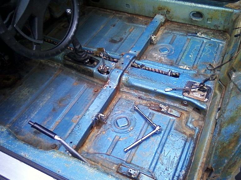

I didnt get very far, but i started yesterday. I got the seats out, center console, carpets, backpad, and the rear trunk as much as i could remove in 2 hours. It dosnt look pretty, but i am not done yet
I still have the front trunk to do as well as door panels and targa bar. the pedal cluster needs to come out, its a little funky because of a leaky rear window glass.
I will have to replace the rear glass seal before anything eles. (IMG:style_emoticons/default/smash.gif)

trunk pics (IMG:style_emoticons/default/smile.gif)

IMHO you should remove the factory tar boards and be ready to do some clean up. Those things are the WORST " addition ": Porsche could have made. The areas that sit in the channels never bonded, and water creeps under there and just sits in the channels. A Mapp gas torch and a stiff putty knife gets the job done in about 2.5 hours Then solvent clean, wire brush the rusty spots and paint, then apply new deadening ONLY on the raised parts. That keeps the channels open to dry out in the future.

QUOTE(scotty b @ Aug 18 2010, 08:25 PM) *
um, where in my picture is the factory tar boards.?? and explain about the channels. i dont speak english so well thanks (IMG:style_emoticons/default/confused24.gif)

The 'tar boards' are on the floor pan and the center tunnel. Poke with a screwdriver and you'll get the picture. The 'channels' are the ridges/valleys/lines you see in the floor pan.

QUOTE(McMark @ Aug 19 2010, 10:32 AM) *
Judging from the surface rust on your floor-pans, there will be more rust under the factory tar.
The factory painted over the tar, that's why you haven't noticed it yet. But after 40 years, the tar has cracked and water has made it's way underneath eating away on your floorboards ...

Btw. the tar comes off in fairly large chunks if you heat it up with a heat gun and use a medium sized scraper ...
(IMG:style_emoticons/default/popcorn[1].gif) Andy

After tar removal:
(IMG:http://www.914world.com/bbs2/uploads/blog-1115347793.jpg)

(IMG:style_emoticons/default/smoke.gif) so what you guys are telling me is that what i think is the floor is really not the floor, its like a parrelell dimension, and if i start at it with a putty knife i will discover the truth
(IMG:style_emoticons/default/screwy.gif) whoa
thats deep
thanks for the info, now i got a bigger job (IMG:style_emoticons/default/welder.gif)

QUOTE(jsayre914 @ Aug 19 2010, 02:42 PM) *
thats deep
In looking at the pictures, it looks like the tar was previously removed and the bare floor was repainted. Tar does not rust.
