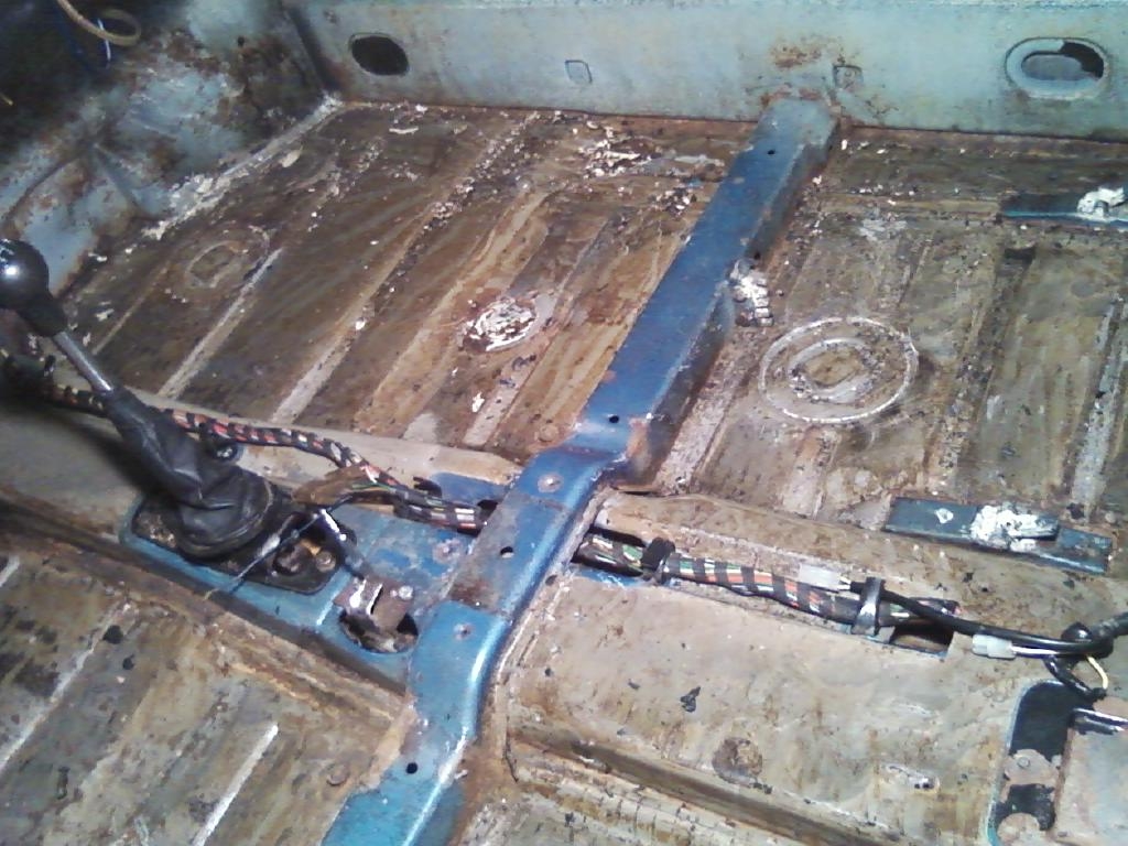

jsayre914   Tar is gone :Qarl: :Qarl: Now what is my next ...   Aug 26 2010, 10:27 AM

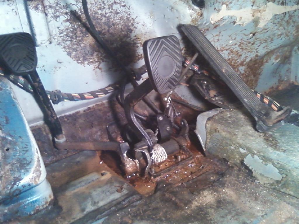

jsayre914   THE UGLY :sick:   Aug 26 2010, 10:29 AM
Vacca Rabite   The bolts that point forwards are, I think, welded...   Aug 26 2010, 10:52 AM
jsayre914   The bolts that point forwards are, I think, welde...   Aug 26 2010, 11:00 AM
Vacca Rabite   The bolts that point forwards are, I think, weld...   Aug 26 2010, 11:40 AM

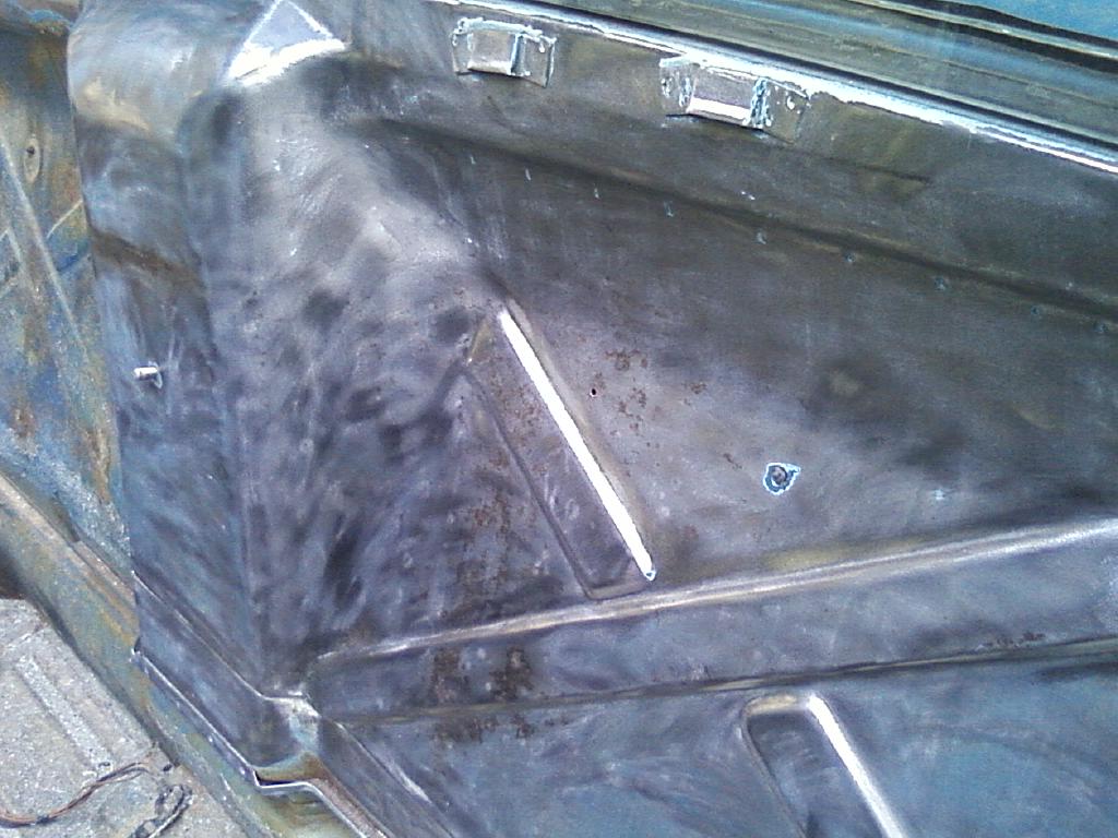

jsayre914   never enough time to work on the car <_< bu...   Sep 4 2010, 12:30 PM
realred914   ditch that POR 15 crap and invest in some good aut...   Sep 4 2010, 12:48 PM
Vacca Rabite   If you want to get the epoxy, they sell the Nason ...   Sep 4 2010, 04:34 PM
jsayre914   dont be mad guys, i already got the por-15 crap. i...   Sep 4 2010, 06:38 PM
charliew   The only way you will like the por15 with a top co...   Sep 6 2010, 03:01 PM
jsayre914   The only way you will like the por15 with a top c...   Sep 6 2010, 03:43 PM
Vacca Rabite   No, you don't. You an POR15 it and just put t...   Sep 6 2010, 06:23 PM

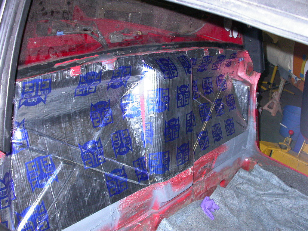

jsayre914   Some work on the project yesterday :D   Oct 10 2010, 03:29 PM
jsayre914   and one picture for scotty. See, i do listen to yo...   Oct 10 2010, 03:31 PM

SirAndy   I've been thinking about using a different app...   Oct 10 2010, 05:48 PM
Prospectfarms   I've been thinking about using a different ap...   Nov 1 2011, 08:19 AM
scotty b   You could have saved yourself so much time, aggrav...   Oct 10 2010, 05:54 PM
