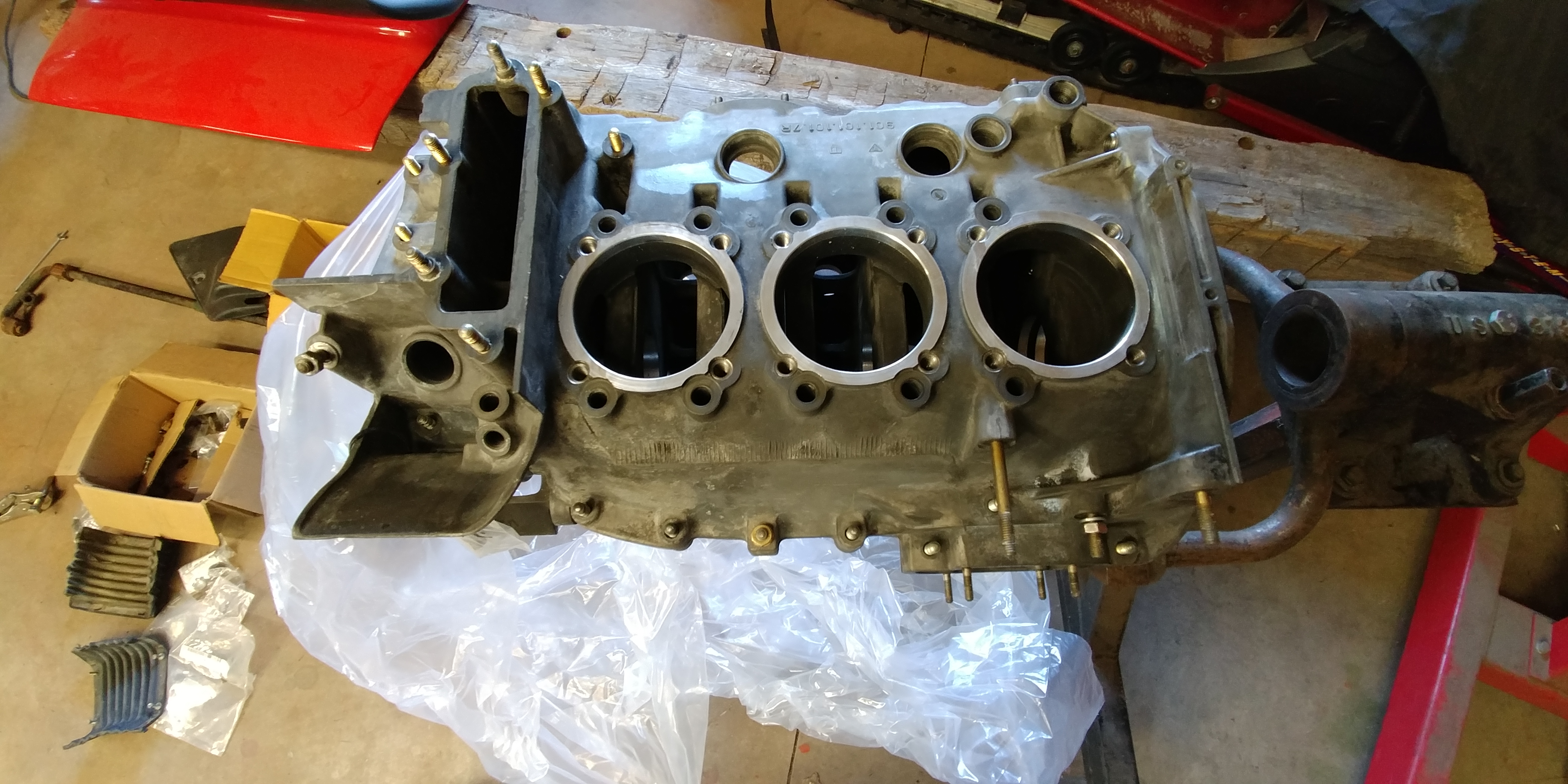

Optimusglen   Case split, nothing scary! http://www.914worl...   Jul 15 2017, 07:49 PM
bretth   Case split, nothing scary! Nothing scary bu...   Jul 15 2017, 10:55 PM
Optimusglen   Case split, nothing scary! Nothing scary b...   Jul 16 2017, 05:33 AM
mb911   Case split, nothing scary! Nothing scary b...   Jul 16 2017, 08:17 AM
mepstein   Case split, nothing scary! Nothing scary b...   Jul 18 2017, 01:32 PM
