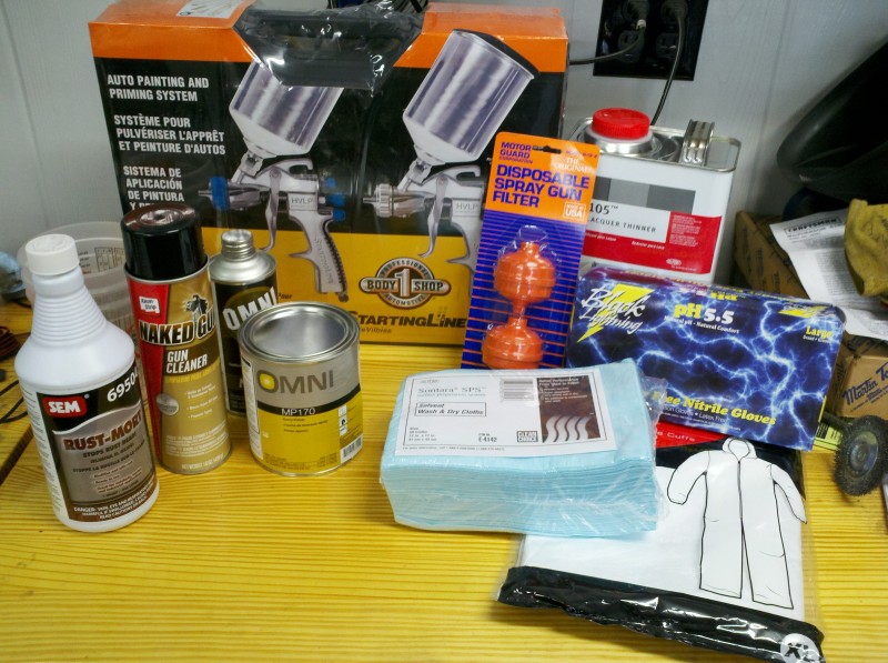

9fourteen
post Jun 1 2012, 07:03 PM
Posts: 42
Joined: 20-November 06
From: Cincinnati, OH
Member No.: 7,239
Here is what I ended up buying
I went with what the guys at the paint store suggested. I was leaning a little more towards the affordable starting out. May not be the top of the line primer and spray gun but should be ok for a beginner like me working out of my garage. It will at least get me started. Just waiting on my fresh air respirator and then have to makes some mods to my compressor setup to filter out the moisture better for blasting and painting. Hope to be ready to blast and paint in a couple weeks.
