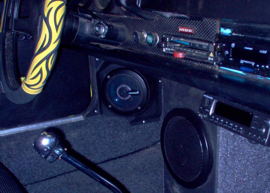

Hello All,
I just got a set of those cool aftermarket speakers that replace the originals. I must say, WOW! The improvement is really good while I don't think it takes up any more space really. They go in really well and are out of the way. I don't notice any difference when I get in and out of the car. ANd the sound is so much better.
Take a look:
(IMG:http://www.rockaria.com/landt930/914/914speaker1.jpg)(IMG:http://www.rockaria.com/landt930/914/914speaker2.jpg)
(IMG:http://www.rockaria.com/landt930/914/914speaker3.jpg)(IMG:http://www.rockaria.com/landt930/914/914speaker4.jpg)
(IMG:http://www.rockaria.com/landt930/914/914speaker5.jpg)(IMG:http://www.rockaria.com/landt930/914/914speaker7.jpg)
COOL!

A few people wanted to know the backspacing to fit speakers. I measured on these and it is 2" stock. 2.5-3" if you crush the heater tube a bit, and about 4 or so without a heater tube. As well the heater tub is towards the side so its possible to get more with a flattened tube a bit.
I hope this helps
