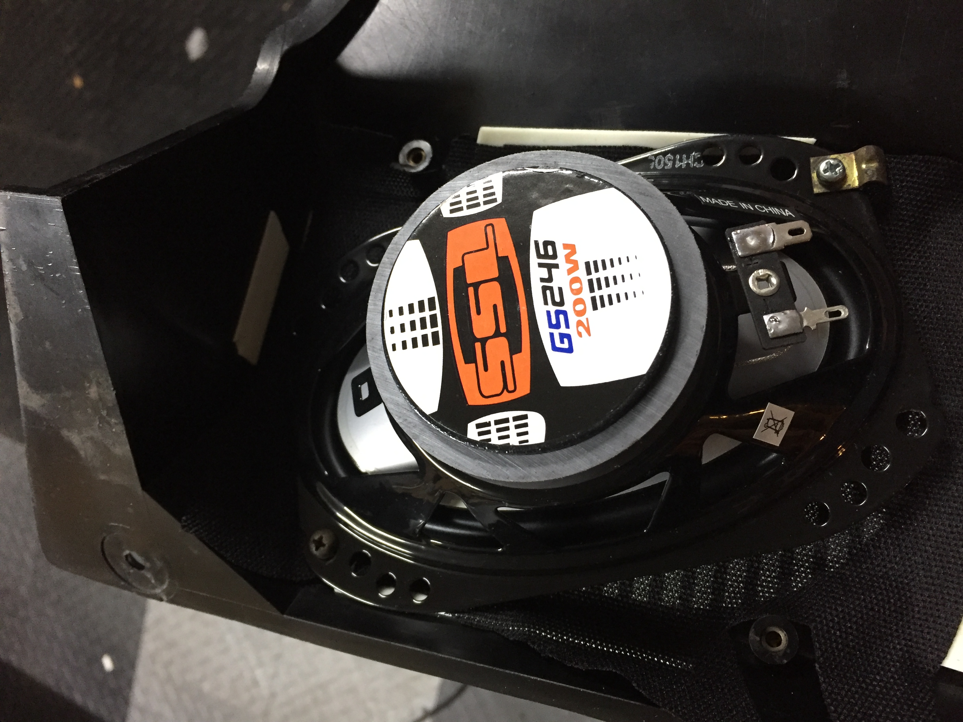

I looked at the AA item and did a bit of googling and it turns out that AA is selling the Sound Storm Laboratories GS246 Gs Series 4X6" 2-Way Speaker 200W. It's available on eBay and Amazon.
I still wonder if it will fit in the factory pods.
Orbit398, if you do get them, please let the community know if they fit. Thanks.

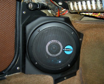

I have AP f/glass ones and 6.5'' blaupunkts,don't think it would be too easy to get a 7'' in them,depends how much larger the housing is than the cone,some makes can vary in that size.

I have them in my car. They fit, but you have to install them at an angle.

What speakers do you have in the PIC?
So where do you think the 914rubber pods go? They replace the brittle, funky shaped Factory enclosures.

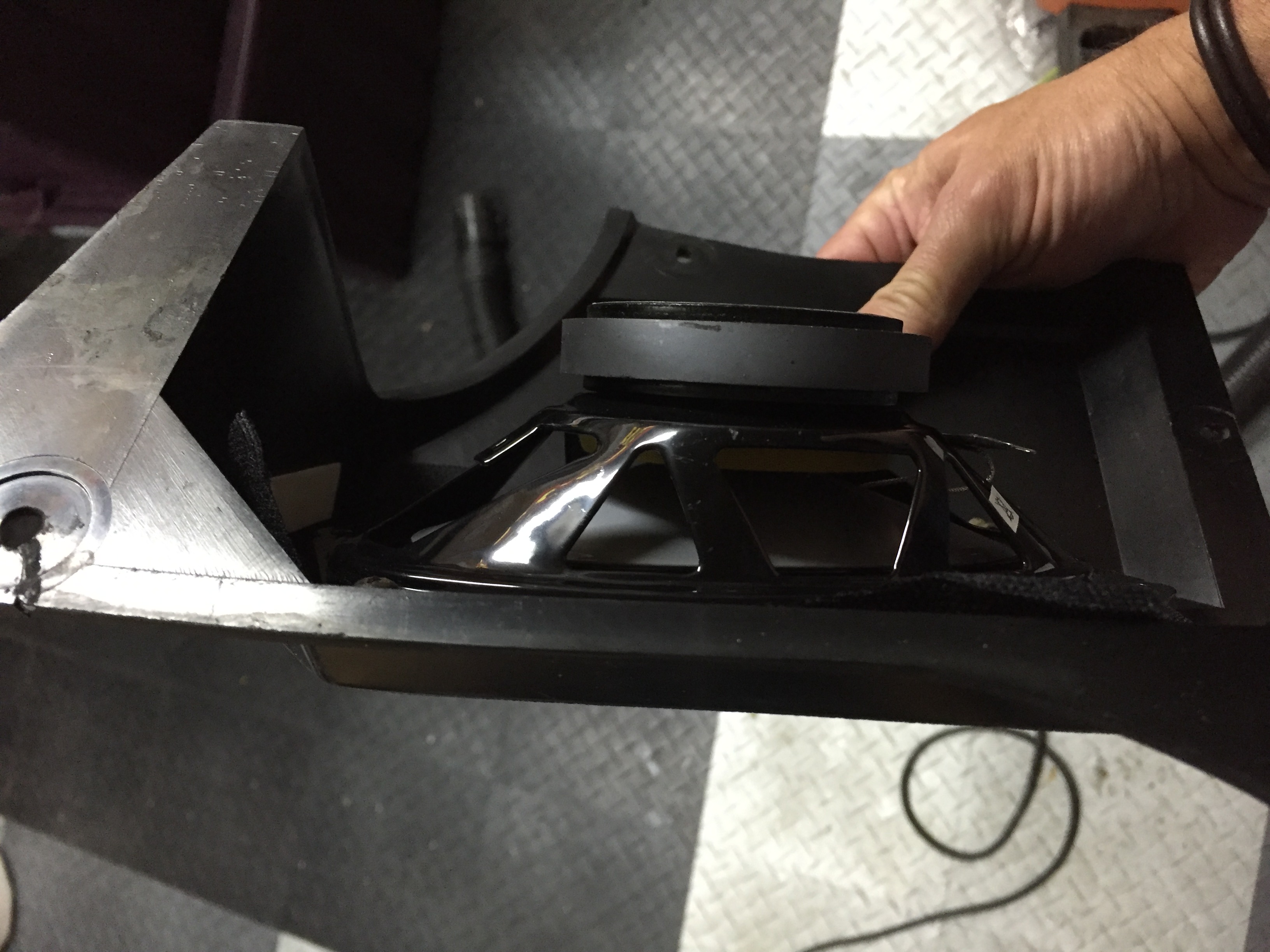

I bought the same ones AA shows on Amazon. Link below. Make sure you order the 4 x 6 ones. Fit perfectly. They install at a 20 degree or so angle and fit two screw holes...enough to secure them to the original grilles.
http://www.amazon.com/GS246-200-watt-auto-...i_detailpages00
iankarr
post May 5 2016, 03:59 AM
Posts: 2,609
Joined: 22-May 15
From: Heber City, UT
Member No.: 18,749
Here are some pics of those speakers
