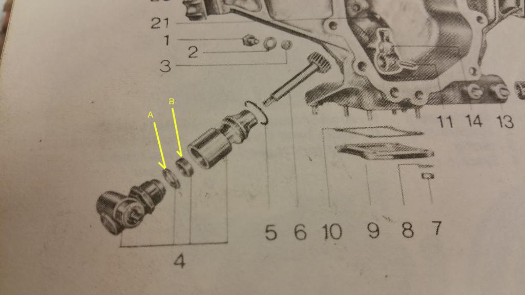

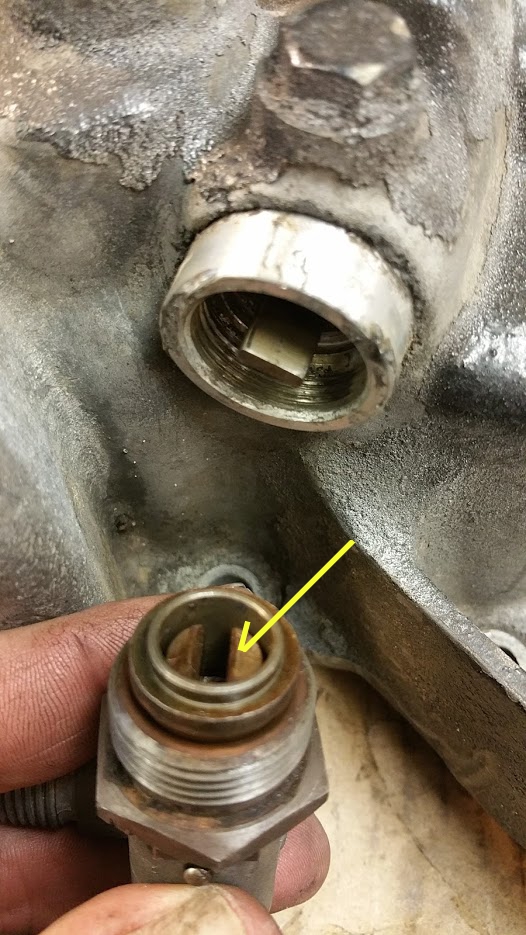

I'm having trouble getting this guy installed. It goes in fine, then when I tighten it up the shaft tightens up and won't turn (I'm turning the small gear inside the end of the tail cone) I did some careful measuring and I think the end of the slotted member in the angle drive is pressing against the shoulder of the paddle inside the tail cone piece. When testing the rotation of the angle drive itself I press down lightly on the arrowed surface and the drive won't turn, so I know it doesn't take much pressure here to prevent (what I assume are) the miter gears from turning.
The Haynes manual shows a whole grouping of parts as one number (frustrating!) Anybody know what A and B are? I'm thinking B is the seal, but what is A? I think a washer in here somewhere would provide a bit of clearance so things can move properly. Any ideas? ![]() |

mobymutt I installed mine as one piece, per the manual.
Pe... Apr 10 2016, 06:24 PM
Mikey914 We provide with the double seal housing. We do not... Apr 10 2016, 11:47 PM
Darren C Both parts available from Porsche main dealers and... Apr 11 2016, 05:39 AM
Mikey914
Both parts available from Porsche main dealers an... Apr 11 2016, 12:45 PM
Jameel Thanks! You guys helped me figure it out. Yest... Apr 11 2016, 07:07 AM
Dave_Darling Yes, for something with "PORSCHE" on the... Apr 11 2016, 09:08 PM
Darren C $7 & $10 is VERY cheap for genuine P... Apr 12 2016, 12:26 AM
Mikey914 Actually, they do seal the internal, but most of t... Apr 12 2016, 12:41 AM
porschetub
Actually, they do seal the internal, but most of ... Apr 12 2016, 01:40 AM
Mikey914 The internal drive or the entire unit?
I assume th... Apr 12 2016, 01:59 AM![]() ![]() |
