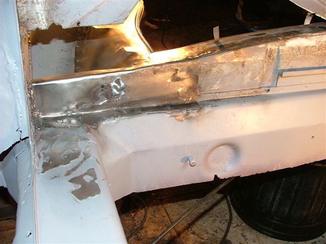

Fixing the driver side footwell and long. It is missing the front of the inner fender
and most of the end of the long.
Made a hammer form to make a replacement for the curved part at the bottom
of the inner fender. I used the same form on the passenger side by routing a
curve into both sides of the form. The form is made from scrap hardwood that
was cut to match the shape of the curve of the fender. I screwed the metal piece
to the form in three places to hold it while hammering it into shape. I welded a
strip to the bottom to form the pinch weld with the bottom of the floor and with the
end of the long. It got a little toasted during the welding, but it kept the new
piece in the right shape until the welding cooled.
Hammer formed part welded to the inner fender.
Hammer form held up to the part it was used to make. The new metal piece
was hammered around the bottom lip of the form. The passenger side was
fixed using a piece hammered around the top of the form.

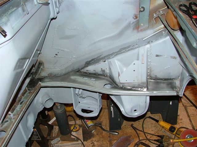

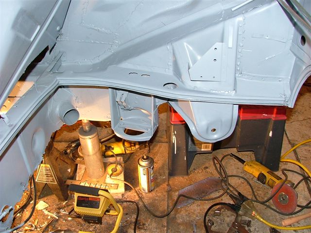

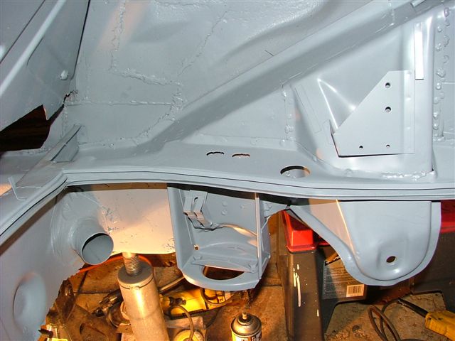

Welded on a patch to the lower part of the passenger side firewall.
Replaced the passenger suspension console. I found it to be a pain to get
the old one off. There was some kind of reinforcing plate welded between the
inner and outer rear suspension consoles, is this normal?
I also welded on the pristine motor mount sent to me by McMark.
Last, I welded on a new engine tray. I should have taken more
intermediate pictures. (IMG:style_emoticons/default/smile.gif) (IMG:style_emoticons/default/smile.gif)
Now my engine bay is starting to look somewhat decent on this side.
