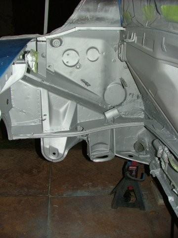

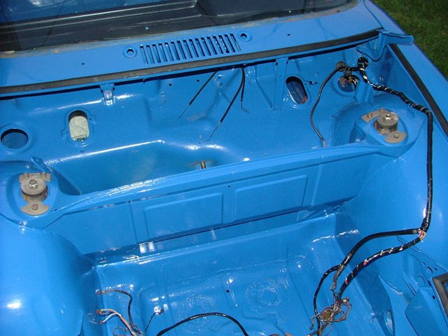

I painted my engine bay with eastwood silver rust encapsulator. I like the
way it looks and may just leave it this way. I could also paint it body color,
what do people think? I still have to paint the inside of the sail panels.

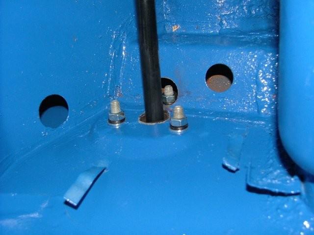

I also thought I would show the lazy SOB way to mount your front anti sway
bar. To get access to the lowest bolt on the bushing retainer, you have to cut
away a little piece of the inside of the gas tank area. Most people cut a slot
so that the backup nut plate can fit down to the lowest bolt. Because I welded
a large reinforcing plate to the outside of the fender well I was just using washers
and nuts on the inside. I already had my 1 inch hole saw out to cut the holes
for the anti roll bar itself, so I used it to cut a hole to access the lowest nut.
Very easy.

I did not know that, Lou, thanks for telling me. I guess it will get Adriatic Blue
like the rest of the car. I have noticed that the silver rust encapsulator is pretty
easy to mark if you scrape a piece of metal over it.

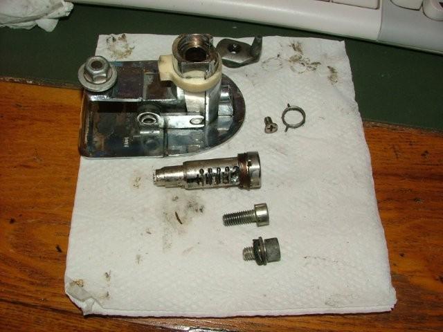

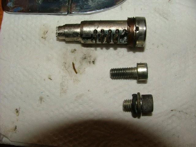

How to ruin a door lock cylinder PO stye:
Was working on rekeying all my locks, so I took the door cylinder out.
Hmm, no wonder this door handle was screwed up.
The PO used a bolt that was too long and it dug a hole in the cylinder. Somewhere
along the way all the wafers for the tumblers got bent over. The long bolt was
screwed in there tight. The shorter bolt is the correct length (I believe).
Fortunately, I have a whole set of new cylinders I got from MarkB, so I just
replaced the damaged cylinder.

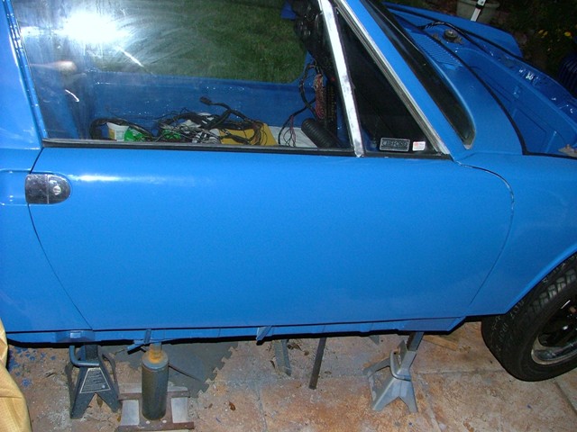

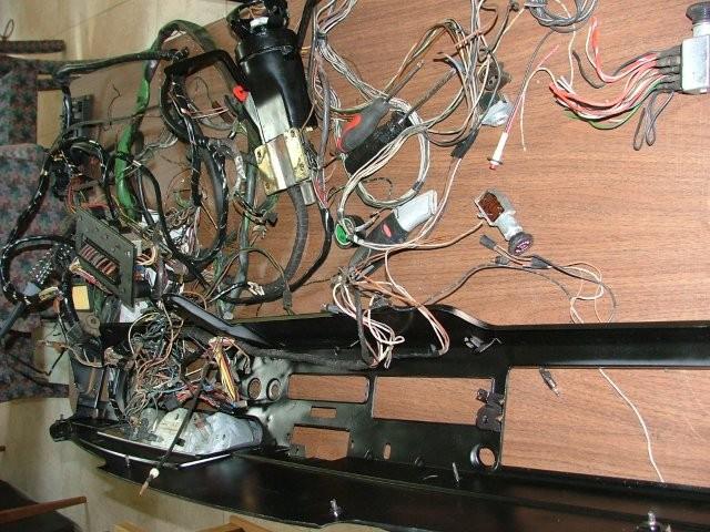

I've been working on reassembling the car. I got the passenger door put back
together and on the car. The glass actually fits pretty well when the window is
rolled up. The targa top also fits easily so I think the windshield frame to targa
bar gap is ok. Maybe the door gap issue is just sheet metal and not warped
car... (fingers crossed smiley).

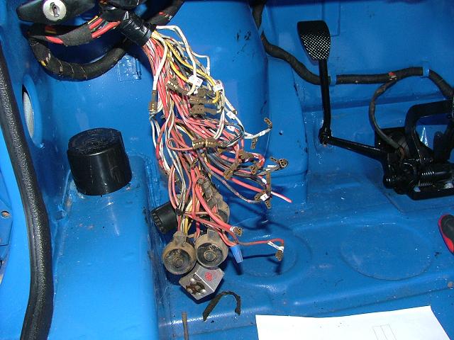

I am working on the wiring harness. I unwrapped and cleaned it section by
section using electrical parts cleaner (spray can). I rewrapped it with PVC
electrical tape. I know this is not standard, but I hope it lasts better than the
cloth tape, that was rotting and falling apart.

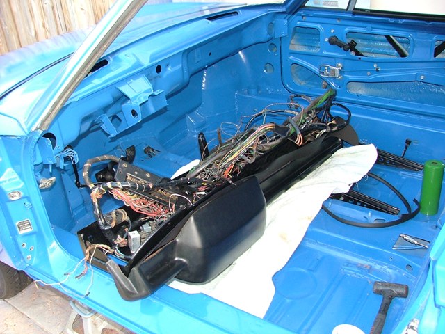

I am going to try assembling the dash, switches, guages, heater controls and
make all the wiring harness connections off the car and then put the whole
thing in as one unit. This would be easier than making all the connections
lying on the floor of the car and reaching up under the dash. Not sure this
will work, but if it does it will be much easier and I can do it inside with AC.
Here is my neatly organized dash project.

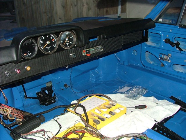

Passenger door glass looks like it will seal ok once I get all the new rubber put
on. Maybe the narrow door gap is just sheet metal related. :wishful thinking smiley:
Got my dash set up based on advice from the world members.
Dash installed, windshield not glued in yet, nor is dash to windshield seal.
It looks freaking cool to have a dash and instruments.
It took me a long time to get here because the wiring harness had me intimidated
for a while. I hope I wired the switches and instruments right. Not even sure the
instruments or relays work. Debugging this should be real fun.

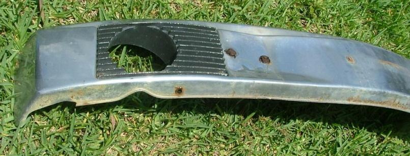

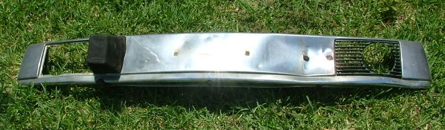

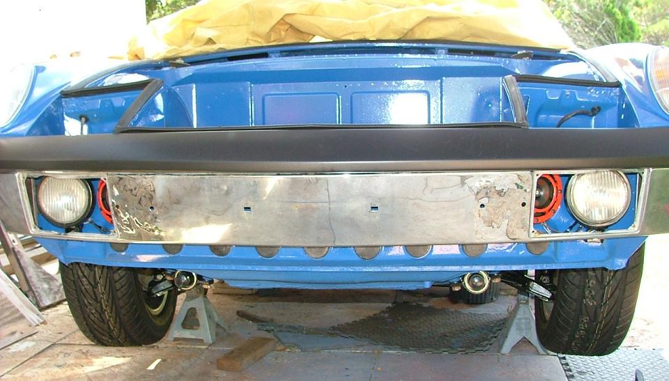

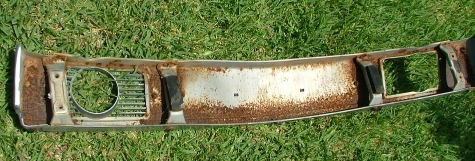

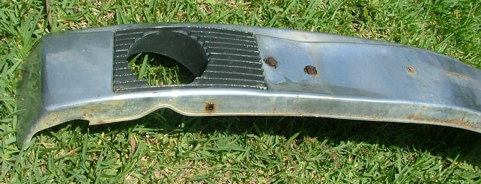

Show us your tit!
At least it has a nice, flaky fog light cover.
A pretty rusty back.
Some serious BFH work was required. Cut off all the old bolts. Derusted and
painted the inside.
It looks pretty scruffy but is passable for a hot rod. I am too over budget at this
point to rechrome it. I just want to get it running, and then I can tweak it more.
John

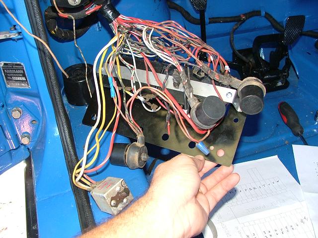

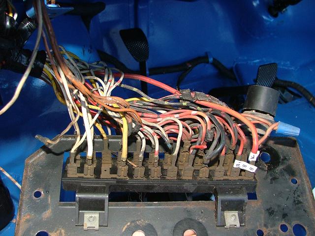

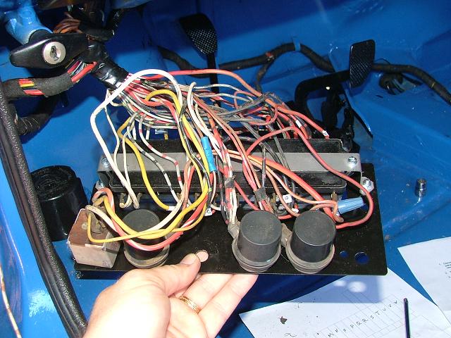

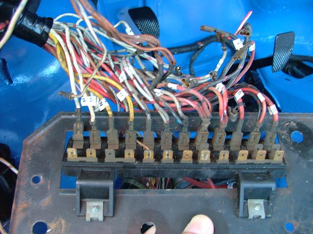

Putting in the Engman fuse panel. This is a really nicely made piece and it is pretty
easy to put in. It took less than an hour altogether. All the wiring issue threads
convinced me this was a must have upgrade. First push the relays off the board.
Then label the first row of wires with the provided stickers.
Pulled off the first row of wires and labeled the second row. The key is to work
carefully and systematically, but it really is not hard. You can tell which way
the boards go from looking at which terminals are double and which are single.
Notice the first two on the right have two sets of terminals. None of my second
set of terminals had anything plugged in to it, I wonder if these are for options?
Pull off the second row of wires.

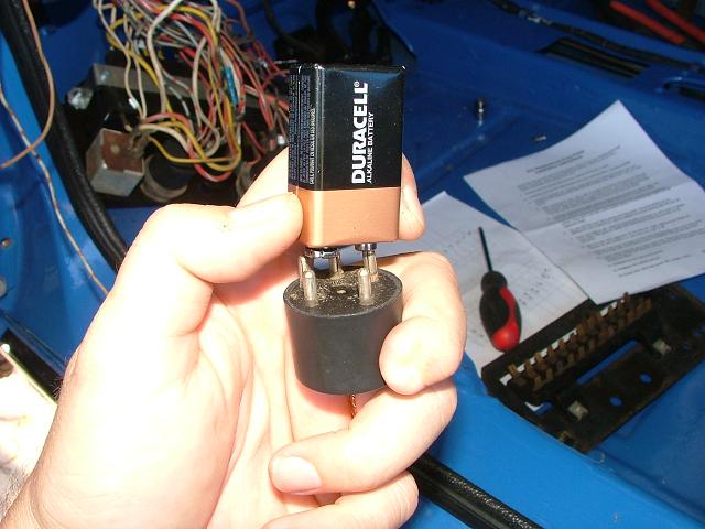

Tested each relay while I had them handy. Touching the terminals with a 9v
battery you should here a clicking sound. The two terminals in question are
those closest to the pin that is by itself. This does not guarantee the relay will
work, but if it does not click, then the relay is bad.
Start putting on the second row of wires first.
To get the first row of wires on I had to untangle and reroute some of the wires.
I had to untangle the relay wires as well. At first it looked like they would not
all reach but with a little fiddling around you see there is more than enough wire
length. Just one relay left to put in.
Put the panel in place. It looks backwards and maybe it is, but it fits better this
way with how I installed my wiring harness. (IMG:style_emoticons/default/biggrin.gif)
I hope to finish up the last few wiring connections around the car and put in a
battery soon.
John
