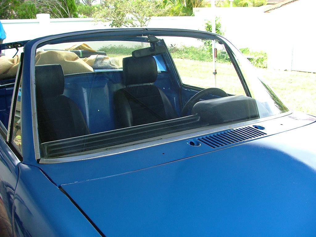

Windshield and trim in. Need to find the corner clips.
Rear windshield installation is a piece of cake compared to the front. Again, put
the butyl tape right on the inside edge of the lip so it does not squish out the sides.

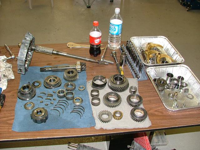

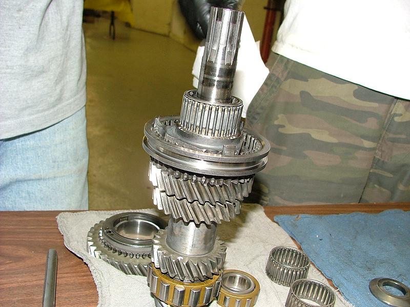

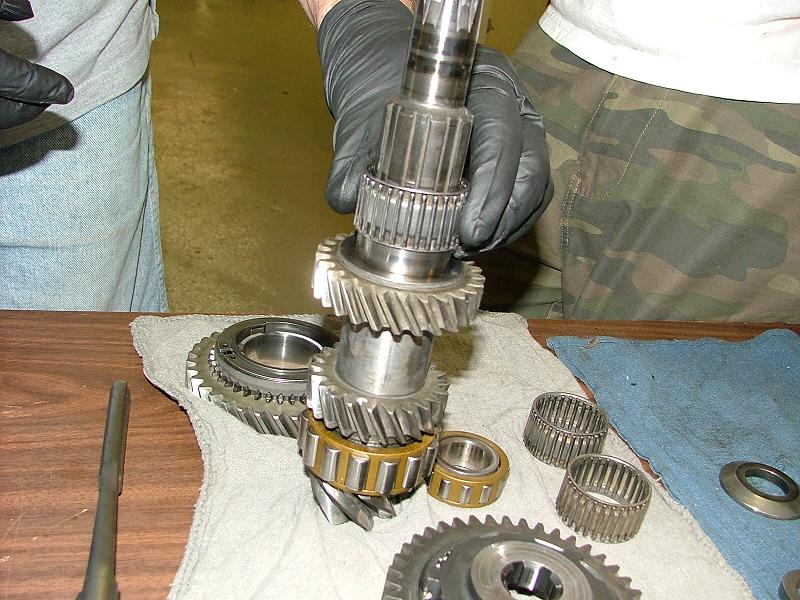

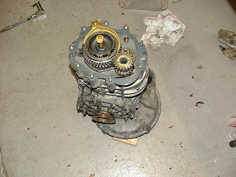

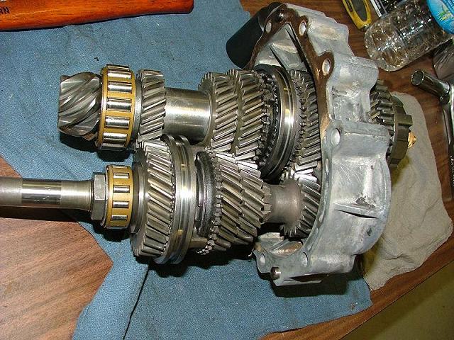

Went to the Evil Werks transmission clinic. Taking apart the 901 is surpisingly
easy, and of course, assembly is the reverse of disassembly. (IMG:style_emoticons/default/blink.gif)
Start looking for pieces that fit and slide them on.
Keep going, this looks like it might belong here.
Only a few unimportant looking parts were left over.
Nearly done, just need to add the cod piece.
Sweet. Now it just needs an engine.

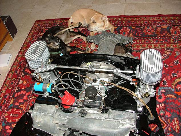

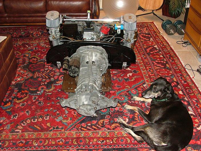

There comes a time in every restoration when your engine must find a transmission to mate with and leave the security of the living room.
Now I just need to figure out how to wire it up, set timing, synch the carbs, and
maybe attach a car to it.
John

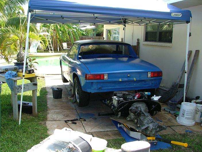

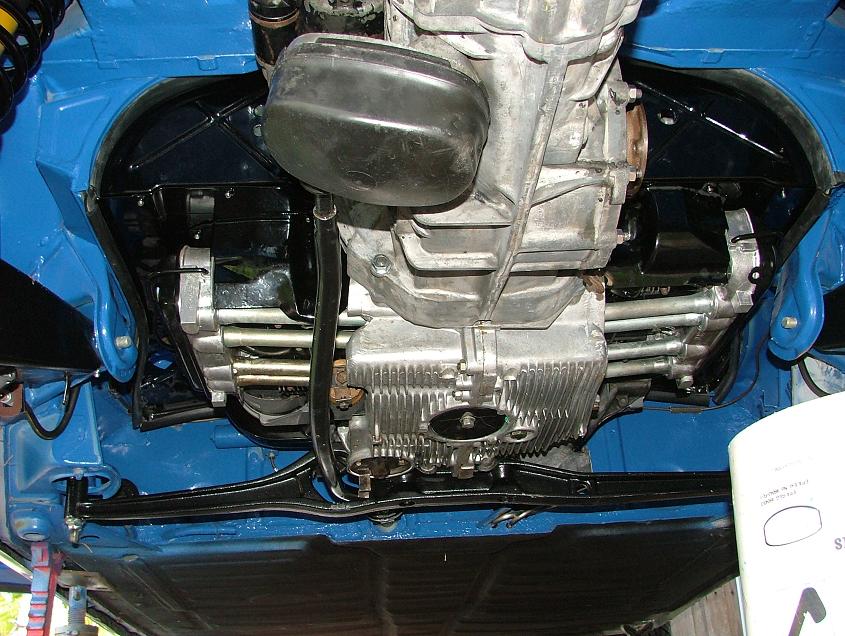

Hauling the engine out of the house.

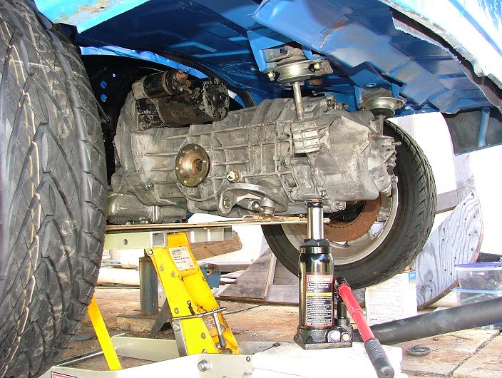

Getting ready to stuff it back in the car.
Using a motorcycle jack to lift it up.

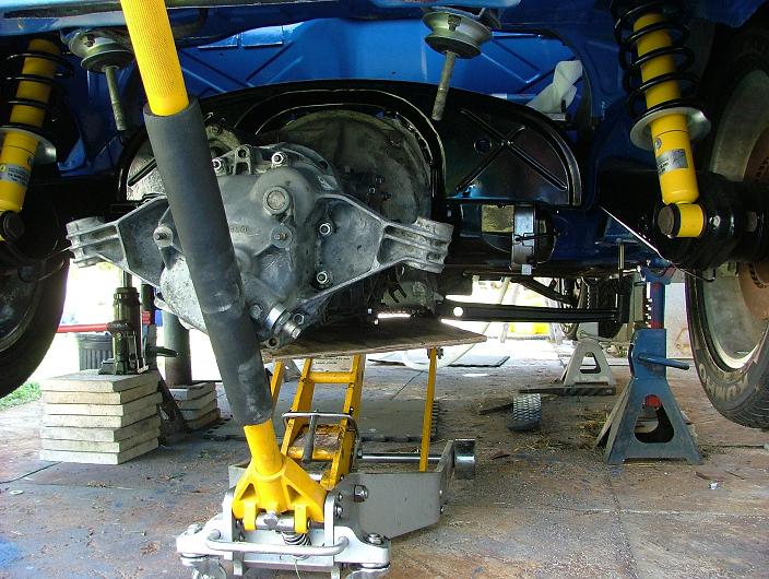

Using a second jack to lift the transmission. I ended up taking the transmission
mounts off the car and put them on the transmission. Then lifted the transmission
into place and bolted the mounts back onto the car. Because of the angle of the
mounting bolts, I could not just lift the transmission straight up.
Not sure this is the concours way to do it, but it worked for me.

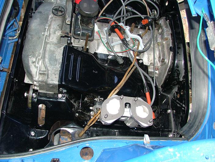

Engine is almost in there.
Engine is bolted in!!! (IMG:style_emoticons/default/piratenanner.gif) (IMG:style_emoticons/default/smilie_pokal.gif) (IMG:style_emoticons/default/piratenanner.gif)
Hooked up the shift rods and gear shift lever. Also put in all new bushings.
Still have to connect the fuel lines and the other controls. I think its time to stop
milking this restoration and gitter done.
John

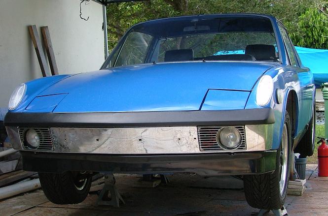

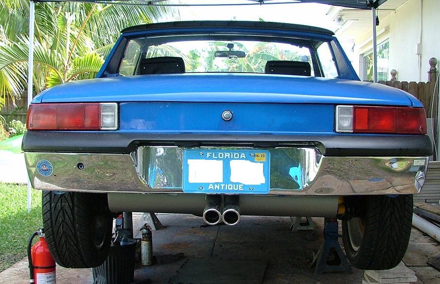

Front bumper with Auto Atlanta front fiberglass valence. This part comes with nice
gloss gel coat and fit perfectly right off the bat. George let me buy the first one
they received when I was at the transmission clinic. The back of this valence
is smoother than the front of the other fiberglass one I bought on ebay. It would
probably fit even better if my front bumper had not been dented extensively
and then straightened by me with a BFG.
Rear bumper with my new license plate! Whoo hoo! It took me about 18 months
to get a clear title and registration for this car. The DAPO lost the title and jerked
me around about it for about 12 months, then moved out of state. What a freaking
douche. I really need to go back and edit post #1 to tell the real story of this idiot
and his BS lies. I'll tell ya how I took care of the title problem sometime, it is
really not that hard, just cost about $500.
John

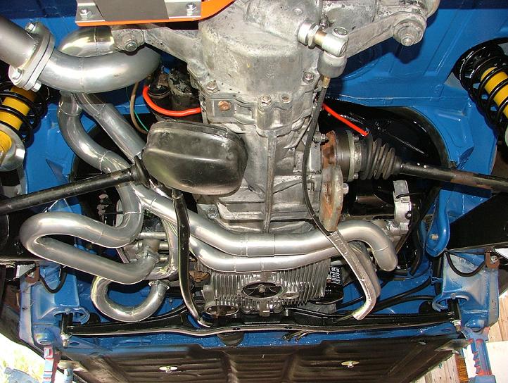

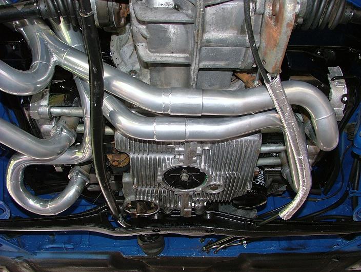

Put in the tangerine racing exhaust and headers. These parts are like a work of
art. I had them ceramic coated silver and they just look awesome.
You can see the muffler in the previous post. I wanted the twin tips and will have
to adjust my rear valence to fit them. I also put in my drive shafts. Here is a tip:
put in the drive shafts before putting in the shift rod and exhaust. I did mine in the
wrong order and had to pull them off and put them on again.
I could stare at those headers all day.
