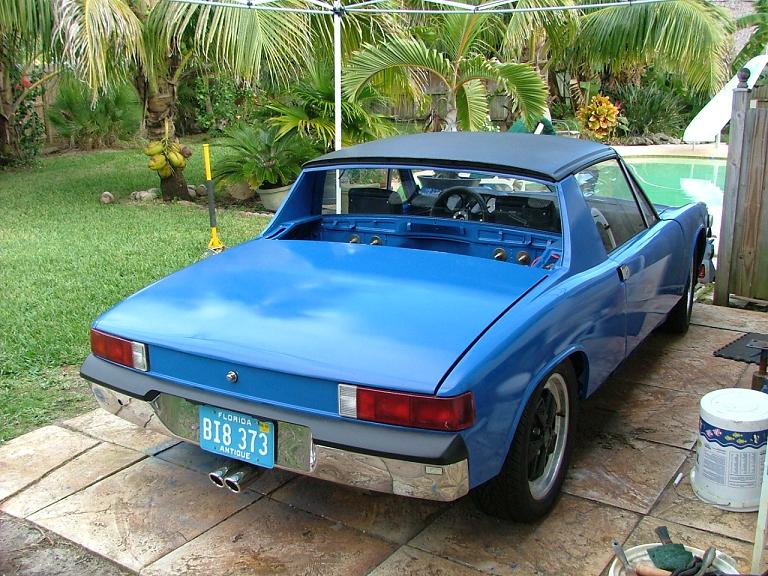

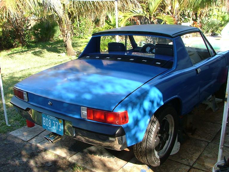

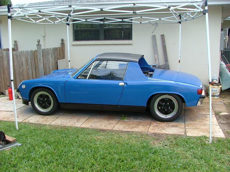

I have been busy trying to finish up a lot of little stuff and have not taken the
time to post much. First off, the car made it back to its own wheels almost
two years to the day from going on jack stands (this was back in December).
I think it looks pretty good.
I forgot about the engine cover when I originally painted the car, and now that the
engine is in it seemed like a good idea. The little side grills next to the engine
cover were the first parts I "restored" so it was cool putting them back on.
John
