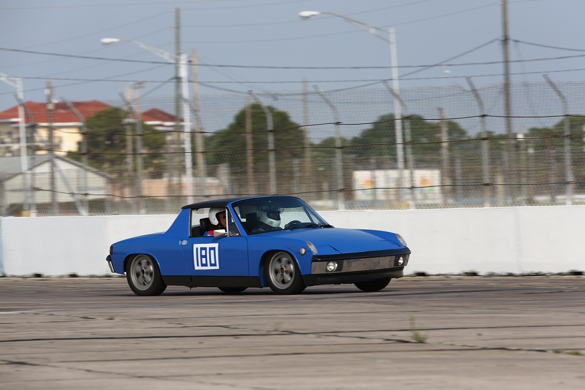

I'm going to bump this to the top for John, as we had an interesting weekend. He took his car on track for the first time at Sebring and I think he had a blast (while it was running). We battled some issues the whole weekend, most concerning was a breather tube that wouldn't stay put on the head vents. The final Saturday session John got "meatballed" for dropping oil. We realized the head vent was spewing oil all over the engine bay. I was able to get it fixed this morning with a smaller diameter hose, and John did most of the afternoon session. Unfortunately he was seeing some wicked oil temperatures, which I think means he needs to look into a good front-mounted cooler for this car. The Raby engine is so big and bad, it just completely overcomes the small cooler that Joe O'Brien installed. Even worse, when John pulled his car off of the track and came back into the pits, the car quit running in pit lane. We suspect the Electromotive ECU that Joe installed died. Perhaps got too hot. I dunno. I'll let John elaborate - he should have some cool video and pictures in the next couple days.
His car is FAST. I got a chance to drive it - it's killer! I had a hard time not slipping the clutch upon acceleration. All in all, a success John. Your car has come a very long way! (IMG:style_emoticons/default/beerchug.gif)

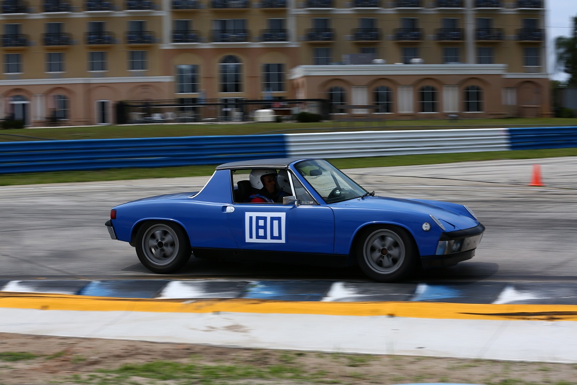

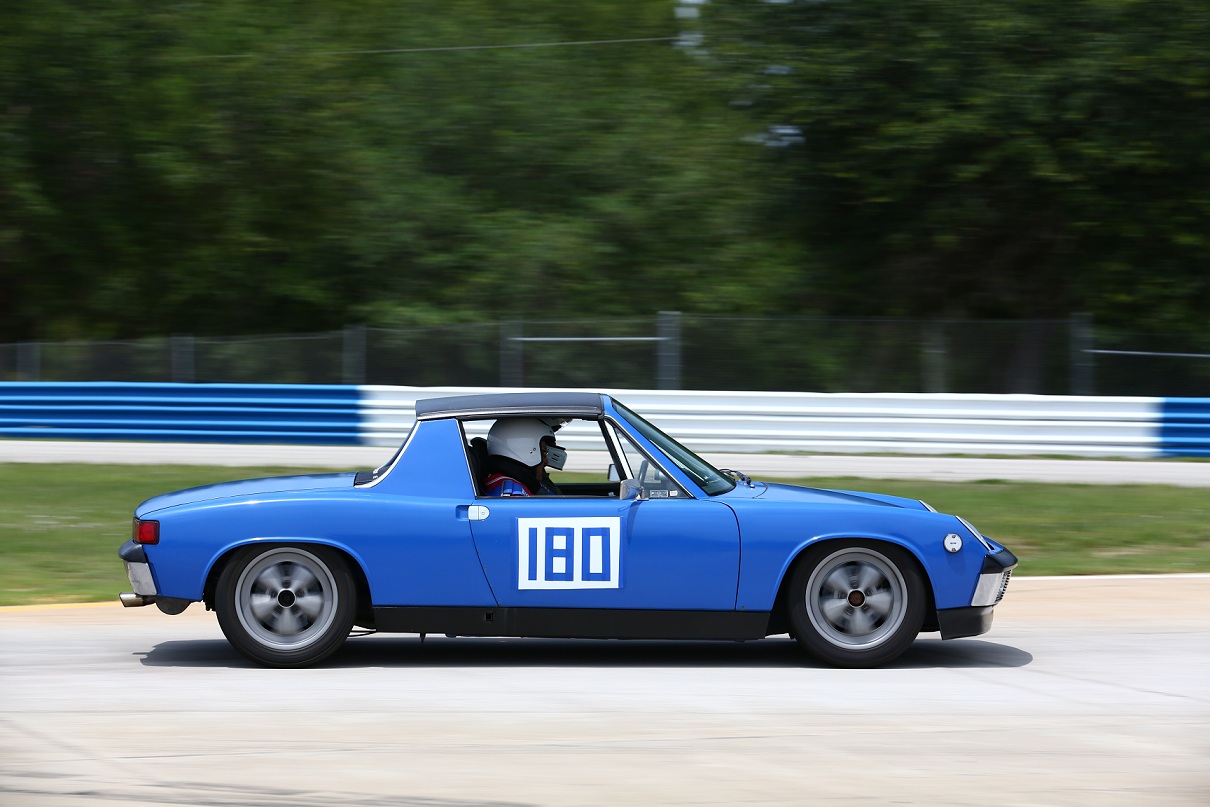

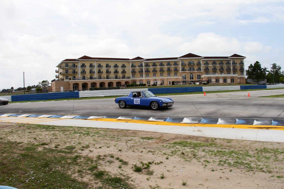

Thanks George and Marc for helping me get the car out and working this weekend. (IMG:style_emoticons/default/beerchug.gif)

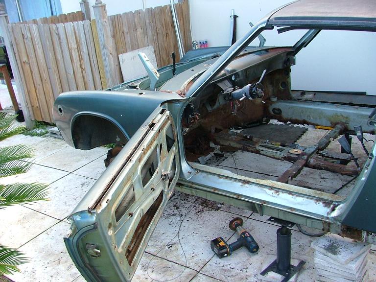

From this five years ago:
To this weekend:
Totally beat now... (IMG:style_emoticons/default/driving.gif)

(IMG:style_emoticons/default/aktion035.gif) Great pics John! Like I said, the car has come a very long way and you should be proud. But from what I heard this weekend, the driver has too. I think you'll get promoted next time out man. I had a great weekend - thanks for letting us hang out with you bud.

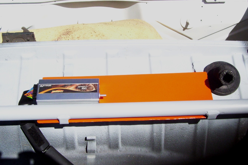

I mounted my Haltech in the trunk on a big piece of 1/8" sheet aluminum. I put stand offs to elevate the aluminum from the firewall. Seemed to work good. Never overheated the ECU. Basically it was a giant heat sink.

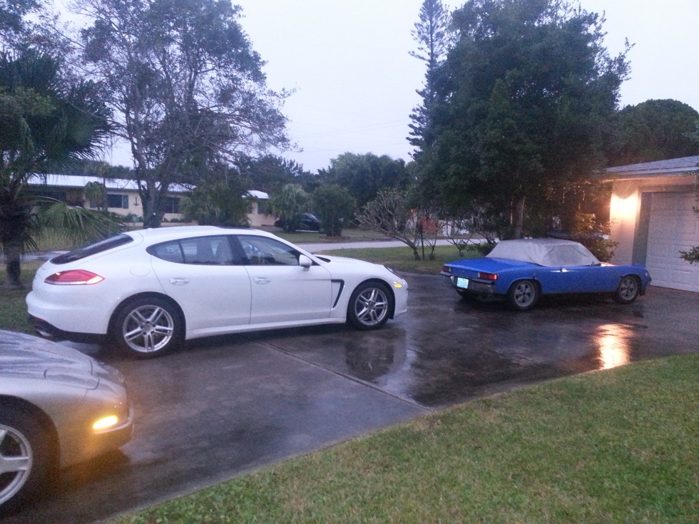

Do you think Porsches are getting bigger all the time?
The wheels on the Panamera are almost taller than the top of my 914 fenders.
This thing has more controls than the space shuttle.
I like the dynamic ride height feature. It just needs to hop.
This is a loaner car while my 911 is being worked on.
