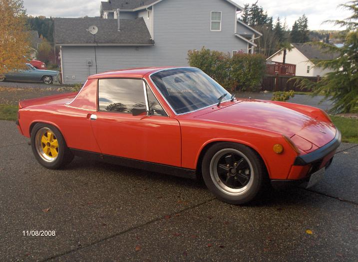

I got home Saturday just around noonish and notice this hanging out at my house:

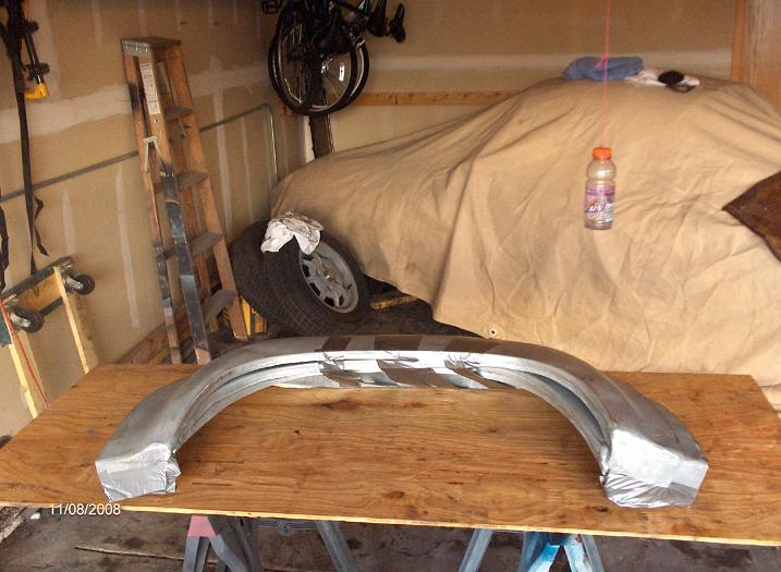

Next thing I know, Steve Peters is pulling flares out of the trunk of his 914. "What say we put on some flares Eh!" (IMG:style_emoticons/default/biggrin.gif)

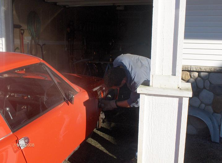

By one-o-clock, we had already made our first fitting and cuts. Here is Steve grinding away some of that most beautiful paint from his 914.

I think the yellow/black goes on the front bumper on a GT, not the Fuchs (IMG:style_emoticons/default/smile.gif)

Lets see how big or small these pictures are. This is the first of the cuts after steve ground the paint off the general cut line area. We start by fitting the bottom lips and tacking them onto the 914. From there you cut up, tack, cut, tack until the entire flare is tacked on with a perfect 1/32-1/16 inch gap to weld up.
