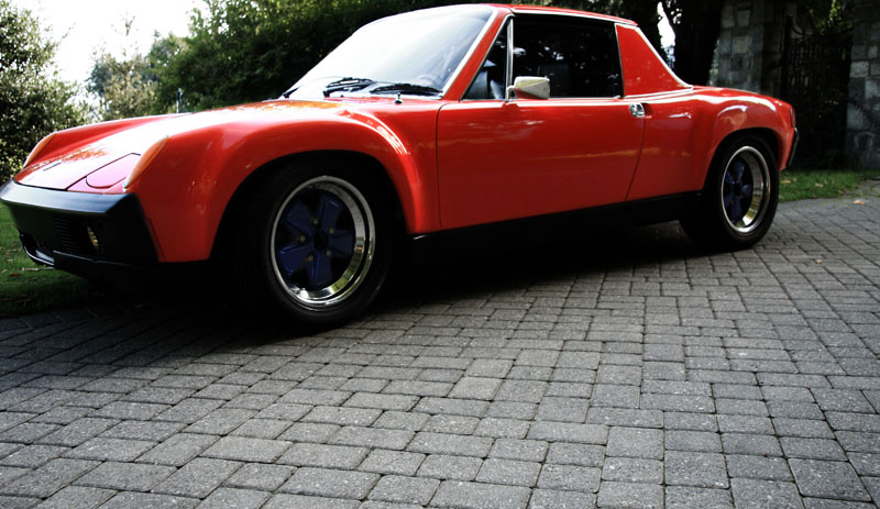

i just thought it would be good to show a picture of the car completed, a couple of years late but here it is
(i was just referencing this thread and noticed it didnt have a decent pic of thecar completed...that is the reason for the resurection.)

Pic?

QUOTE(Andyrew @ Dec 6 2010, 12:12 PM) *
Pic?
Blends in nicely with the background ... (IMG:style_emoticons/default/biggrin.gif)

You're lucky you got me when you did Steve. I'm not allowed to touch other peoples cars anymore.

..i think i could do it by myself next time!!!
but you have enuf projects to keep you busy!!! never mind the rest of us needy folks!!

(IMG:style_emoticons/default/drooley.gif)
Steve, that really turned out nice!

What a beautiful car. It looks fantastic! The Orange and Blue is very interesting...especially for me as I am a University of Florida alumnus!

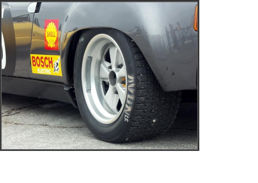

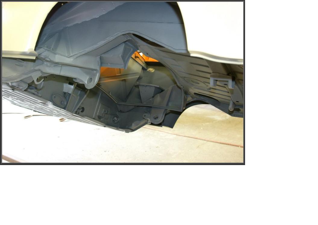

Attached ImageAttached ImageAttached Image

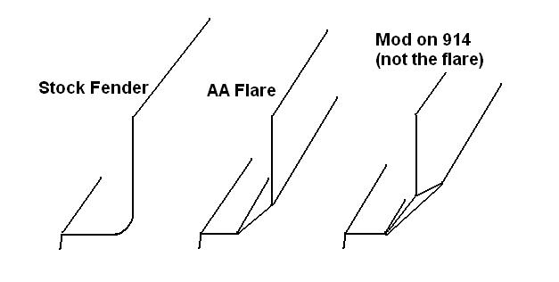

QUOTE(Chuck @ Nov 10 2008, 06:49 PM) *
How did you get the bottoms to fit? I've seen that as an issue on a few other installation threads with the angle of the steel on the car.
QUOTE(Chuck @ Nov 10 2008, 09:14 PM) *
QUOTE(Root_Werks @ Nov 10 2008, 07:41 PM) *
The AA flares have a 90 corner while the 914 stock fenders have that small double angle. When I cut for the bottom parts I grab the angle and flatten it out to match the bottom line of the factor fender which then matches up with the bottom of the flare.
Do you have any photos of this?
Does anyone have any 'finished' pics of these flares and that lower double angle junction?
EDIT: I found a few representative examples of that junction. Some of which show the bevel being followed through the flare itself. It would be nice to see how it was done on the 916. Some pics of that would be nice.
Does anyone live in Atlanta Georgia, who has access to the 916 (IMG:style_emoticons/default/idea.gif) ?

QUOTE(gothspeed @ Jan 26 2011, 10:45 AM) *
EDIT: I found a few representative examples of that junction. Though it would be nice to see how it was done on the 916. Some pics of that would be nice.
George has 2 factory flared cars
gothspeed
post Jan 26 2011, 03:53 PM
Post #137
Posts: 1,539
Joined: 3-February 09
From: SoCal
Member No.: 10,019
I wonder if george would be so kind as to post some pics of that bottom detail (IMG:style_emoticons/default/smile.gif) ............ I have looked through as many 916 pics as I could find on the web and none show a definitive example of this junction.
Any light anyone can shed on this junction would be very appreciated (IMG:style_emoticons/default/smile.gif)!!

What I use to do:

Hey Dan are you saying that you would metal finish the car body to that shape to match the AA Flare?

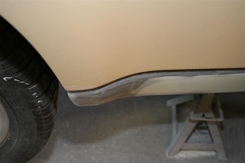

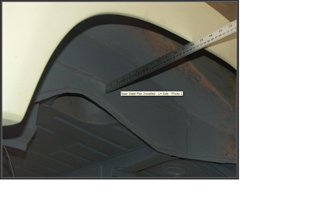

QUOTE(Root_Werks @ Jan 26 2011, 03:00 PM) *
What I use to do:
I did a search for 'rockers' and found a lot of cool pics and ideas as to how to finish that flare/rocker area. The lower body bevel to flare junction did not seem so straight forward at first, but after seeing some of the pics, there was indeed quite a few ways to address that area.
A few guys even brought out the rocker to match the body and hence the flare lines. It looks very clean and complete that way, so that is what I am gonna do with mine. Here are some of the pics from those other threads that I found very appealing.
