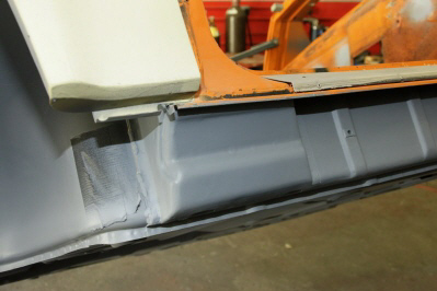

Armando ,chose to carry the tapered edge along the flare

This how I did mine , this not my car though.
flat across the wheel opening tapering to the angled fender panel.
see were the black spacers are looks right.

QUOTE(roadster fan @ Jan 30 2011, 12:00 PM) *
Hey Dan are you saying that you would metal finish the car body to that shape to match the AA Flare?
Jim
Yup, mostly because I'm not a welder or autobody person by profesion. So I opt for the most direct method of making the two pieces match up as best as possible. It's really, really hard to tell there is a transition from the fender to the flare. Especially after you in stall the rockers.

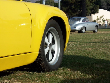

I love this thread... has any one installed the AA steel flares from the group buy??
I would like to see pictures of how they look and here any extra tips besides this thread on the install.

QUOTE(kfish914 @ Jan 30 2011, 05:39 PM) *
Yeah, I got my flares from the goup buy!! So far I think the best way to do that transition, is to continue the bevel in the same width and angle into the flare ....... then flat all the way to where the original fender was mounted ....... this will allow the rocker to body gap to remain 'constant' and also be able to use the same plastic spacer ....... this will give it some chance of looking like a factory job.
That yellow one above has nice rockers!! Though the 'body to rocker' gap diminishes as it goes into the flare. I think keeping the gap 'constant' will give it a much better look.
