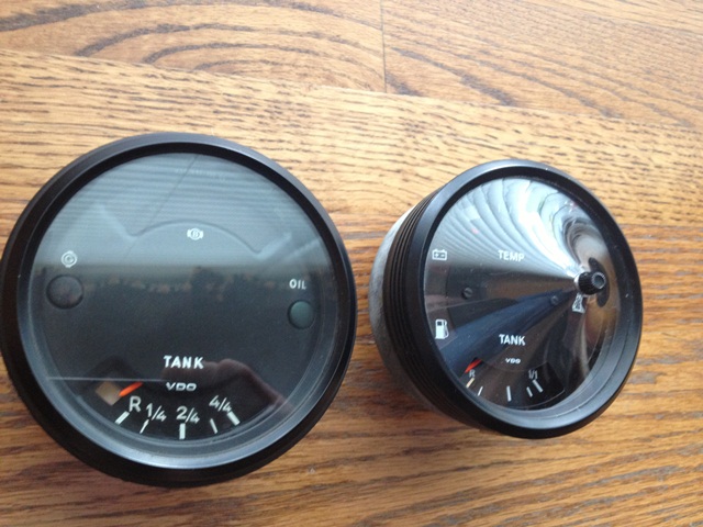

To confirm the early 924 gauge seems to be a perfect swap-out. Same size, same warning lights needed. Still need to verify the fuel gauge but I can always use the 914 one. I'll see if the Subie water temp sender is in any way compatible but if not the 924 sender is super cheap.

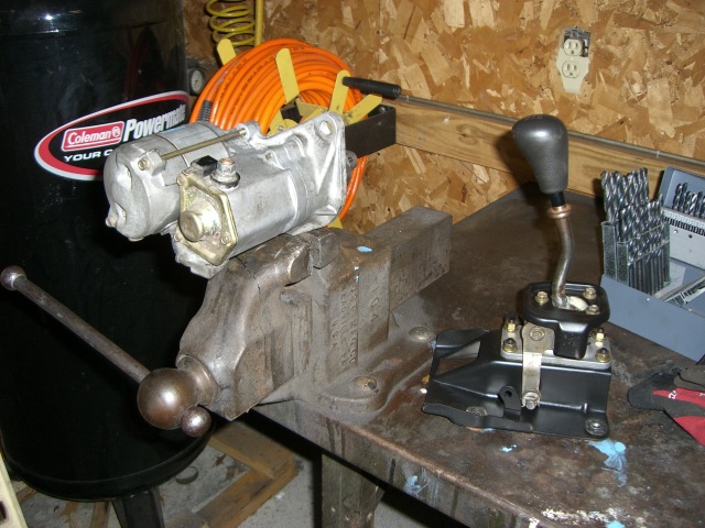

I'm using an Accord shifter and I am definitely looking for quality and durability over price as well. No skimping on this one.
Are you using aftermarket starter or something? If you use a stock starter you shouldn't need to shim it. My stock starter is hitting the trunk floor...might gave to go aftermarket myself. Don't remember any indexing threads but Bob would probably know. He used a high torque aftermarket one as I recall.

Here is the starter and shifter I'm using. No problems with clearance using them.
Bob

Thanks Bob! No clearance issues because you are a master craftsman. Looks like the same starter I am using. I'm gonna have to ding my trunk floor a bit. It's the solenoid that is hitting.

Its a stock Subaru starter for a 2005 2.5 RS with manual transaxle. I'm sure it fits other Subarus. I got a rebult one off Ebay for $39 with shipping.
