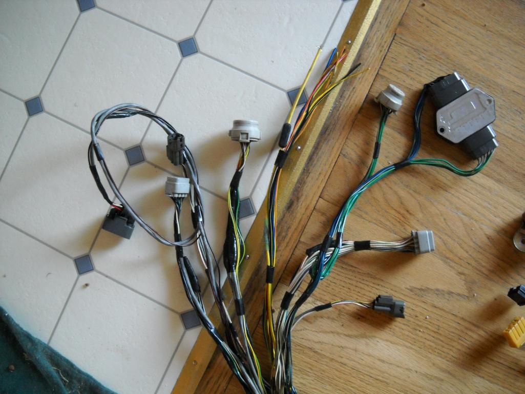

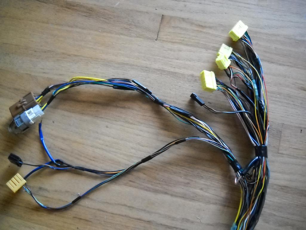

Some of the conections at the ecu are spliced just to shorten. It is pretty straight forward. keep the diode, subarus wont run with out it. (can be pulled for a start kill).
out put wires are:
big yellow= battery +
blue = fuel pump +
blk/wht = ign+
blk/yellow = starter crank
red/yellow = check engine
yellow small= tack signal
yel/red = vss/speed sensor
ornge = back up power/ bat+
yel/black,yel/grn= ecu power out(fans)
I left the pics huge so you can click and zoom in. hope this helps.

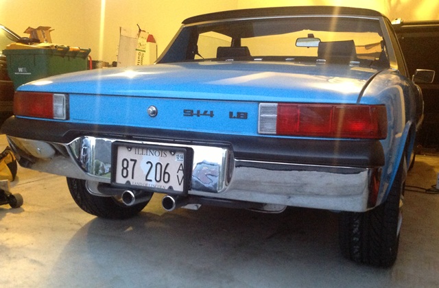

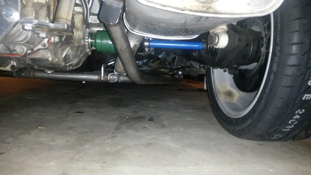

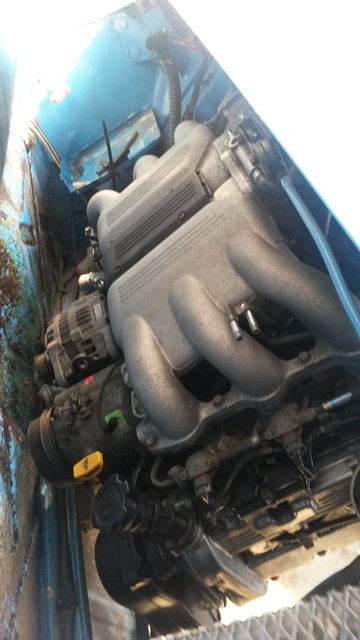

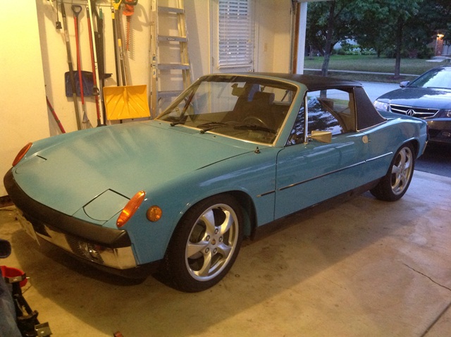

OK Kent, here you go!
These wheels were the best things I ever did to the car

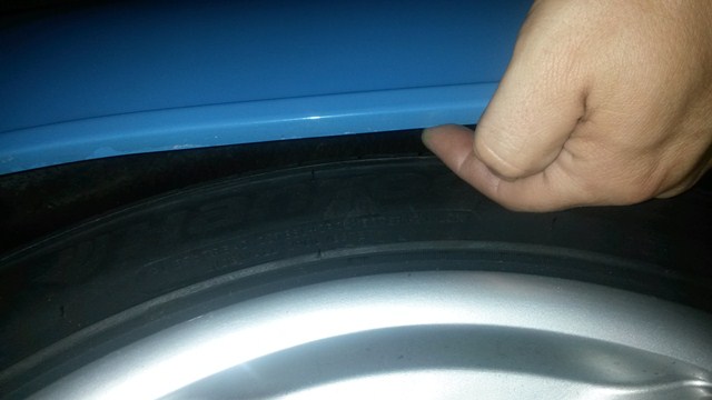

The passenger side is a little tight...might have to roll it.

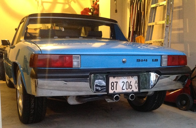

View from the back..note the exhaust system Bob made...the mufflers will be totally hidden when the valance is replaced. Tips are a bit high because the mount is slightly different but easily fixed with some heat...

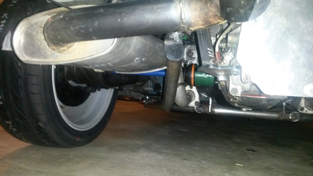

The lowest point of the car has 5 inches of ground clearance... I had to cut the mount bracing to fit the headers but will replace before driving the car.

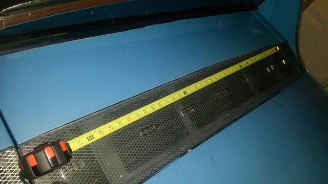

Ordered the radiator...it's 31X11...anyone want to guess the crazy idea I have for it?
From the top:
To do:
- cooling system
-cable shifter (Kent did you order your cables?)
-fuel lines
-complete the engine wiring harness (almost done)
Mike Bellis
post Aug 15 2013, 08:50 PM
Post #132
Resident Electrician
Posts: 8,347
Joined: 22-June 09
From: Midlothian TX
Member No.: 10,496
While I agree it would be great to fit the rad in the rear... Water is heavy. Pivoting a heavy radiator as an engine lid is fraught with peril.
Engineering a pivot point that will allow a HOT radiator to open so you can access the engine will be a challenge.
The ability to remove all the air from the system will be critical. Think about designing a self bleeding system. This will require a holding tank "T"ed into the water pump suction line. A bleeder valve (smaller Orifice than the radiator hose) at the highest point will spill into the holding tank. This can be a modified overflow line at the radiator cap. So as the system is pumping, the air will dump into the holding tank. Water in the tank will displace the air. Most German cars since the 70's have a system that works this way.
Good Luck! (IMG:style_emoticons/default/smile.gif)

Thanks Mike! Very thoughtful comments. It's just a crazy idea until the radiator gets here. Might not work but the rain tray is thicker than the radiator so who knows? I did buy a couple of reversible 10" fans so I have the option to blow the air out of the engine bay if I go that way. In speaking with Bob last week I think I will need a self-bleeding system either way so the cost to try it is really just a few feet of radiator hose...thanks for the explanation. As usual I was over-thinking the requirements.
If it doesn't work I always wanted to use the Cherokee radiator anyway. Should fit very well up front.

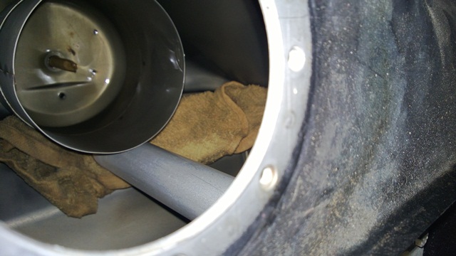

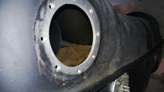

So I open my fuel tank...the GREAT part is that the thing is clean as can be inside...looks new....the funny part....looks like I'm not the only DAPO! What's this?
Looks like an old wash cloth! I picture someone's wife coming into a garage about 20 years ago and asking, "Honey where did you set that wash cloth when you were done with it?"...guy responds with "Ummmm....dunno sorry..." And there she sits...
