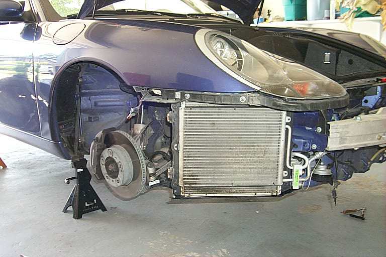

Mike Bellis
post Sep 12 2013, 07:55 PM
Post #189
Resident Electrician
Posts: 8,347
Joined: 22-June 09
From: Midlothian TX
Member No.: 10,496
QUOTE(scotty b @ Sep 12 2013, 05:22 PM) *
Have any of you actually looked into this as far as to get the boxter rads and see if they fit ? This was something I had also thought about doing, with Ruby's shroud as my fail safe plan. I tried a 911 fender mounted oil cooler and it is a bit big for the front wheel wells ( in front of the tires at least. ) I haven't tried it in the rear wells yet.
I was at Parts Heaven a couple weeks ago looking at a Boxster that was half stripped. I think it could be done with a Sheridan fender or a similar removable fender. The Boxster rad sits at a 45° angle with the leading edge closest to the center of the car. There is a built in shroud with it. I think it would be possible to use the fog light grills as intakes. The headlight bucket would need some re-working for air flow. With my headlight setup, this area is all wasted space. With a factory setup, maybe a little more work. The Boxster has way more room in the fender well than a 914. So you would have to utilize the space under the headlight bucket for sure, possibly even cut out the bottom of the bucket and have the radiator shroud as the new bottom. I'm just not sure if the flip down headlamp system would fit back in the hole.
My next water cooled project will go this way for sure. Maybe with a water cooled 3.6L flat 6... (IMG:style_emoticons/default/idea.gif)

scotty b
post Sep 12 2013, 08:16 PM
Post #190
rust free you say ?
Posts: 16,375
Joined: 7-January 05
From: richmond, Va.
Member No.: 3,419
The front mounted cooler is another thought I had. 2 of those, one in each rear wheel well, behind the wheel. I think airflow in would be o.k., but it would need some sort of exit. Fan setup could be tricky too due to the long thin shape of the front cooler (IMG:style_emoticons/default/confused24.gif)
