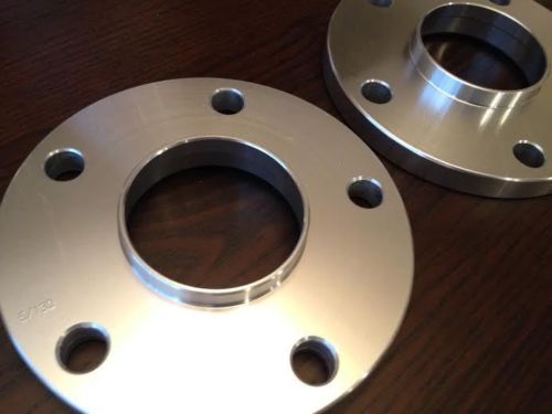

Hey does anyone know if you can stack wheel spacers? my drivers side rear wheel has a 15mm and I'll need to add another 5-7MMish...but could add more if I want.
They look like this...(not mine, I borrowed this from an e-bay ad):
Might be a terrible idea..that's why I'm asking.

I did on my conversion with no problems, but I was running 100mm wheel studs.
I think the key is having enough stud meat for the lug to bite on.

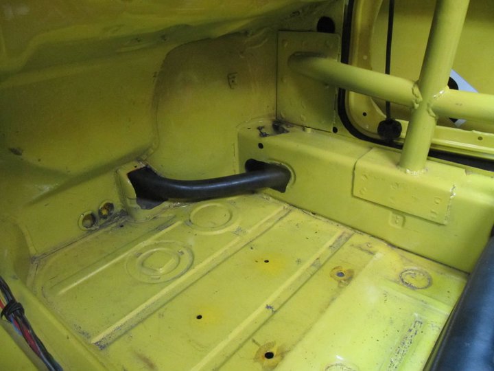

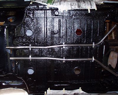

Still struggling with whether to run my coolant lines through the longs or under the car but I'm about 75% sure I'll use galvanized electrical conduit under the car in the recesses.
Question: Why do some of the conversions have different sized coolant lines? The line to the radiator is smaller than the return line? Is that necessary if I'm going under the car? I'll do it if it will help. I could do a 3/4 i/d to the rad and a 1" i/d return line or a 1" both ways as planned. Any thoughts on that?

I asked Bob the same question. I was told that the discharge side is always larger. Maybe because of the expansion. I think we shall find what does and does not work soon, as many of us that are doing this conversion. I hope the long route works. I like the clean look.

I did mine sort like how the Pontiac Fiero is setup. In almost all cooling systems that I researched the lines are diffrerent sizes. Mine are 1" and 1 1/4" and I'm running a GM 3.8L V6 and so far has worked very well.

I know your build very well Paul! I almost posted your photo above as the poster child for great looking underbelly piping. Thank you for the feedback.

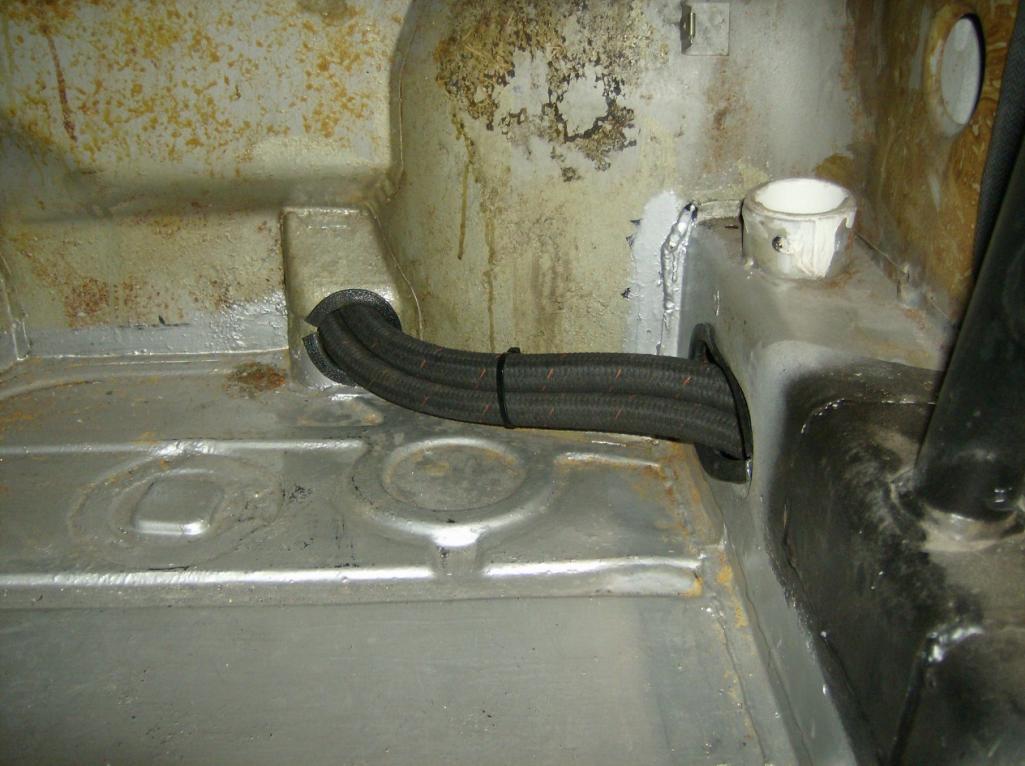

Would the fact that it has a protective coating help?
Is there an aluminum option that's easy to bend I wonder (IMG:style_emoticons/default/idea.gif) ?
Maybe I re-look at through-the-longs...rather not do the radiator hose underneath...
If so I'd try to do the oil-line-routing style.
Similar to these setups I found in the archives:
