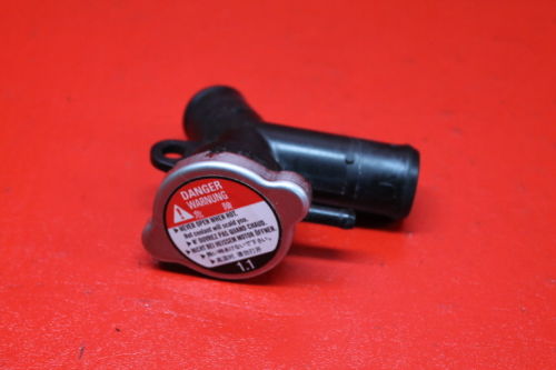

Wish I had more visual updates but I'm mostly collecting parts right now. Got all my hose and stuff. Right now I'm waiting for Jags That Run to call me back so they can send the last few bits for my cooling system setup. Spent way too much time over-thinking my coolant filler neck because the SVX high-point is at a weird angle just a few inches from the firewall.
Finally came up with something I think will work...
This is a Yamaha snowmobile/large motorcycle filler. Very durable (seems like an aluminum alloy of some kind...) and the filler neck extends quite a bit above the coolant hose "hole" which is needed since the engine line is larger and we're connecting it there. The sender on there can be removed and capped. The cap is loose BTW... The 7/8 hose fits great, although I think the original hose was 1" nope it measures 7/8". The lower hose exits the bottom and should easily make the turn without an elbow and run under the car.
I also bought this Honda 1000rr filler which has the same size hose outlets. Might try it as well but I like the Yamaha so far.

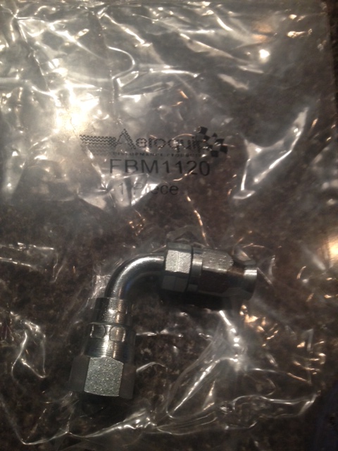

But first I need to install the clutch master...that little 90 degree elbow should be on my porch by now.

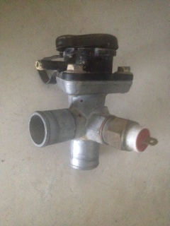

I'm glad you asked about the Honda filler because I was gonna offer it to you in the last post but didn't want you to think I didn't like your current setup (which I do like). It's just that it's copper so at some point you'll probably want to change it. This will work great whenever you decide to swap it out. The 7/8 return line goes in the upper hole which is your high point, then you can run another 7/8 hose from the lower outlet down to a tee where those larger hoses intersect, done deal. It has an attachment loop so you don't have to worry about it slumping over. I got it for $6.95 SHIPPED so I won't sell it to you but I'll be happy to give it to you when I'm done. I only bought it because the hose sizes looked bigger than they are in the e-bay pic. I think they are actually 7/8" now that I put a ruler to them. The angle of the lower inlet even kinda follows the contour of the firewall if you have the room (and I don't).
BTW the Yamaha filler is from a mid-90's VMAX snowmobile for anyone interested. Like $20 on e-bay. There are many models, 500, 600, etc.

I think this is the an 90
http://www.summitracing.com/parts/aer-fbm1120/overview/
Chris H.
post May 1 2014, 06:46 PM
Post #253
Posts: 4,070
Joined: 2-January 03
From: Chicago 'burbs
Member No.: 73
That's it! Just got it today. I searched the straight one I bought originally and it was easy to find with your pic. No excuses now I guess. Better get at it.
