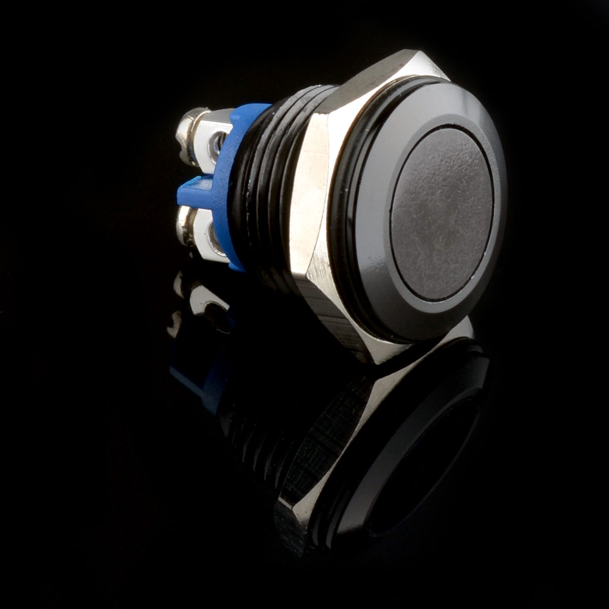

Well the "idiot" light is perfect for me (IMG:style_emoticons/default/biggrin.gif) . Apparently on the OBD 1 you can rig it to blink out the codes so you just have to find out what they mean. The nice thing is that it does not go into "limp mode".
I'm also installing a momentary switch where the block off plate for the rear defroster switch is. Got a 40 amp relay as well. My old Rabbit switch (it's what the factory used) frequently takes a couple turns to crank and I've read that the new ones are made in China. I know the Subie relay is easier on the ignition switch but I'd rather not dig into the steering column and swap it only to have the new one break soon after.
Got this:
It looks huge but it's not. It's the same size as the block off plastic piece. most people won't even notice it since it looks the same. If it ends up being a temptation for others to push I will use it as the windshield washer pump switch and get a different one later.
