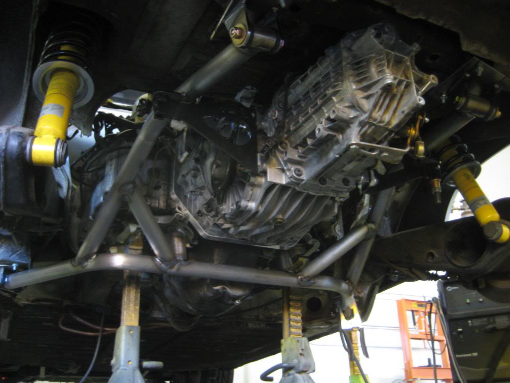

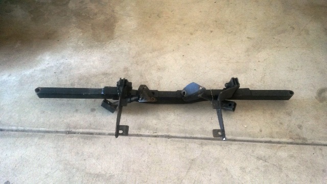

Here's the BIGKAT mount when it arrived this summer:
The trans hangers are attached for shipping but you should be able to get the idea for now. Is that easy (looking) or what? The geometry will take some thought but there are reference points at the holes on the mount I can measure. Pretty much just need to get it level and straight side to side. If you're not a welder it would be worth paying someone to do the final welds. Only hits two of the three engine mount holes but keep in mind you really only use one bolt per side when using stock mounts (which are not used in this scenario). Plenty strong and you have more room for exhaust options.

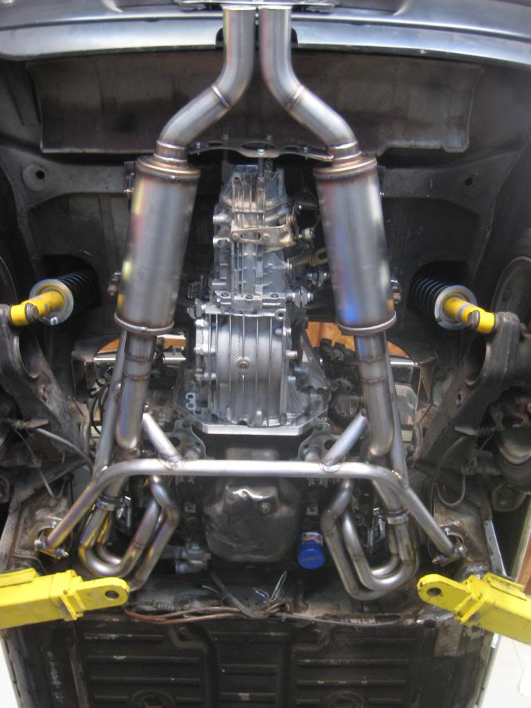

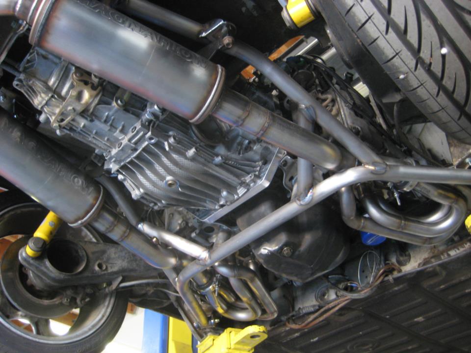

If I only had the money$$$$ I'd pay this guy to build a mount and headers.
By far the best out there.

Chris H.
post Nov 19 2014, 04:30 PM
Post #384
Posts: 4,070
Joined: 2-January 03
From: Chicago 'burbs
Member No.: 73
Yeah that is a tasty setup Bob. I look at that thing all the time now that you pointed it out. Boxster 5 speed trans? Love how they pushed the exhaust forward and then back.
Sounds pretty good too:
https://www.youtube.com/watch?v=Fe_vWc87e1c
Were those magnaflow mufflers or some exotic expensive things?
914forme
post Nov 24 2014, 02:30 PM
Post #385
Posts: 3,896
Joined: 24-July 04
From: Dayton, Ohio
Member No.: 2,388
Looks like Magnaflow rounds to me, and Burns SS pieces where use to fab the collectors. Pretty easy when you get right down to it. Easy of me to say, now me getting it done, thats another matter. Oh Santa, please bring me a plasma Cutter and Tig Welder. (IMG:style_emoticons/default/santa_smiley.gif)

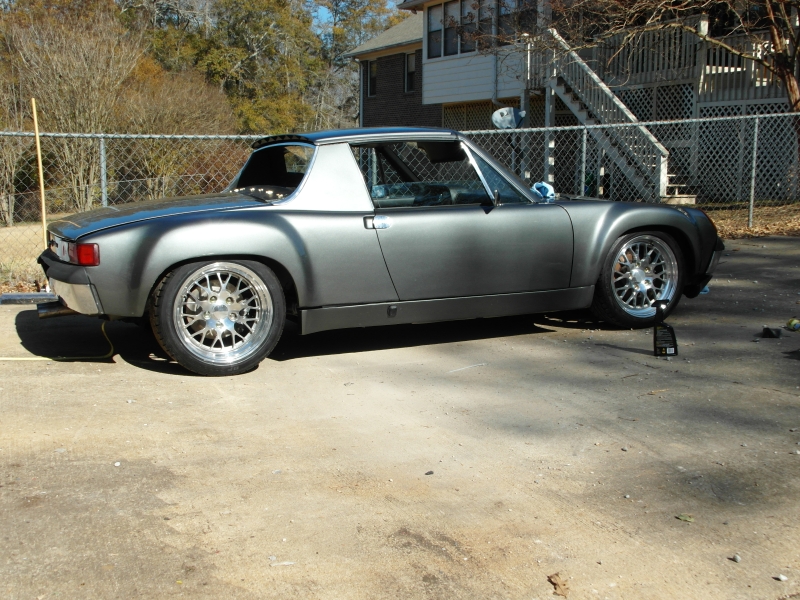

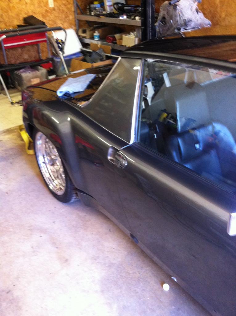

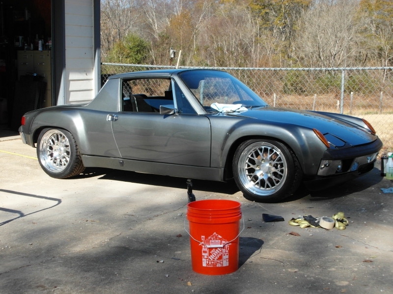

BIGKAT_83
post Nov 26 2014, 08:30 AM
Post #387
Posts: 1,800
Joined: 25-January 03
From: Way down south Bogart,GA
Member No.: 194

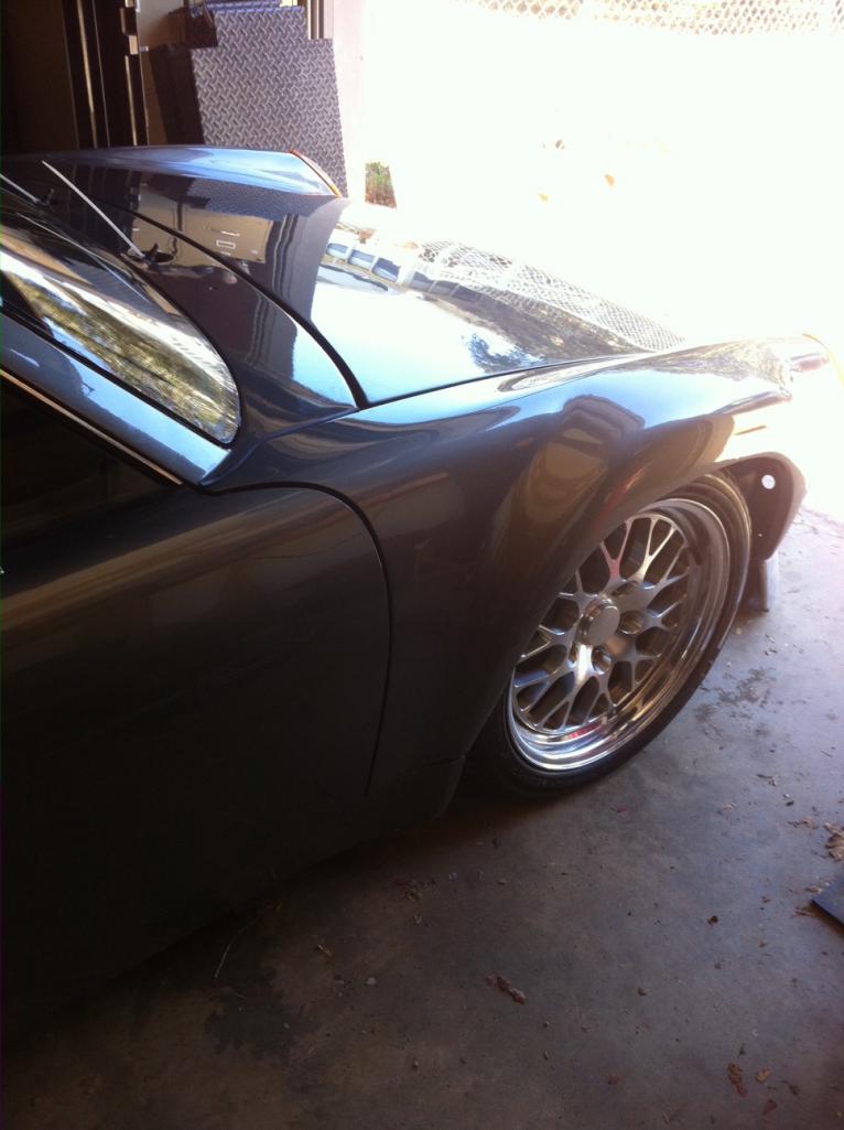

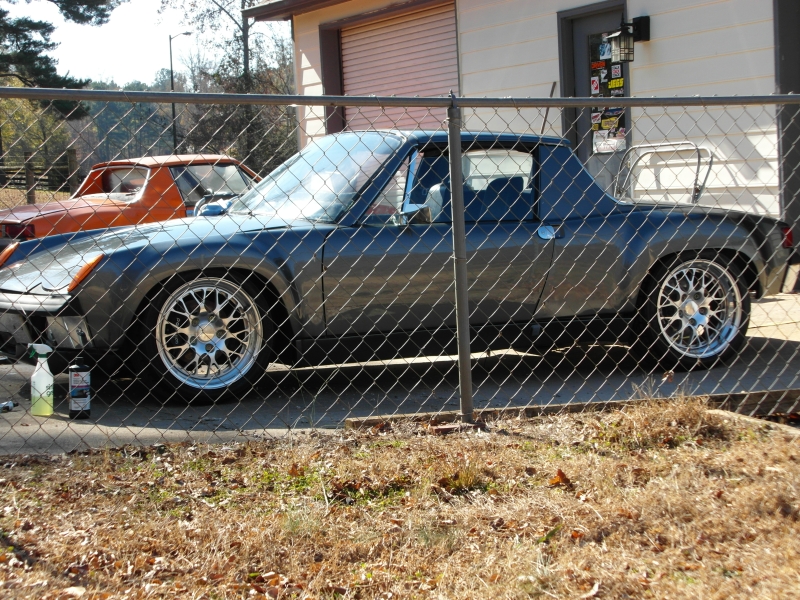

2 more Attached Image Attached ImageAttached Image

Bob,
That thing looks amazing. So it's an LS Corvette engine mated to a Boxster trans... Can't wait to see it in person.
Those two teeners look like caged animals behind the fence (other one is a V8 conversion too) (IMG:style_emoticons/default/biggrin.gif) .

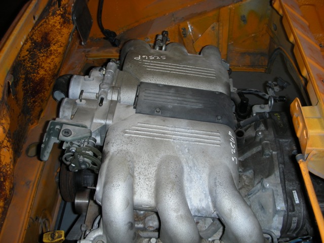

Chris, I have been working on my car, its just been under cover like the Manhattan Project. (IMG:style_emoticons/default/shades.gif) (IMG:style_emoticons/default/biggrin.gif)
Pondering engine and transmission mounting currently. Had a design i my head, bringing the engine and trans under the car just did not make it work for me. So back to the drawing board.
And I still have not brought myself to cut the car, (IMG:style_emoticons/default/confused24.gif) I have a cut it up before not thinking about the future value, when the cars where cheap it was easy. Need a huge front sway bar, put it in. Build the mounts weld it up. Need to stiffen the frame, weld the parts in. So why ca't I cut a trunk, or an engine shelf. (IMG:style_emoticons/default/headbang.gif) (IMG:style_emoticons/default/headbang.gif) (IMG:style_emoticons/default/headbang.gif) (IMG:style_emoticons/default/headbang.gif) (IMG:style_emoticons/default/headbang.gif) (IMG:style_emoticons/default/headbang.gif)
To that end I did flip the manifold which brings up a huge set of other issues, but it does fit better.
Not sure if I am going to do it this way or not.

Interesting...I'm seriously thinking about flipping mine and welding up the hole I cut for the intake. How hard was it? I hate that hole too!
EDIT: and did you flip JUST the top portion of the intake or both sections (it has 2 pieces)?
