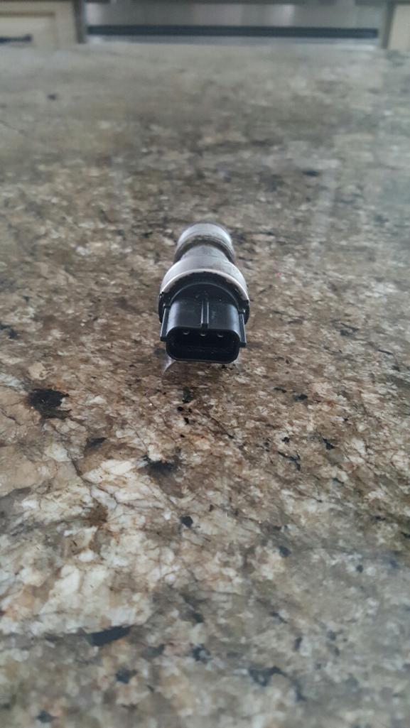

I'll pull it and shoot some pics tomorrow. I wired it up exactly as it was before using the stock wiring harness end.

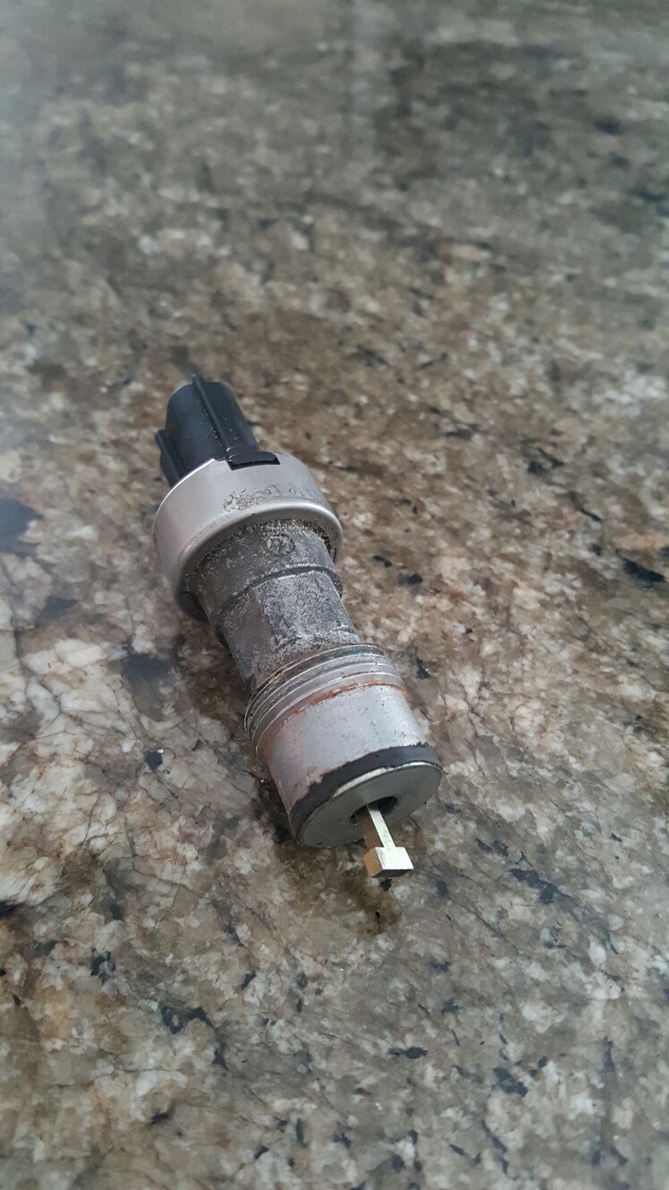

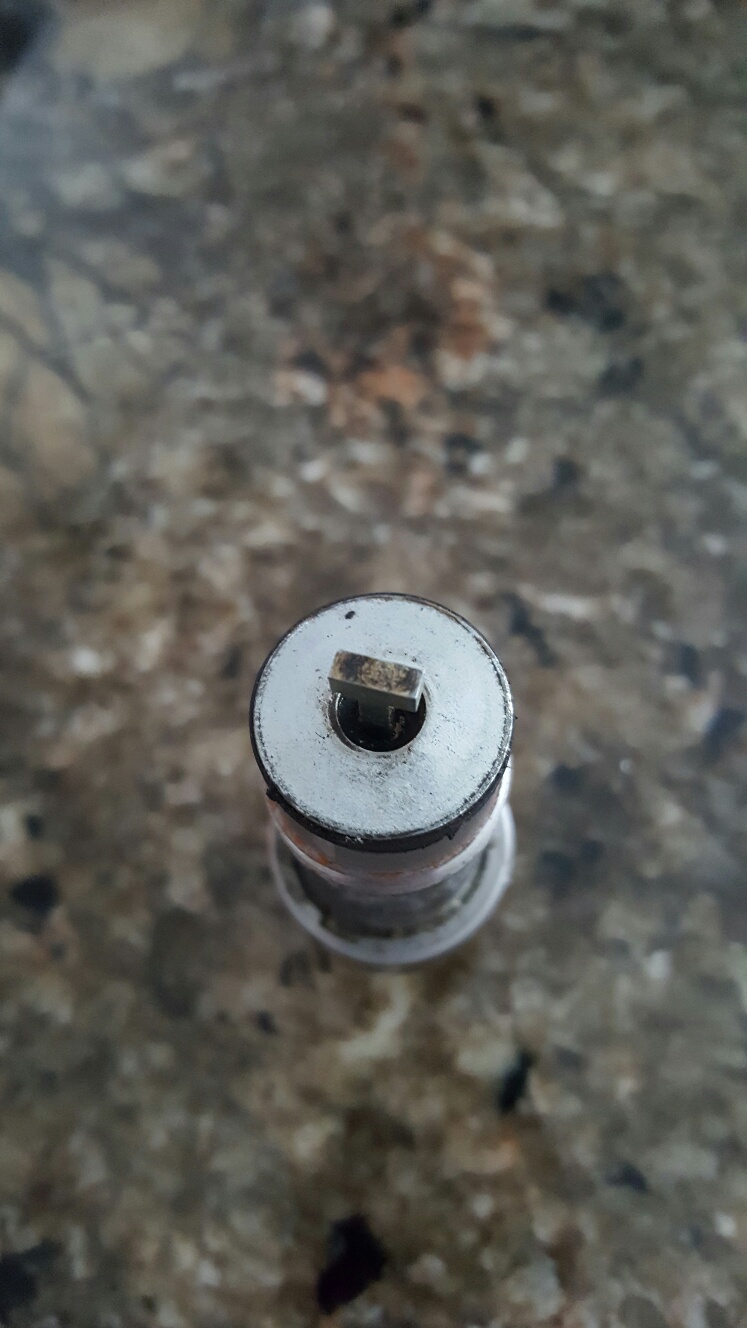

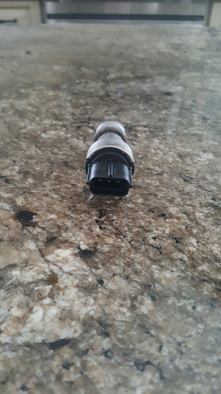

Sounds interesting Jeff. BTW...the VSS you're describing doesn't sound like mine.
Here's the one I am using.
Screws right in to the WRX trans but it's from the SVX trans. The T shaped part spins which is the speed indicator. It has 3 leads on top. Power, signal, ground. seems to spin OK. Don't see any bushings unless they are missing? Maybe I need to lube it and put some RTV on the threads to make sure it gets a good seal on the trans.

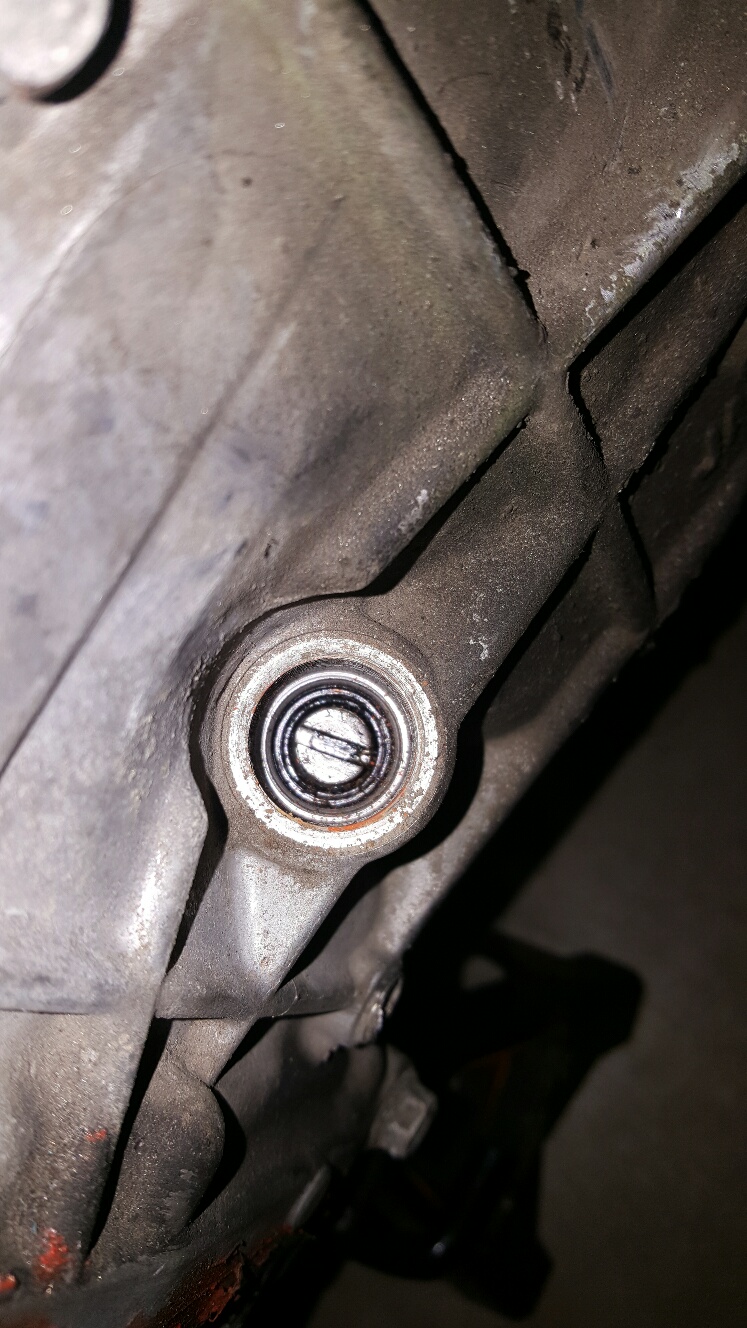

Chris, can you look inside the trans to see the where it seats? I ask because I don't remember if mine looks like that on the trans side. Then again at this age I can't remember what I had for breakfast.

QUOTE(76-914 @ Mar 18 2016, 08:48 PM) *
Chris, can you look inside the trans to see the where it seats. I ask because I don't remember if mine looks like that on the trans side. Then again at this age I can't remember what I had for breakfast.
Here's what the other end looks like Kent:
The T piece fits in that slot (or it won't screw in). The WRX one looked pretty strange on top. Couldn't tell where the wires went. It was just a round piece. The lower part was the same. It was made of plastic.

Chirs my mistake. I had an air leak on the vain in the intake. I was thinking if yours was sticking or leaking air that might be the shuttering problem. The vacuum valve it hooks up to had a crack on mine so it wasn't fully opening or closing the "air splitter" in the intake.
The trans pulse should be rock solid. The trans had one or did you have to put it in? Some of the ty756 trans didn't come with it and the have no gear inside. If you have a wrx tran it's probably a ty755?

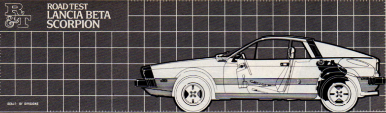

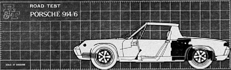

Quick question -could you give me some dimensions of the engine/trans assembly?
Assembly length, engine width, distance from front of engine to trans axle stubs would be greatly appreciated!
motoTrooper
post Mar 19 2016, 11:11 AM
Post #539
Posts: 39
Joined: 18-March 16
From: Palo Alto
Member No.: 19,774
Just found these for comparison sake, the 914 has a 6" longer wheelbase but they seem pretty close...
(IMG:http://www.914world.com/bbs2/uploads_offsite/i1111.photobucket.com-19774-1465832035.1.png)
(IMG:http://www.914world.com/bbs2/uploads_offsite/i1111.photobucket.com-19774-1458407477.2.png)
914forme
post Mar 19 2016, 01:11 PM
Post #540
Posts: 3,896
Joined: 24-July 04
From: Dayton, Ohio
Member No.: 2,388
QUOTE(motoTrooper @ Mar 19 2016, 01:11 PM) *
Well the entire thing from front pulley to end of the shift rod is just under 51"
It is just under 33" wide
And from the stub axle center to the front pulley you have 29" approximately.
All the numbers are approximates but they will get you close enough with a little bit of tape work or a couple card board boxes you can figure out if it will fit
