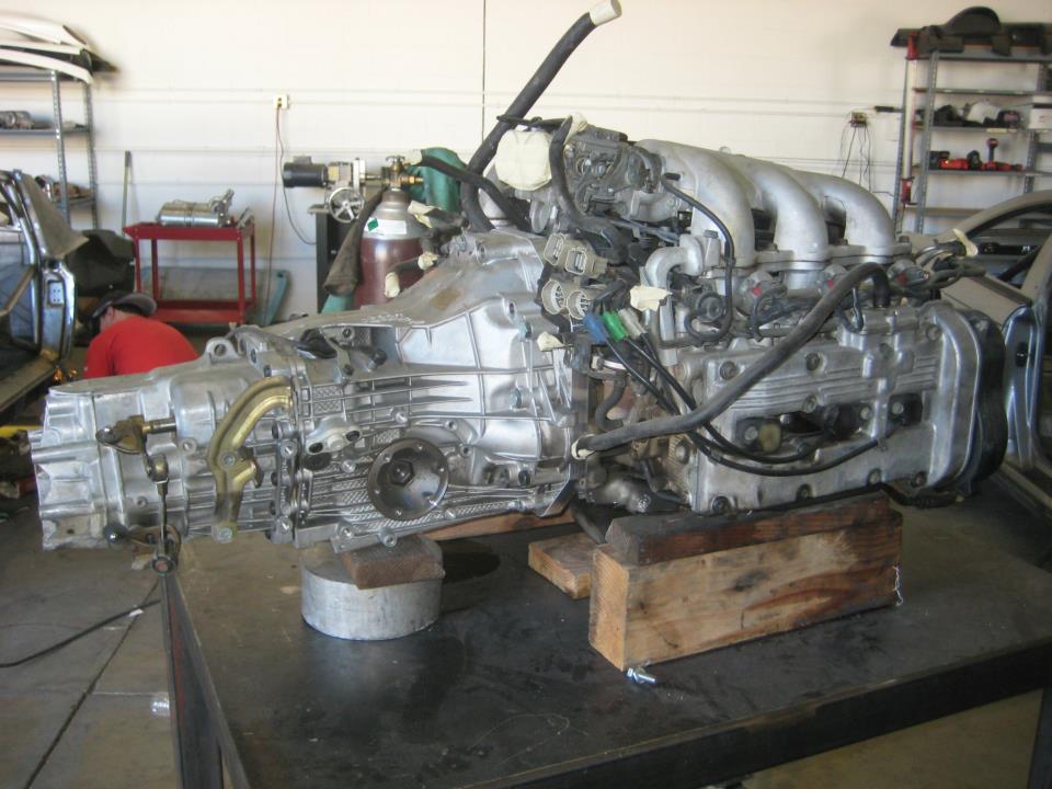

No they are in Arizona. Precision Chassis Works. Most of their info is on Facebook
Facebook Photos
Boxster 5 speed trans apparently (Audi):
The headers are a work of art.
Here's a short vid of the car:
https://www.youtube.com/watch?v=Fe_vWc87e1c
Bob has been there. The place is like a candy store for people like us.

QUOTE(Chris H. @ Aug 14 2016, 06:40 PM) *
Facebook Photos
EG 33 swap car
Yup, looks like the 5 speed trans with 100mm flanges. Just about the perfect combo for that engine IMHO.
