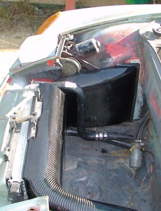

Has anyone done any successful ducting to exit out the wheelwells? That seems to solve alot of the problems in other cooling systems in exotics, etc. It would isolate the heat from the gas tank and anything else much better and could be relatively light if it's done correctly.

Yes several examples.
As much as I like the above unit it is for a oil cooler. I (IMG:style_emoticons/default/wub.gif) (IMG:style_emoticons/default/drooley.gif) (IMG:style_emoticons/default/aktion035.gif) (IMG:style_emoticons/default/pray.gif)
This is for a Radiator

Those are great examples but the radiator is what we're concerned with and while the carbon fiber is really cool, most of us don't have the skills for that so I'm looking for possibly a sheet metal creation of some sort. I'm currently working on the brakes and suspension but when I get to that point I think I'll need to come up with something functional for ducting. I'll probably be making some bends with the hose so I'll need all of the help I can get.

Ruby914 made that carbon fiber masterpiece. Maybe he would be willing to make some fiberglass copies. Kent I think the thing you need to do is get all of the water lines away from the fuel tank. The larger ones would be a bitch to snake through your longs and then up through the body. I'd just go down the center of the car underneath like I did. None are near the fuel tank even though it looks like it. You could wrap the ends that will be inside the front trunk to keep the heat down too.
