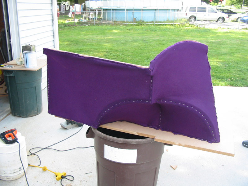

QUOTE(burton73 @ Jun 7 2017, 09:12 AM) *
You could build the shape out of canvas like you said and then coat it with fiberglass and polyester lamenting resin. I had a fiend do that to build a kayak when I was 11
You would have an item to sell if you used a standard cooling that guys building any water cooled 914 could use.
I had heat blowing into my cabin in my old SBC set up in the 70s. “If you want to run cool, you got run on heavy heavy fuel” No I just always thought it was not a good idea to warm up the gas.
Bob B
Fleece or tshirt cloth would be better, then fiberglass mat the inside for strength. It's how custom speaker enclosures are done.
http://www.tribalvisiontruck.com/newsubbox.htm
(IMG:http://www.914world.com/bbs2/uploads_offsite/www.tribalvisiontruck.com-431-1496897817.1.jpg)

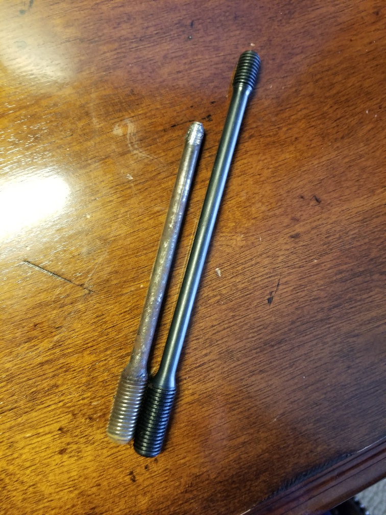

Which one of these is not like the other?
Question for you Steve, or another welding guru...I welded a nut on the end of that thing but it just would not adhere to it. a 12mm screws half way on so it was a great fit. I could fill the whole inside of the thing up but it would just twist right off. Not hot enough or what? The nut is not treated or galvanized. Assuming the stud is just a tougher material so it may need more heat.

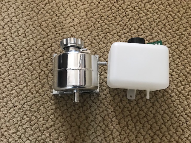

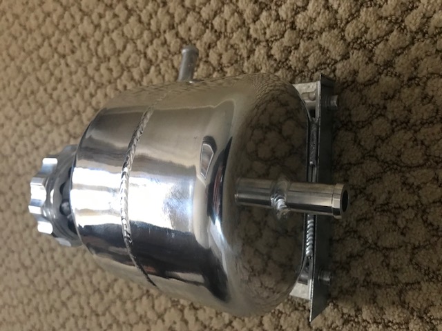

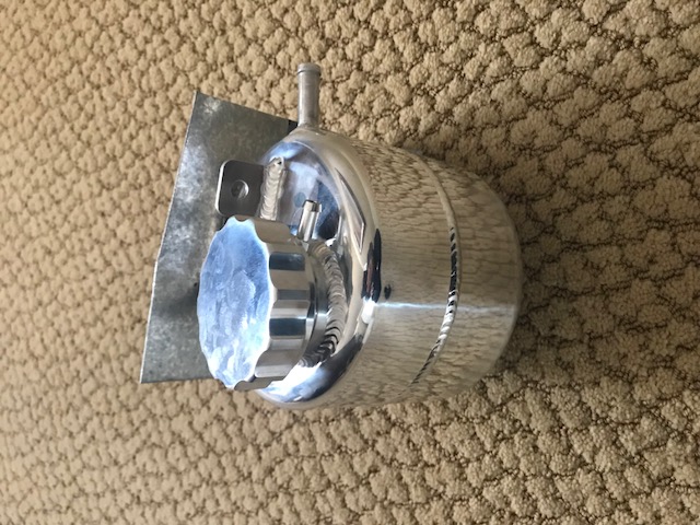

Another issue...the VW "globe" coolant reservoir started to leak a bit at the seam. I only noticed it while driving it that one last time for the season. Small amount of steam was coming out, barely visible and intermittent, but it would have been a big problem later on.
I'll be switching it to this:
Aftermarket aluminum tank designed for the Mini (2000-2005ish). It's a nice size and not too pricey at ~$60. Disregard the mounting bracket I made. It doesn't come with that. His a nice mounting plate on the side with two allen bolts (included). Apparently the Mini plastic tanks had a tendency to split at the seam as well which is the reason these were made. I would recommend the one with the 3rd outlet at the filler neck so that you can attach an overflow tank hose to it. There are two types out there and one does not have a 3rd outlet.
Then a universal unpressurized overflow tank.
This will resolve the other ongoing problem with the globe, which was that during the "self bleed" period it would puke a small amount of antifreeze out the hidden drain hose in the back making a mess. It was fine once the level was set and all of the air bled out but not great for the first few runs.

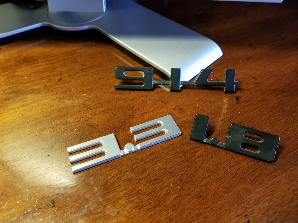

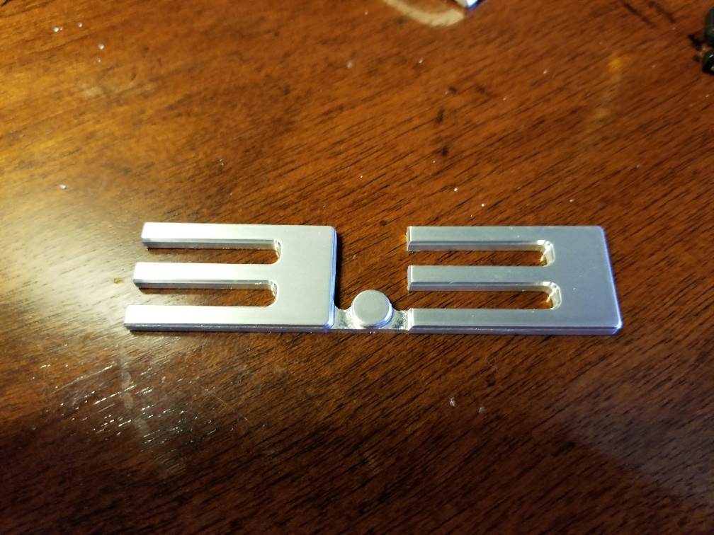

And hey check out my new "3.3" badge made by Mueller. Very nice quality aluminum emblem. Check the detail with the ridge on the outer edge and all.
Note how wide the Porsche font is. The "3.3" is in the exact same scale as the 1.8.
He can make any number/letter combo you want and it's very reasonably priced, especially for a custom request. I'll be painting mine black to match the "914".

I like the coolant tank! And one can never have to many Mueller parts!

Thanks Andrew. I'll be installing it early next week so I will report back on the performance.

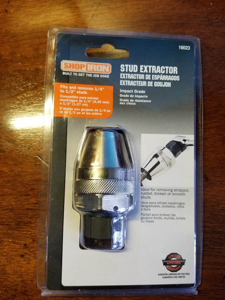

BTW in case anyone is looking at the Vanagon engine posts, yes, I did finally get that stud out. Here that stubborn SOB is next to its replacement.
After trying several methods, including drilling a small hole in it and using a "tee", welding a nut to it, etc., I finally coughed up $20 on this extractor and it came out easily.
I soaked it in PB Blaster for a week straight beforehand. That definitely helped.

QUOTE(Chris H. @ Feb 17 2018, 01:31 PM) *
Yep, that is the correct tool for the job. Welding on a rusted hardened steel stud over 30 years old would never be my first choice. And if it was It would be my last.
If you are going to use the welder as the tool of choice. I would cut them off closer to the base of the stud. If you have some threads there that is even better, put a nut on it, screw it down as far as it can go, but leave a bit of it for a valley. So nut sits a bit proud. I would then heat it with a small torch, burn off the crap. You can't weld dirt. You then take your MIG, I would prefer to use a TIG for this. And you go for the center of the stud, you get it nice and hot. And then work your way out. I would use flux core as it can handle a bit of crap in the weld if something cuts loose.
If doing this with a TIG, you preheat the stud, to fire red, with a torch. That will allow impurities to burn off. And then you can TIG clean metal. With the TIG you can get the tungsten down and start heating the stud before you get into the nut. You can then get them to almost fusion weld the nut to the stud, then you can work out and start adding filler. With this, you could then grind it and polish it up and make it look like a bolt.
You want to get heat all the way down the stud length, if you don't part of it will not be hardened. When you apply torque to the stud to try and remove it, it will stretch and snap right at the transition from soft to hardened metal. And you will be (IMG:style_emoticons/default/headbang.gif)
I have also been know to take a impact socket, prep it up, and weld it to the stud.
BTW, if you want the best stud freer around. You take some acetone, and automatic transmission fluid, you mix it together, and you spray, brush, drip, soak, whatever the offending part. It works like a champ (IMG:style_emoticons/default/shades.gif) Another thing I like to do is (IMG:style_emoticons/default/smash.gif) the head of the offensive stuck part, that allows the stuff to migrate down into the opening a bit easier. I even have a hammer that fits in an air chisel for just such an offensive item.
post Feb 17 2018, 08:14 PM
Post #840
Posts: 20,120
We use map gas on on the area around every stud then a snap on stud remover. Heat 2-3 min and then unscrew. I've done a couple hundred this way and never a problem. If I get any real resistance, I add another minute with the torch. Pretty effortless.
If the stud is broken close to the case, then I have our guy weld a nut, I heat the case and then remove.
If there is someone to help, one person heats one stud while the previously heated stud is removed.
We had some bozo cut off balljoints from a strut. Left the shaft in the strut. We welded on a nut, sprayed some penetrating oil and clamped the nut in a vise while turning the strut. Made it easy.
