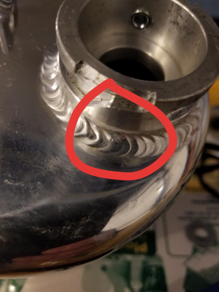

Well it's finally been warm enough to test out the new aluminum coolant tank I was so dang proud of. And...it leaks. At first I though the cap was the problem, but after looking closely at it while running it's definitely got at least one pin hole in the weld around the coolant neck. It just weeps a drip or two once in a while after it pressurizes. I'm not a good enough welder to fix it, and I don't HAVE a good enough welder to either. Just thought you should know in case anyone is thinking about buying one.
Might go back to the globe if I can't get this fixed. There is a version with no puke valve in the back.

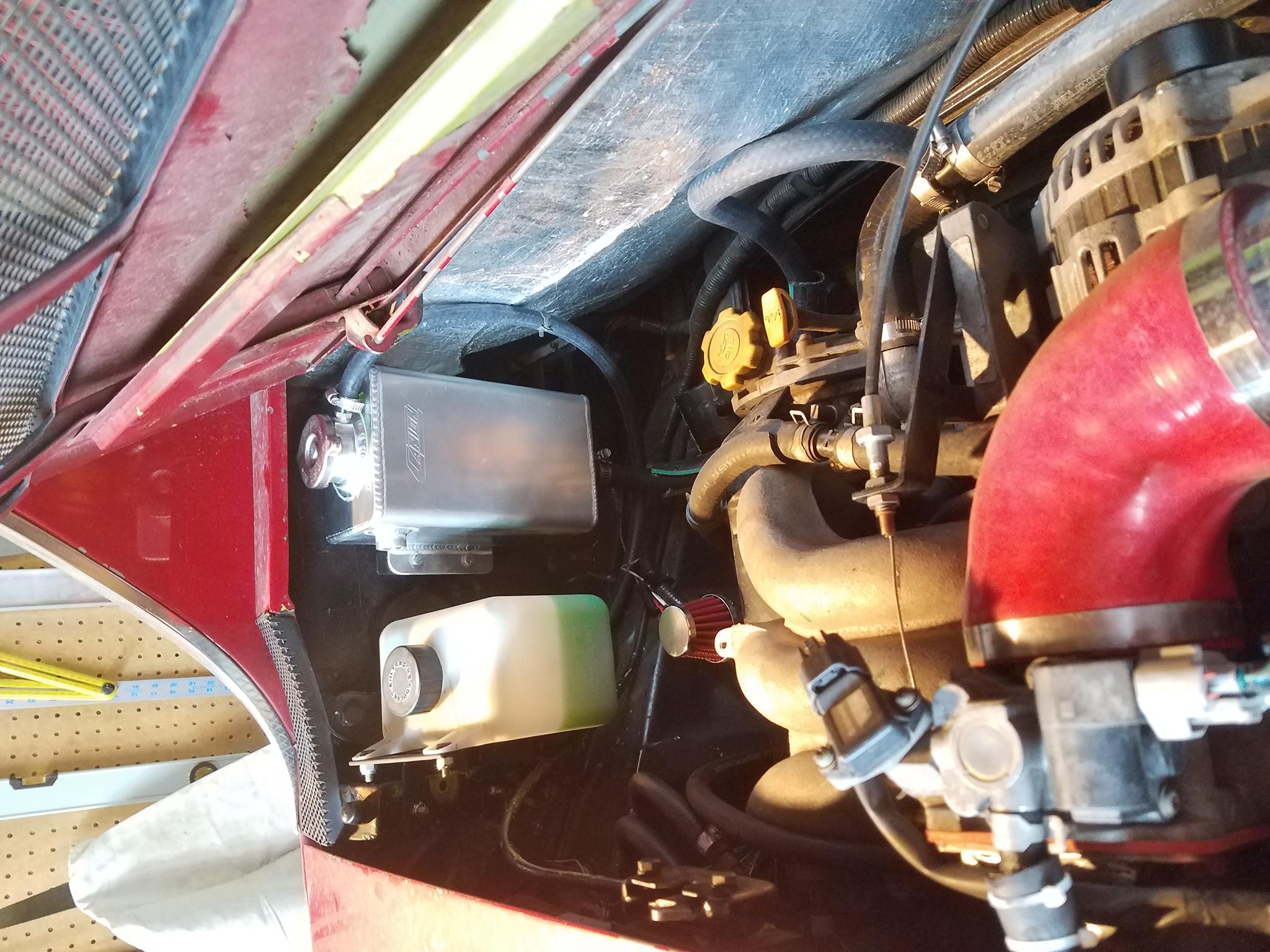

That's a bummer! I bought my expansion tank from Canton racing. It has worked out perfectly. https://www.cantonracingproducts.com/cgi-bi...&key=80-202
I purchased it from the garage sale section and paid around 80 bucks because it was scratched. To be honest I still haven't found the scratch? Great product and good service.
Ray

Here is a picture of it mounted. Attached Image I made a bracket that allows me to bolt it into the stock relay panel mount.

Very nice Ray. Always rewarding to avoid making any holes if possible. I have no experience with aluminum but after a few searches it looks like it could be fixed. It takes quite a bit of pressure for it to start leeching coolant. Probably be able to use a brazing rod. I’ll try to get a video of it. If I mess it up no big deal.

Thanks Bob! I THINK I fixed it but we’ll see. If not I’ll send it right down. I brazed the holes with aluminum brazing rod. Now I just need to drive it around a while and see if it holds.

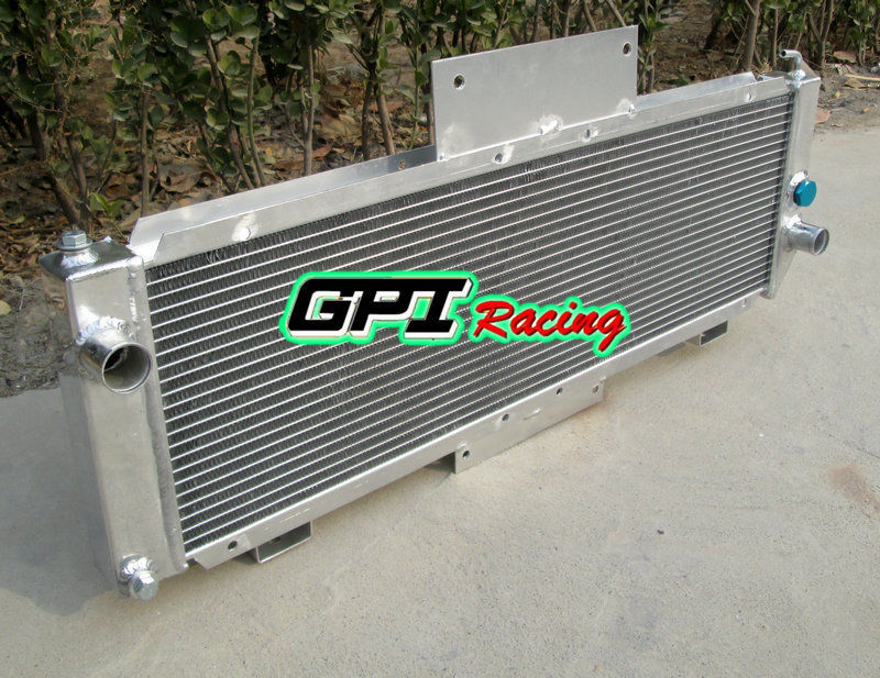

Of course I can't leave the car alone...so I swapped over to a horizontal radiator similar to rnellums' setup last year and it's working fine, but can't stop thinking about this one:
It's out of the Renault Alpine A310 V6 3.0. Monza-looking car that was not imported to the US.
So the original radiator I wanted to use years ago was the the 4.0 Jeep Cherokee rad but unfortunately it was too wide. This one is JUST narrow enough to fit. It's 10" tall and just under 31" wide. It would stand up vertically in front so I could push it almost flush with the front of the car. My only concern is whether it is large enough to cool the EG33. Assuming yes since the Renault is a V6 3.0l mid engine with radiator up front, but I guess there's only one way to find out. If it was a $50 RAD I would just go for it, but these are ~$200. What do you guys think?
Link to e-bay ad with more info:

How the heck did you stumble upon this radiator? Talk about rare and obscure! (IMG:style_emoticons/default/smile.gif) I'm shocked someone is actually making this for such a small market, crazy...looks good.
An embarrassingly lengthy internet search a while back Mike..(IMG:style_emoticons/default/biggrin.gif) . Just kept searching for the dimensions until I found one that might fit. I agree...how many of these could they POSSIBLY sell??? I have never seen an A310 in person.

The SVX rad is actually quite a bit taller than the Alpine rad. The Alpine is only 10" tall, whereas the SVX is about 15" tall and not quite as wide.

Since the Alpine engine is a 3.0, I'd think the cooling would be sufficient. It's also mounted in the front too, correct? And I didn't know it was only 10 inches tall! I'm measuring around 17 on the SVX radiator and I'm still thinking about the venting solution but I don't want to go out the bottom - I'm trying to keep it as stable as possible at speed and in crosswinds since we have more than a few of when I drive out of state - almost anywhere results in desert.
