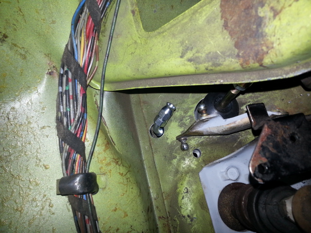

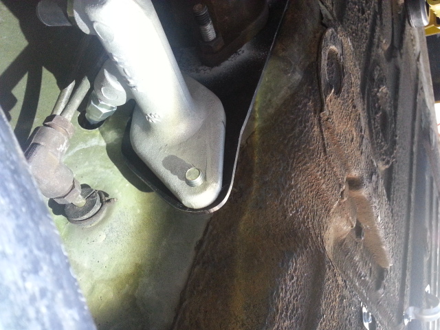

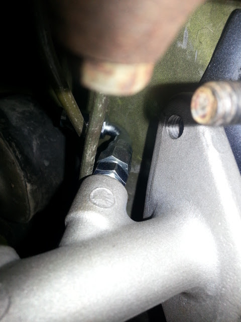

My 90 degree fitting is hitting the firewall keeping me from bolting the master cylinder in. I am not sure what the solution is yet. Different fitting? Cut a hole?
A&P Mech
post Sep 26 2015, 10:31 AM
Post #127
Posts: 401
Joined: 10-September 13
From: United States
Member No.: 16,371
Fitting interference.

Can you post a wider shot? I wouldn't cut another hole. There are a lot of fittings available. Kent should be along shortly.

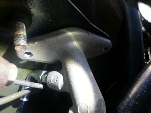

A little better.
I am thinking of punching a hole just above the master cylinder and turning the fitting around so it points into the interior. I need to get the hose into the tunnel anyway. It might solve the problem. The only down side is the hole would have to be a bit larger.

Problem solved. It worked out great. I just ran the 90 degree fitting through the fire wall.

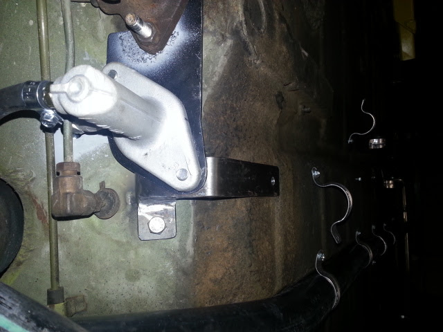

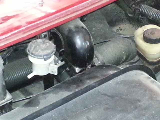

Clutch reservoir bracket fabricated and installed.

You got it. Mine is offset to the left.

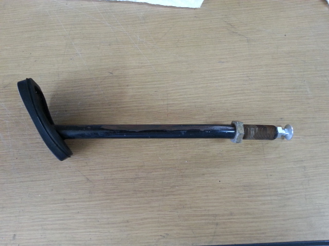

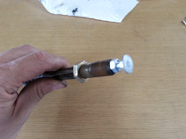

Modified the clutch pedal with a pedal stop. I drilled and tapped the pedal arm. The pedal arm is made of some of the softest steel I have ever worked with.

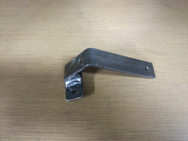

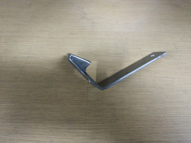

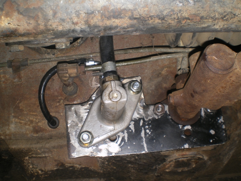

I finished the hydraulic clutch installation last weekend. During the bleeding process I noticed that the plate that I fabricated was flexing when the pedal was pushed through about half its travel. I made my plate out of 1/8" steel. It's what I had on hand. To remedy this situation I fabricated a stiffer bracket. I think it will put an end to the flex.
Would it make sense to weld a plate to the pedal area vs using an adaptor plate?

I am not sure how that would work? The adapter plate places the master cylinder about the perfect distance from the pedal arm. The sheet metal in the area where the clutch master needs to be is not flat and it angles in towards the pedal cluster. I think it would take a bit more metal work to get it to fit. With all that being said I have not tried it, so I could be wrong.

3/16" will cure that. Mine is 1/8" and flexes but I want to see how it holds up. I've got a 3/16" plate to throw in if it ever fails. (IMG:style_emoticons/default/poke.gif) What, your not tossing your hat in the ring with the rest in the "Build-off thread". It's not too late. Some of those projects are a few years old. (IMG:style_emoticons/default/av-943.gif)

I did think about going with a thicker plate but I had the 1\8" steel strap. I am not sure how well it will work yet. I haven't had a chance to try it out.
