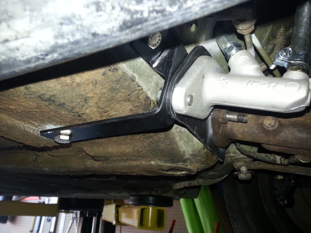

QUOTE(76-914 @ Oct 5 2015, 09:35 AM) *
3/16" will cure that. Mine is 1/8" and flexes but I want to see how it holds up. I've got a 3/16" plate to throw in if it ever fails. (IMG:style_emoticons/default/poke.gif) What, your not tossing your hat in the ring with the rest in the "Build-off thread". It's not too late. Some of those projects are a few years old. (IMG:style_emoticons/default/av-943.gif)
Guess what? When your finished you will have a new daily driver. (IMG:style_emoticons/default/beerchug.gif)
I finished the clutch bracket install. It works like a champ. I am getting zero flex or movement! The master cylinder is rock solid. (IMG:style_emoticons/default/piratenanner.gif)

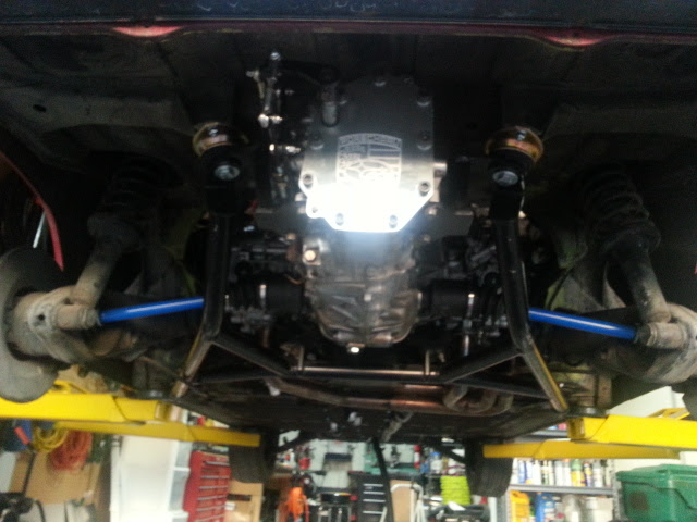

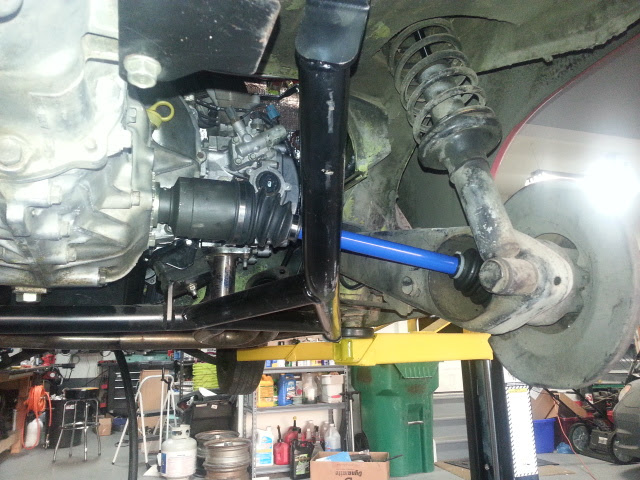

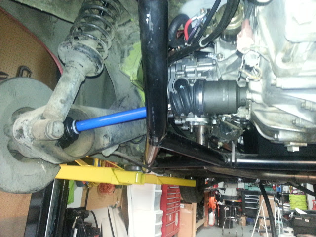

I made a little progress tonight. I got my axles put together and installed. (IMG:style_emoticons/default/piratenanner.gif) The next big project will the exhaust. I am thinking about fabricating it from the header back. I have been looking at mufflers and I am leaning toward the Flowmaster HP2. I would like the exhaust to be quite. Anyone have a recommendation other than the HP2?
