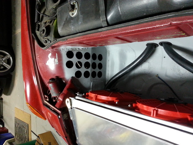

Now that the car finally drives it's time to make it road worthy. I started to get my front fenders vented for the radiator exit air. I used a 2" panel hole cutter with my 1\2" electric impact. It worked like a charm. The total area of the exit holes on both fenders will equal twice the total inlet area. After looking at the finished job, I think I could have gotten away with a few less? I am pondering welding in some expanded metal to add a little more rigidity?

QUOTE(A&P Mech @ Oct 19 2015, 04:55 AM) *
You have to consider the turbulence caused by the holes. I think your fine.
You could have gotten away with a much smaller overall hole, but it would have to have been shrouded.

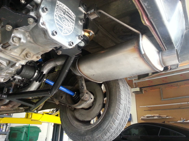

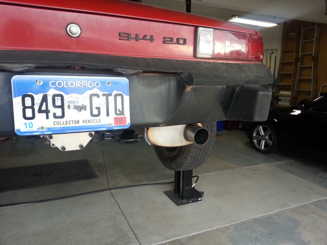

Today was a great day. I was able to get my exhaust systems completed. I had a local exhaust shop fabricate it. (IMG:style_emoticons/default/smile.gif) I know I should have tackled it myself but I am running out of good weather and I wanted to get some driving in before the white stuff starts to fall.
I have to give a big shout out to rnellums for towing my car to and from the shop. The shop was in downtown Denver and flat towing a 914 through traffic can be exciting.
I am planning to button up a few things and attending my first cars and coffee on Sunday. (IMG:style_emoticons/default/driving.gif)
Here are a few pictures of the completed exhaust system. It sounds great. Not to loud but a good deep rumble.

Looks great! (IMG:style_emoticons/default/piratenanner.gif) How about some more pic's of your entire exhaust system for future 2.5 NA builder's. I've got a feeling this will be the engine of choice for most folks. If I may ask; what did the muffler shop charge? Got a sound bite?

I will get some more pictures and a video/sound bite up today.
I was really impressed with how hard the car pulled with just a 2.5l n/a @5000 plus feet. I am a happy camper.
The muffler shop charged just two hours of labor. They welded my header, fabricated a heat shield and the exhaust system from the header back. The total out the door was $500. The car was dropped off at 9am and picked up by 1pm.

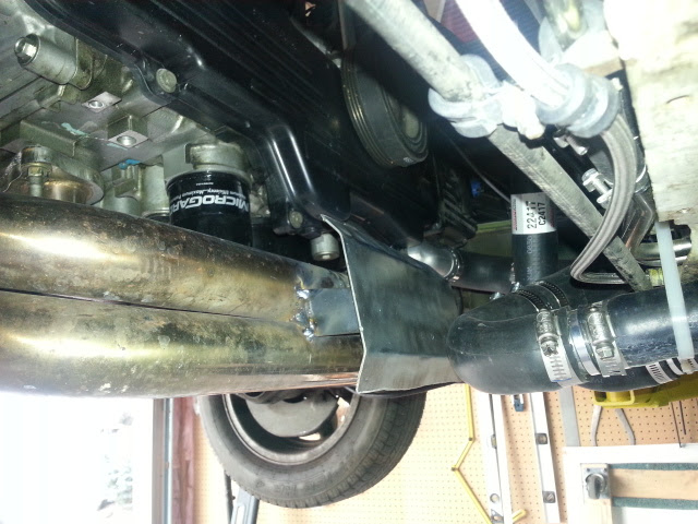

Member No.: 2,460
what header are you using with coldwater cradle? looks very good (IMG:style_emoticons/default/smile.gif)

QUOTE(jimkelly @ Oct 24 2015, 08:18 AM) *
That is a very good question? I am not sure. I picked it up used. The header appears to be for a turbo engine. The header exit points up . I would assume for an up-pipe?

Thats seems a bit high, but Im sure their work was worth it. If they included the muffler then that is a lot better.
Of all the exhaust systems I've made myself I have never been happy with them. All the systems I've had made for me at the shops have been fantistic.
I normally do my own shopping for the muffler and components and let them supply the piping and labor. Now I do have the luxury of cheap labor, so YMMV..
