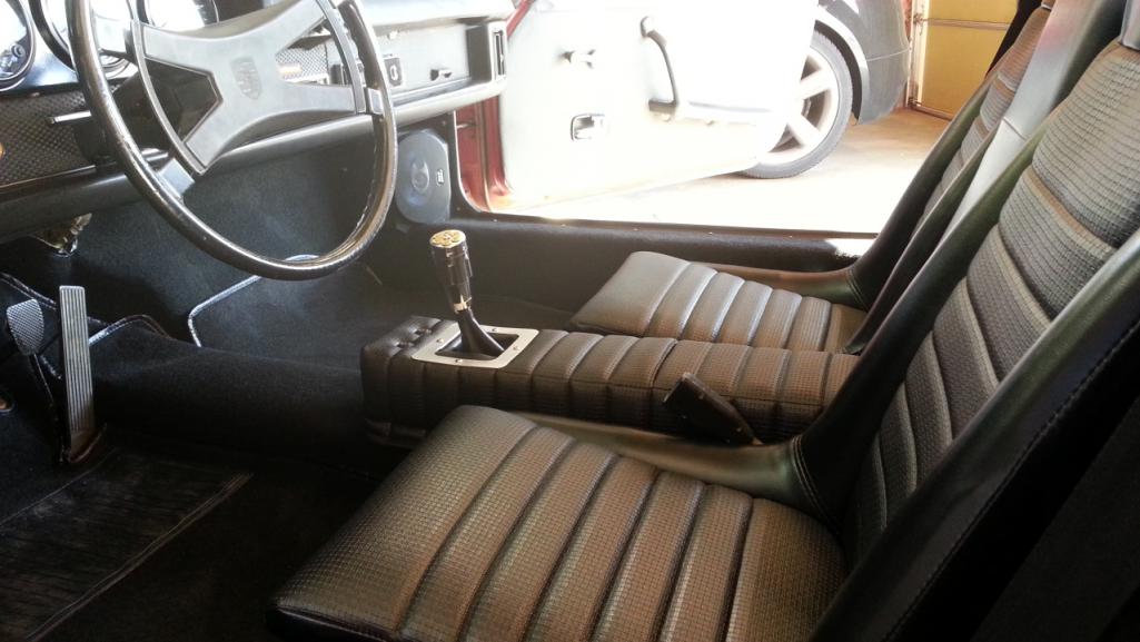

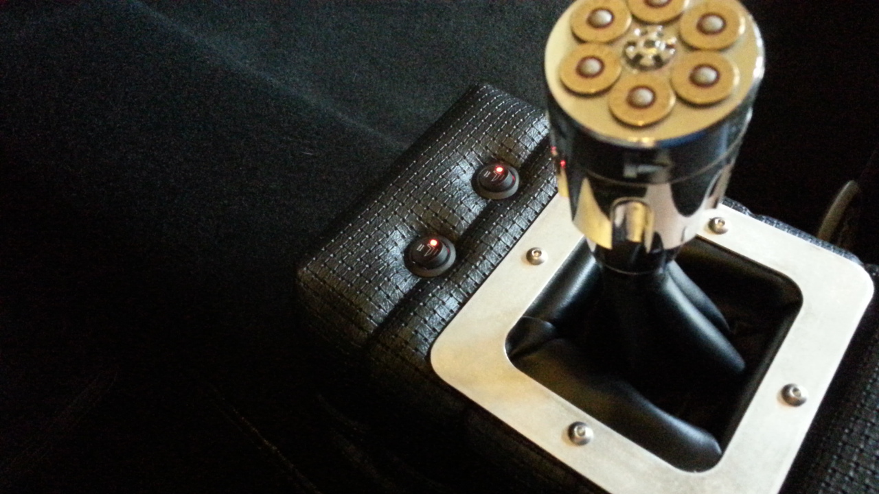

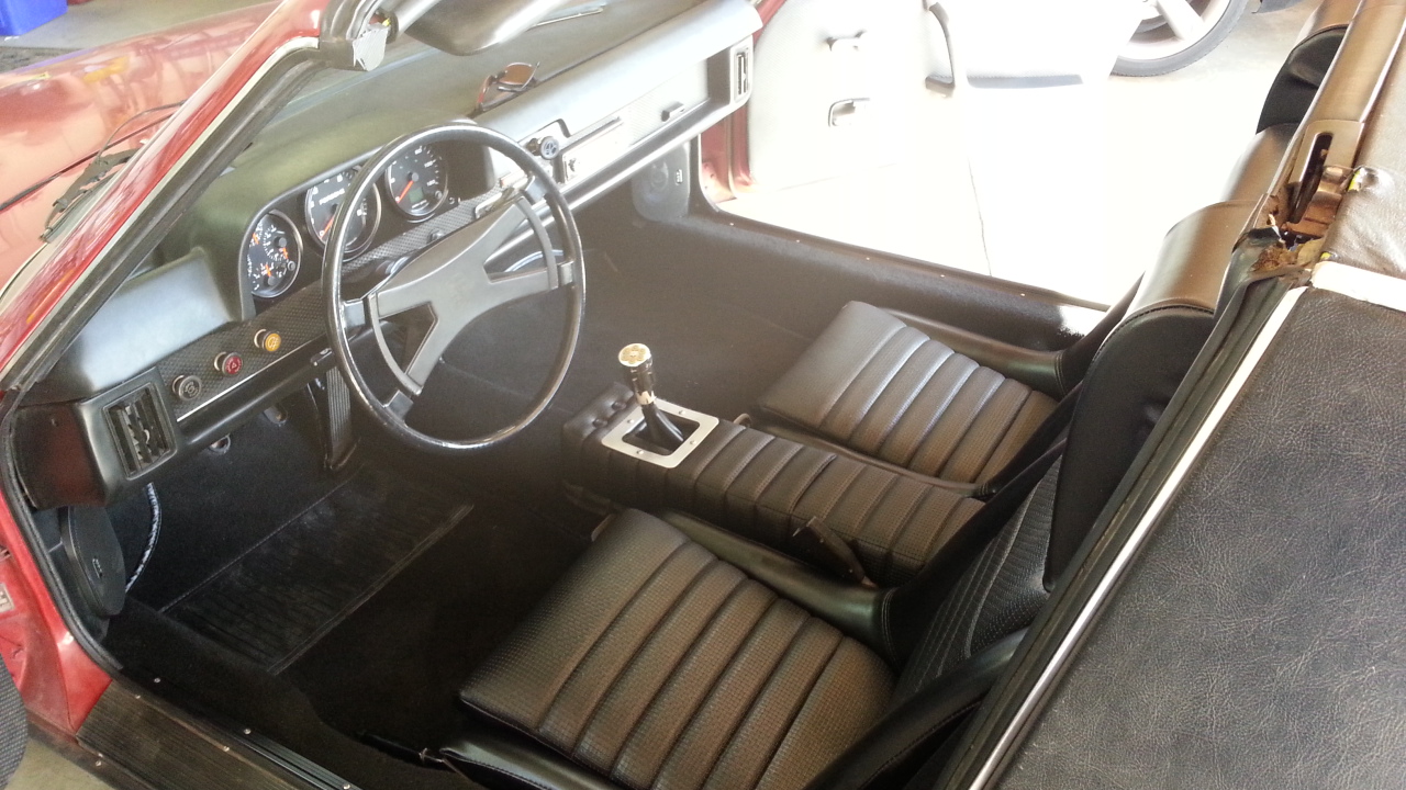

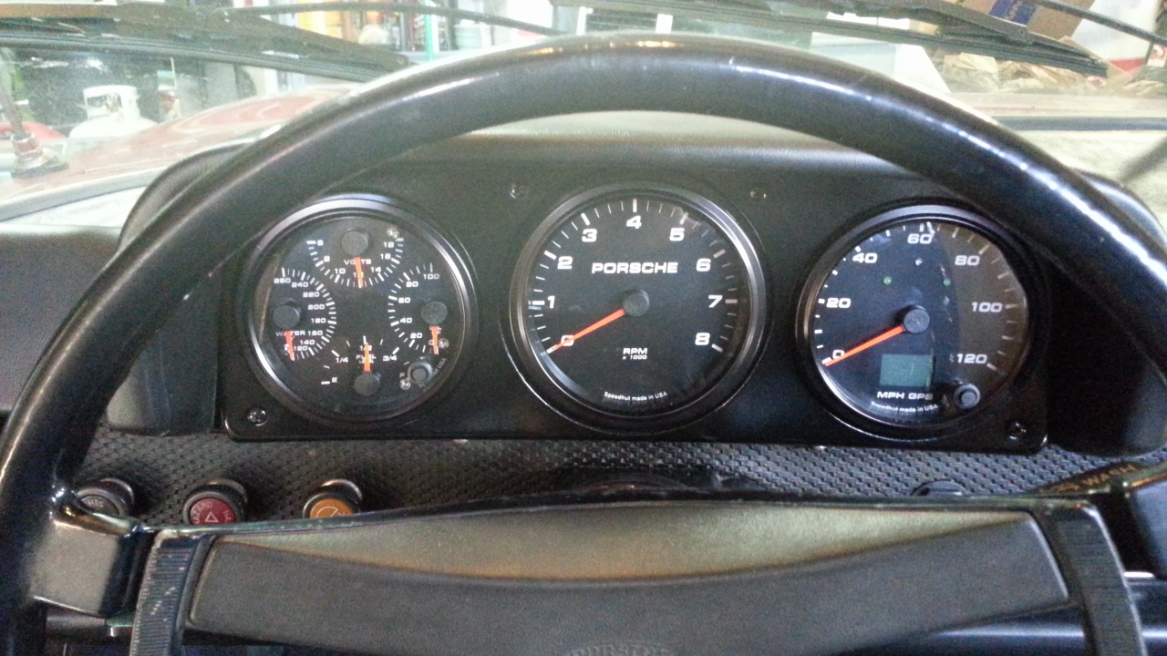

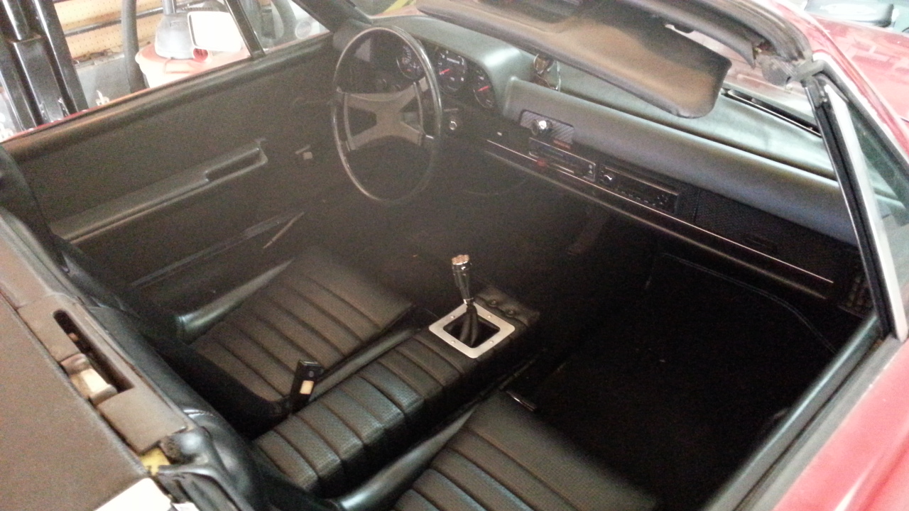

I spent the entire weekend working on the car. (IMG:style_emoticons/default/biggrin.gif) I was able to knock some big items of the "to do" list. The heated seat and the SpeedHut gauges are installed and working. I also completed the center console. My hazard lights were blowing the fuse everytime the switch was pulled to the on position. It turns out the contacts for the light bulb were shorted inside the knob. It is now sorted out and functional.

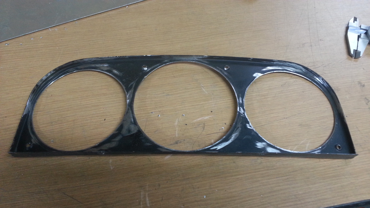

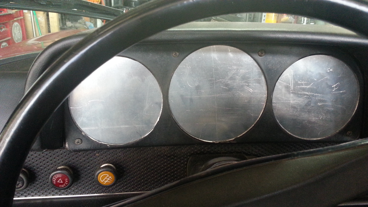

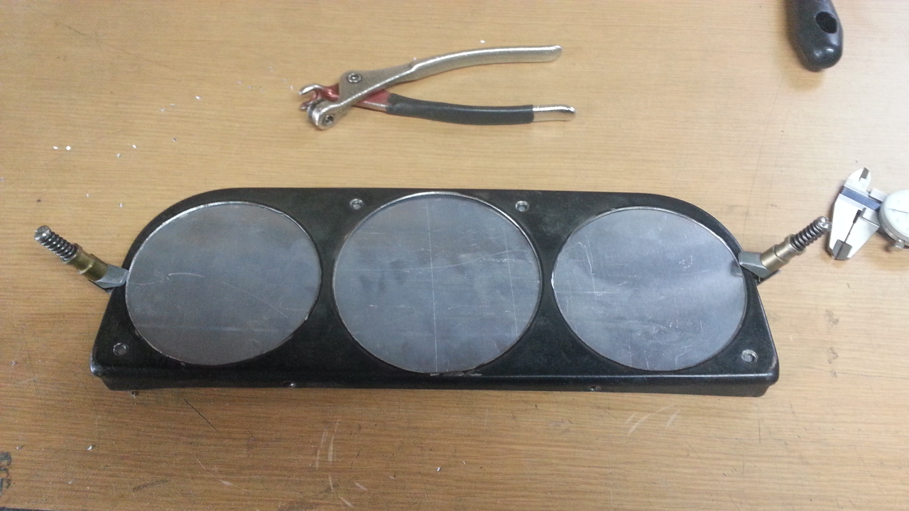

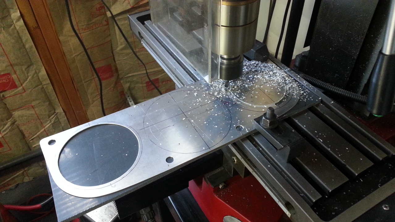

The SpeedHut gauges I ordered were 4" for the quad, speedometer and a 4.5" tach. They were smaller than the OEM gauges and I didn't like the way they fit in the stock panel. So, I decided to do a little cutting (IMG:style_emoticons/default/sawzall-smiley.gif) to achieve a better fit. I cut the back off the OEM panel to allow for a piece of aluminum to be placed behind it. After a little time on the mill "Presto" a better fit.
post Sep 5 2016, 06:11 PM
Post #298
914-6 GT in waiting
Posts: 20,511
Joined: 19-September 09
Member No.: 10,825
Nice job!

matthepcat
post Sep 5 2016, 07:18 PM
Post #300
Meat Popsicle
Posts: 1,462
Joined: 13-December 09
From: Saratoga CA
Member No.: 11,125
Love your center console and shifter set up. Looks great.
I had a set of those gauges on my last two cars. Love them.
