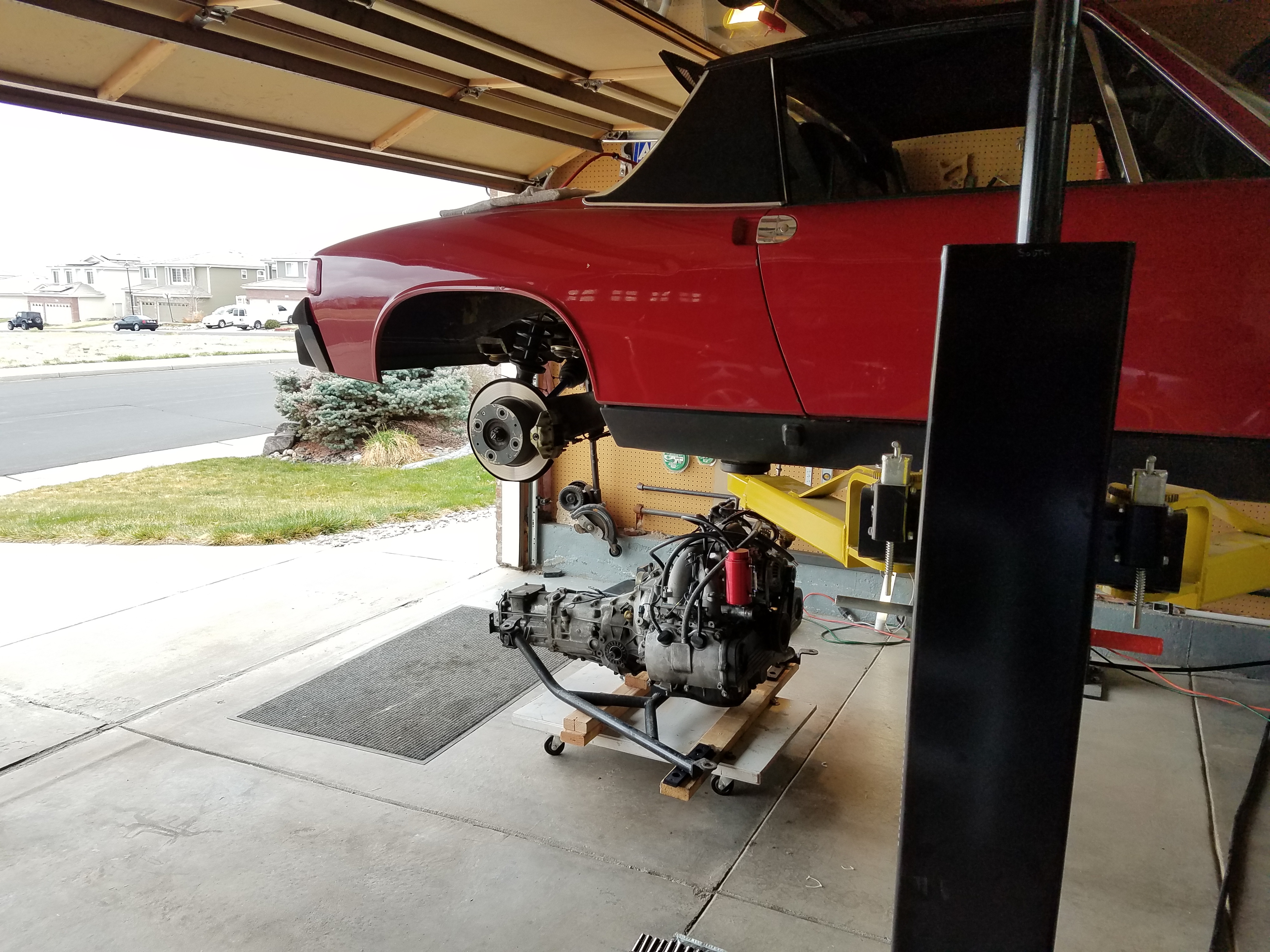

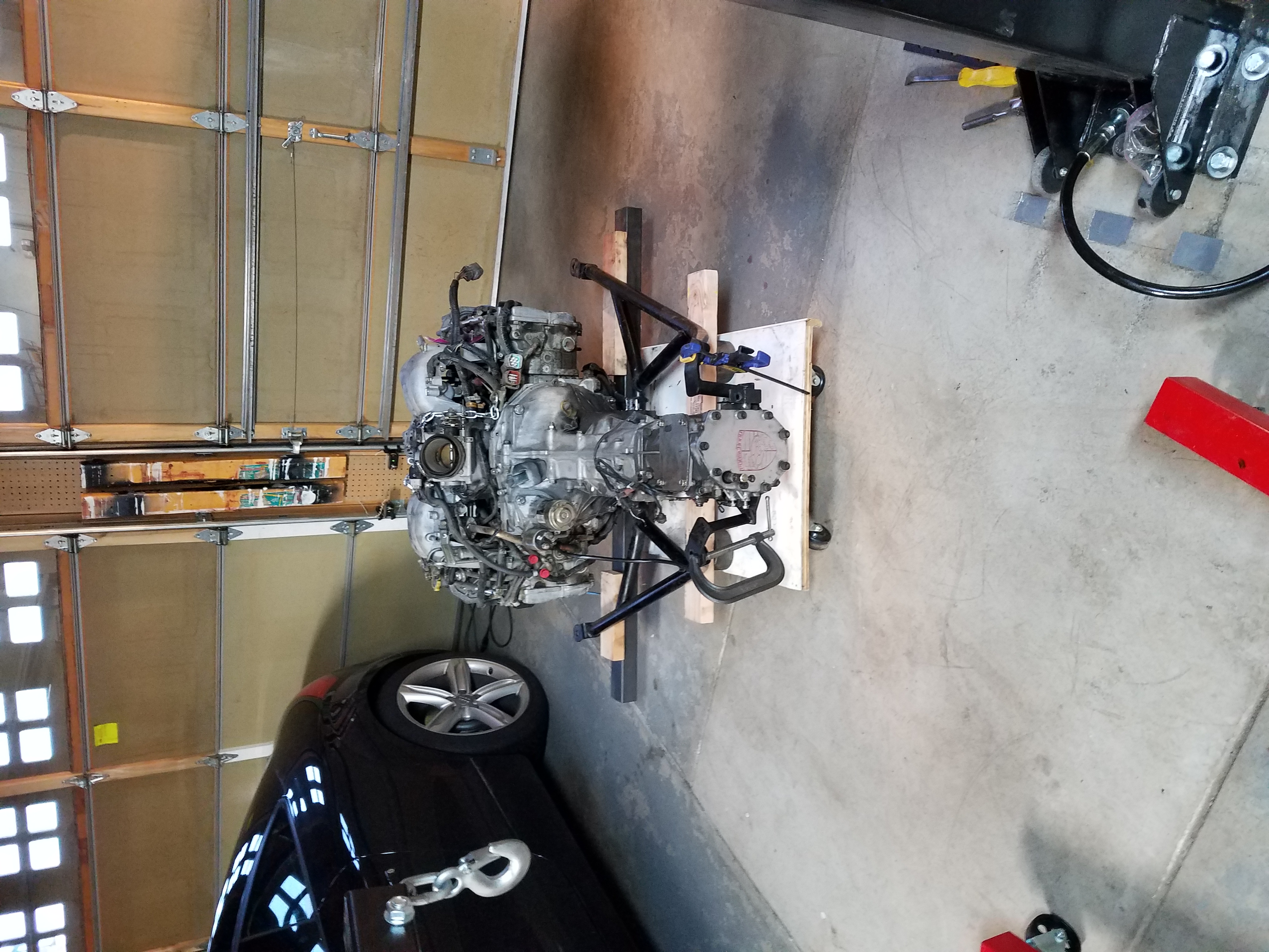

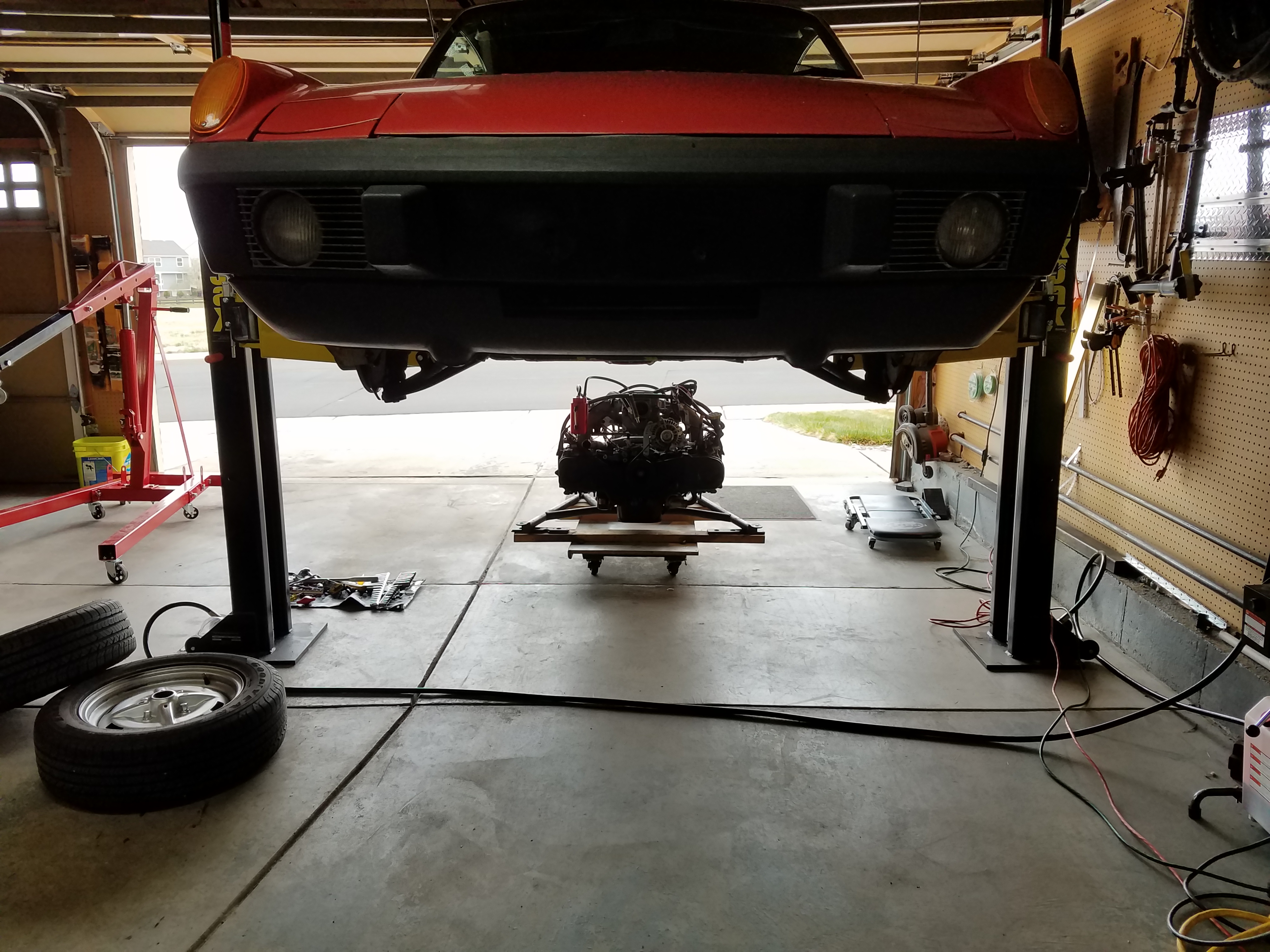

2.5L is out.

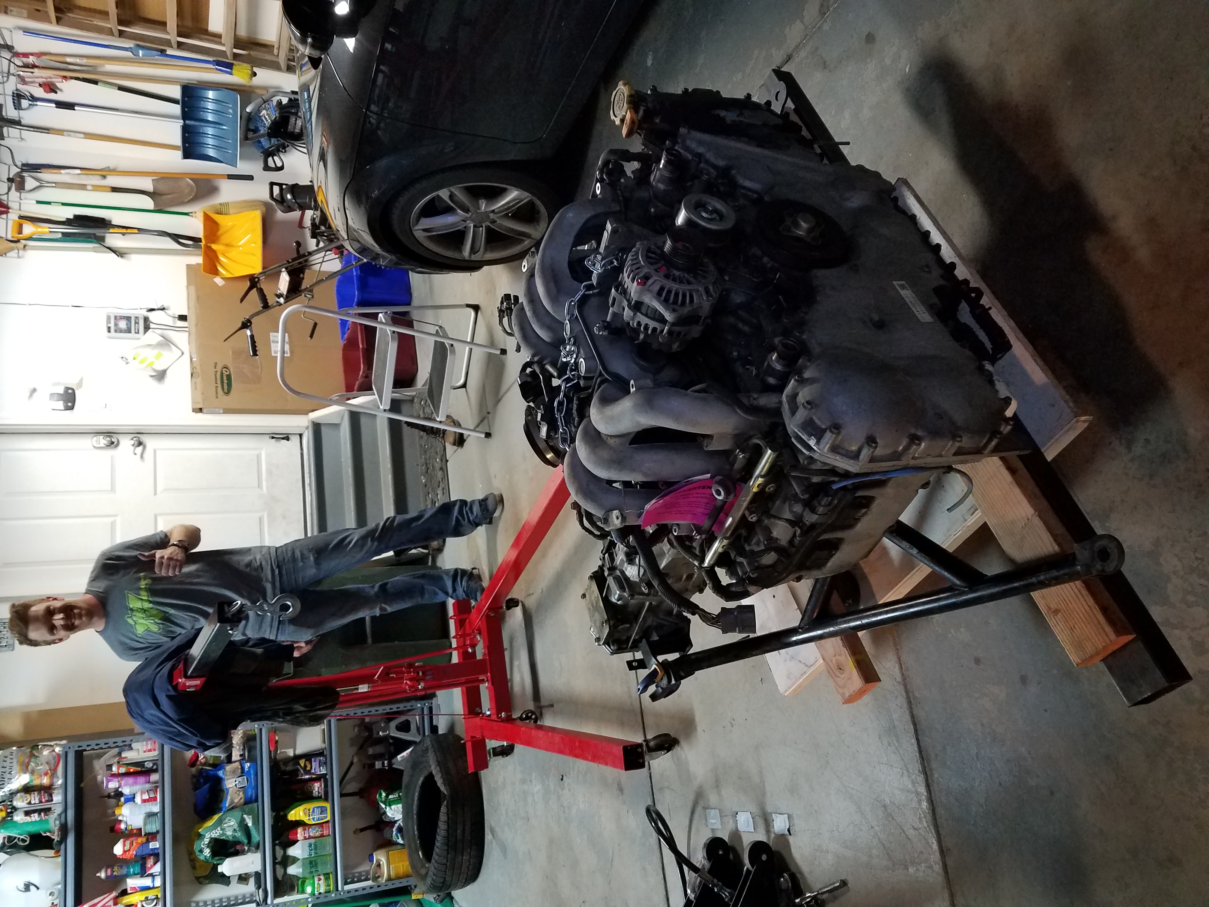

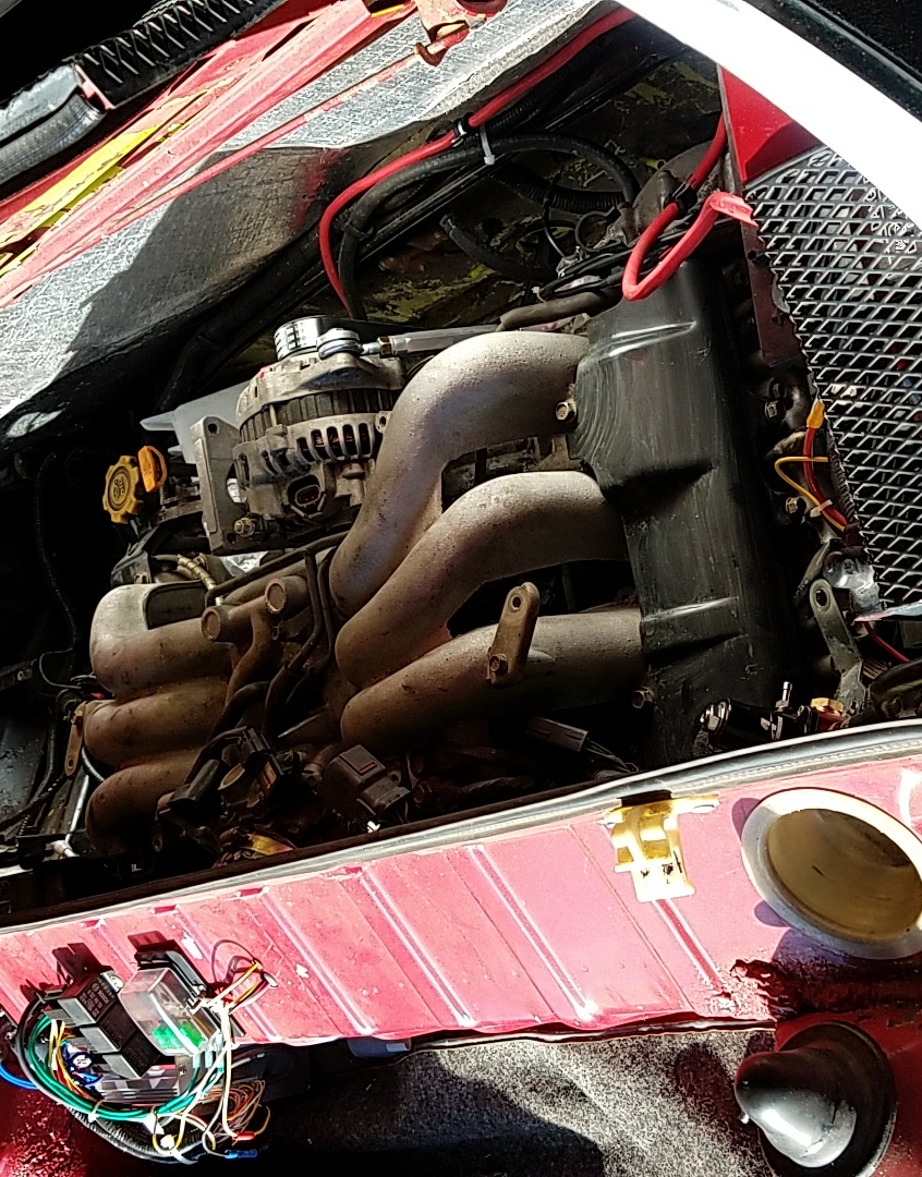

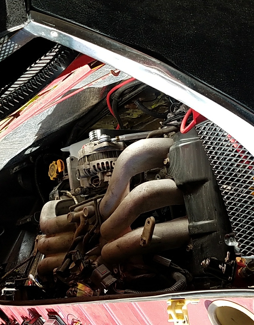

With a little help from the Denver 914 outlaw crew, the 3.0L is now installed in the car. Ok, I just made up that outlaw group but the four guys in attendance all own 914 conversions. (IMG:style_emoticons/default/driving.gif)

Might not run with your intake capped (IMG:style_emoticons/default/poke.gif)

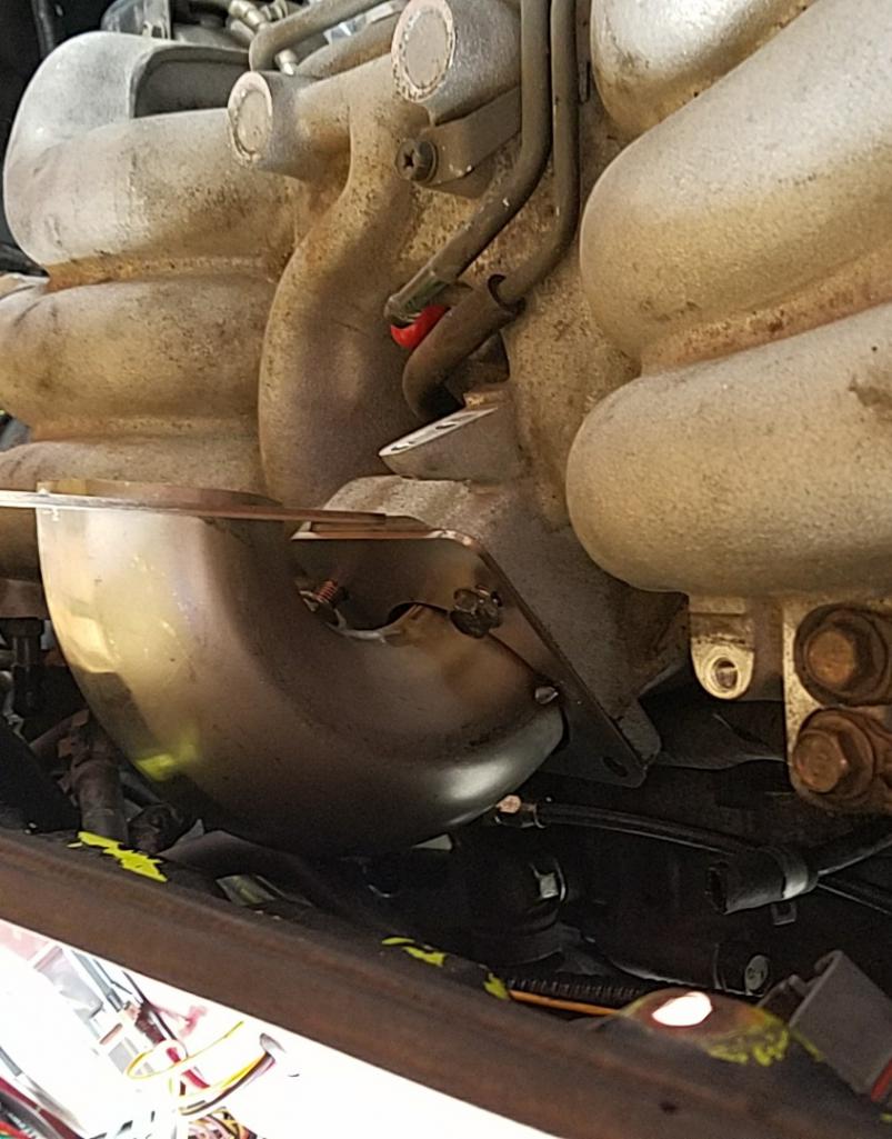

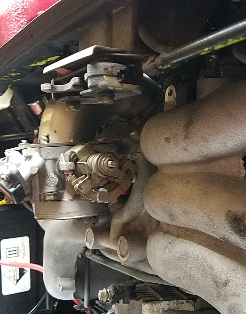

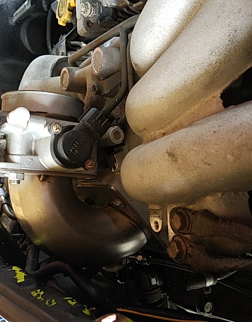

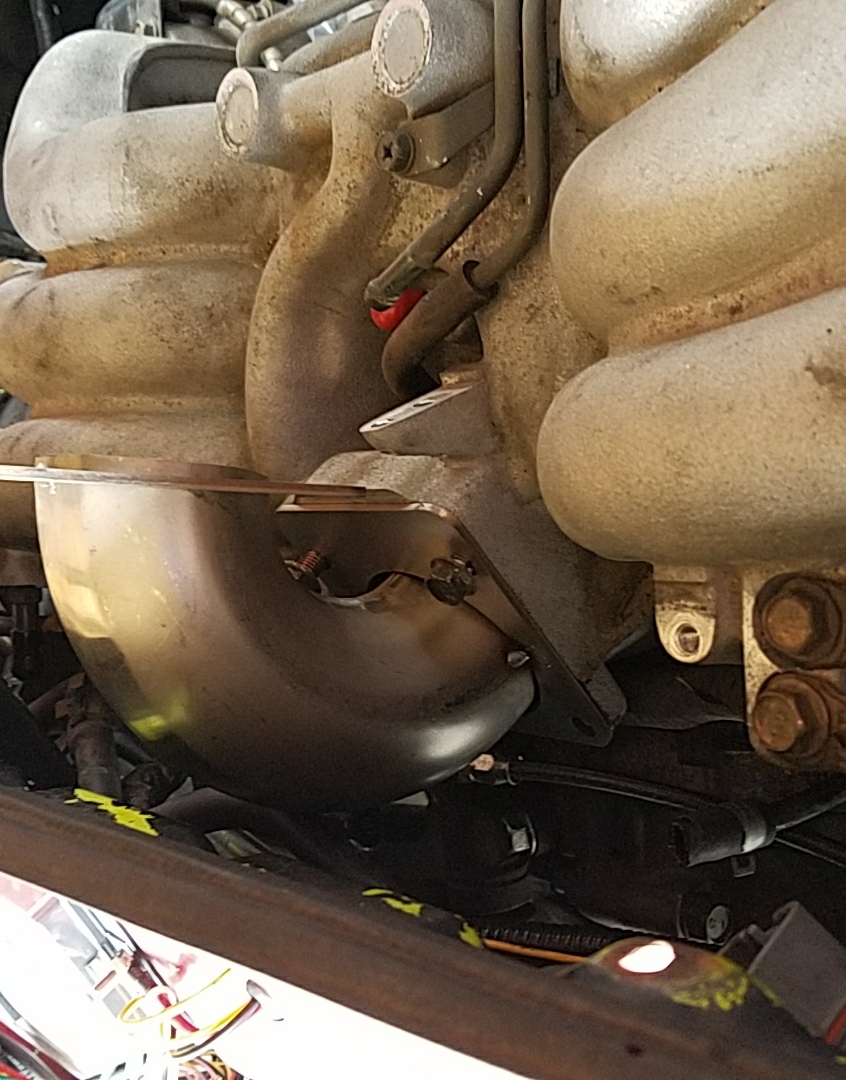

Working on the Rnellums custom throttle body flip. This allows the installation of an EZ30D without cutting into the trunk for the air filter.
