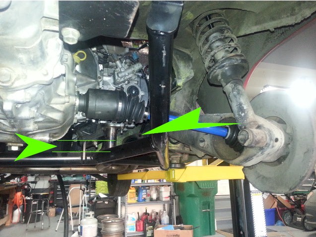

ap
question? if the cradle was 1 inch closer to engine, would the exhaust your're using interfere with cradle?
is you exhaust an ebay special or brand name?

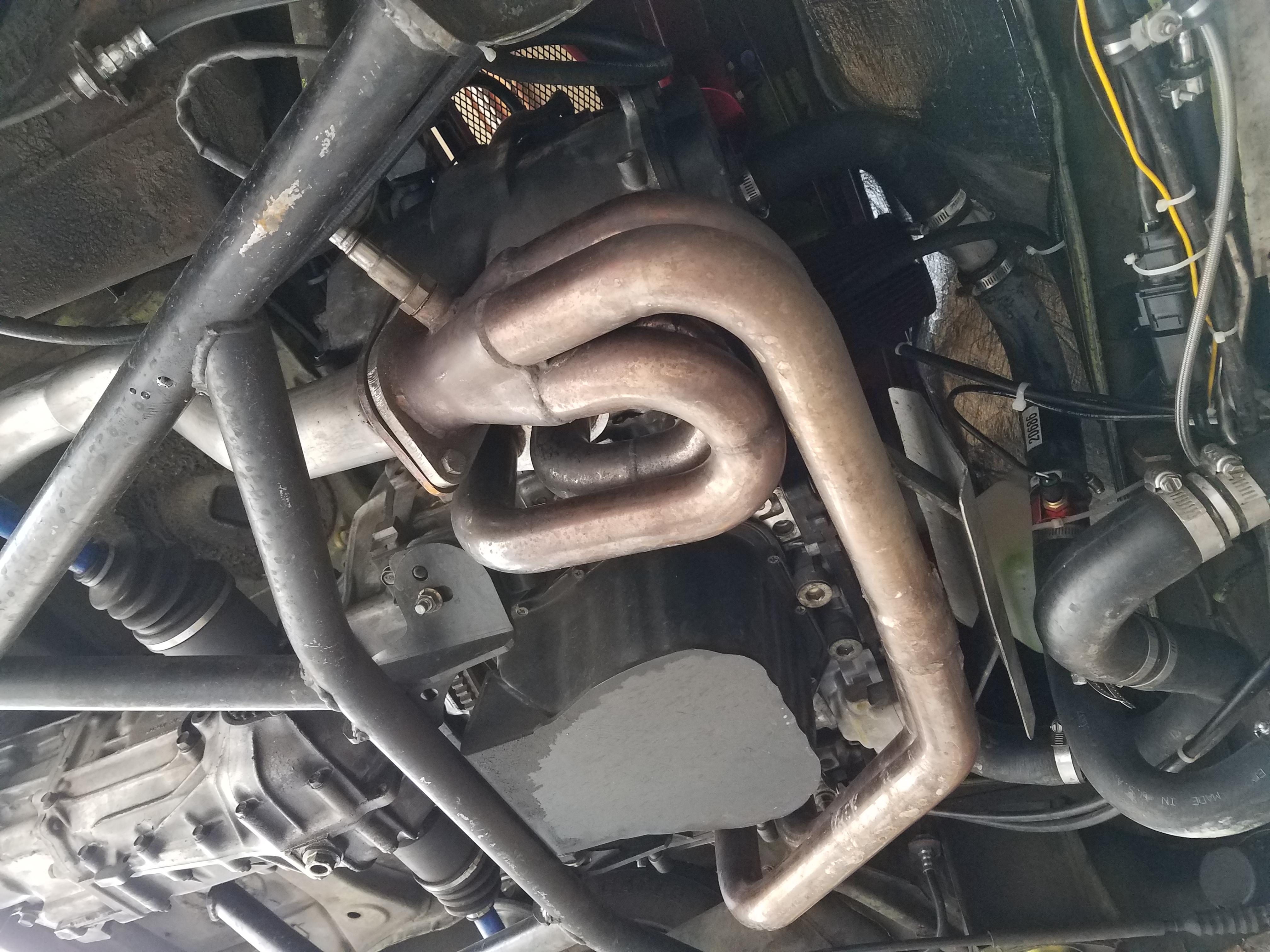

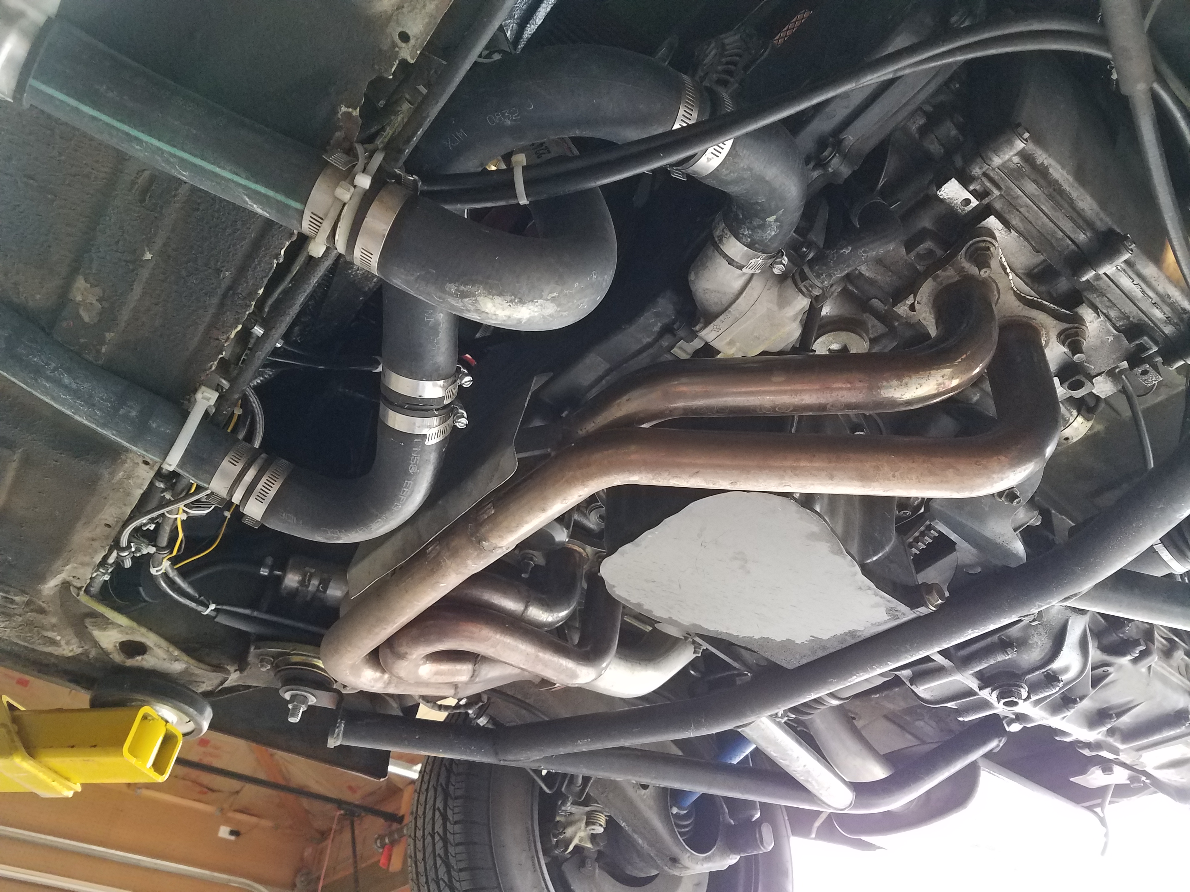

Hey Jim,
I can't be positive but I think it would clear. I don't have the 2.5L installed in my car anymore or I would measure the clearance for you. I did find a few more pictures of the install.
I purchase my header second hand so am I not sure what brand it is. It appears to be the same one in your post.
It would be awesome if you started to offer cradles. It is a definite need in the conversion world.

jimkelly
post Jun 14 2017, 08:38 AM
Post #389
Delaware USA
Posts: 4,969
Joined: 5-August 04
From: Delaware, USA
Member No.: 2,460
these pics are a big help : )
thank you

The heat shield is a nice touch
A&P Mech
post Jun 15 2017, 12:13 PM
Post #391
Posts: 401
Joined: 10-September 13
From: United States
Member No.: 16,371
Thanks, the lower hose was pretty close to the header. The heat shield worked like a champ.

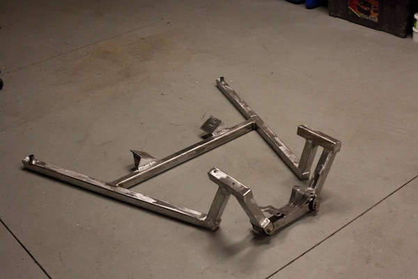

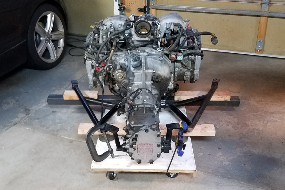

as for your 6 and coldwater's cradle and trans hangers.
did you have to modify the cradle or hangers to fit engine and or trans into your car?
I see you have to make some sweet exhaust from scratch.
your pic
A&P Mech
post Jun 24 2017, 09:02 PM
Post #396
Posts: 401
From: United States
Member No.: 16,371
No modification to the cradle was necessary to install the 6 cylinder. The coldwater cradle works but there are a few things that I would change if I was going to redesign it.
The area around the exhaust is very tight . It is hard to get the exhaust system to exit the head and clear the cradle.
If you use the stock subaru engine mounts to attach the engine to the cradle, then the motor is soft mounted to the cradle and the the transmission is hard mounted to the cradle via the transmission hangers. The cradle is soft mounted to the car via the stock 914 mounts. I think it would make more sense to solid mount the engine to the cradle and let the cradle soft mount to the car. Or hard mount the cradle to the car and add soft mounts to the transmission hangers. As it is now I feel like a lot of stress is transmitted through the transmission hangers and into the cradle.
