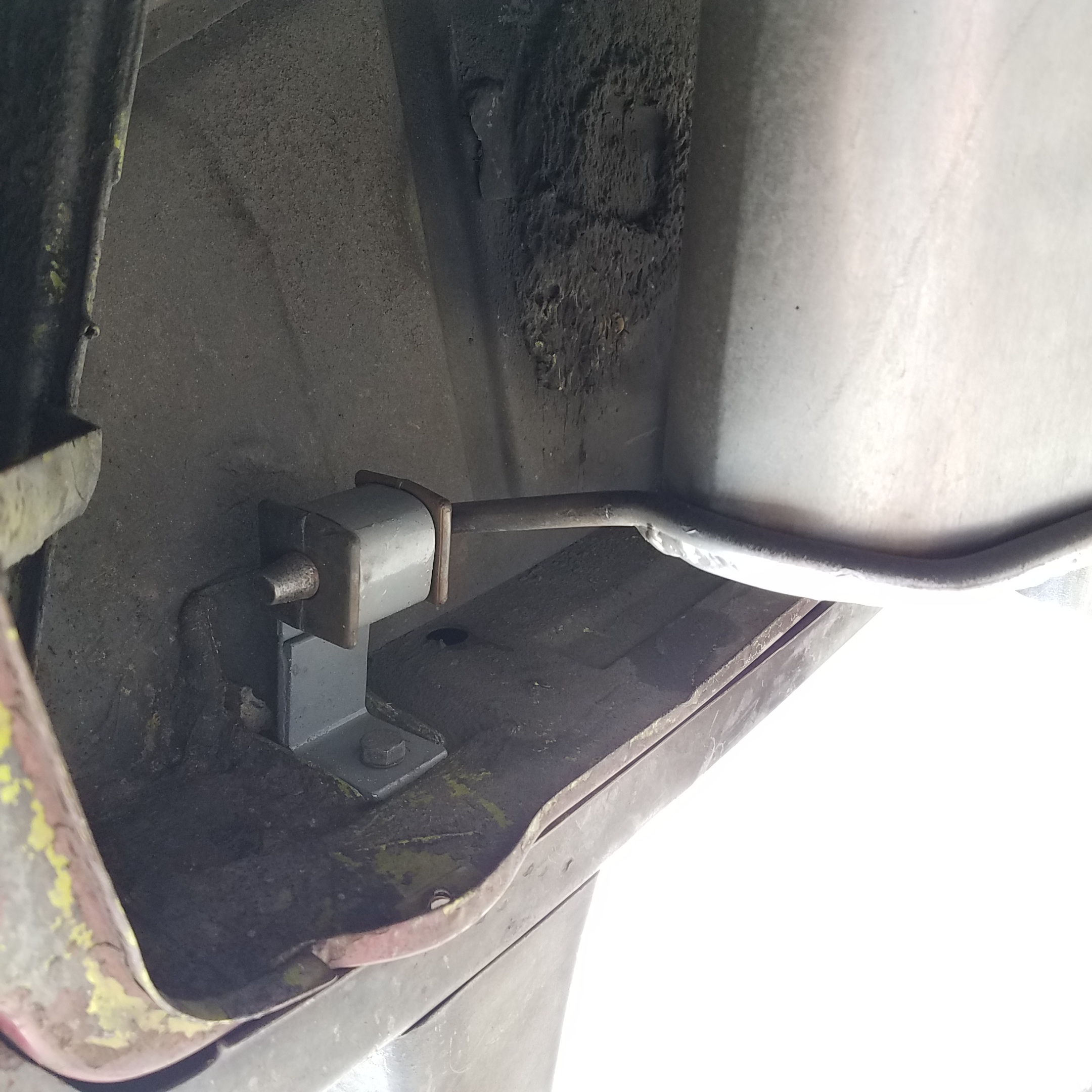

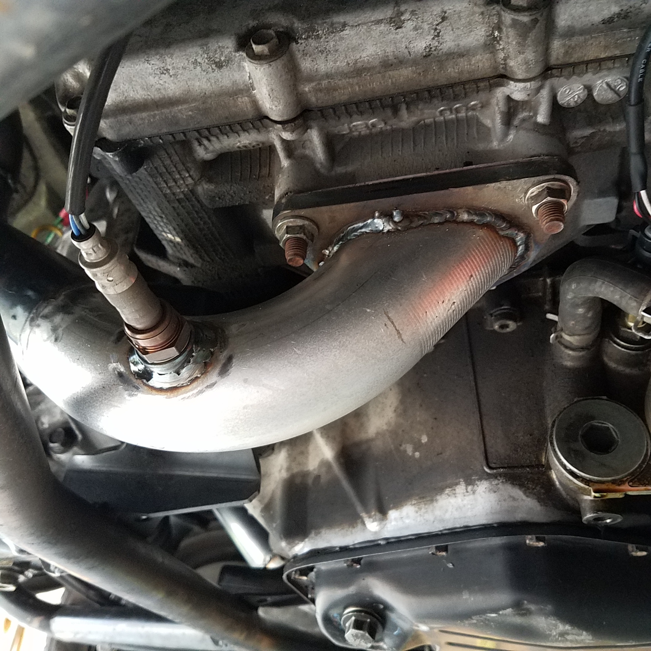

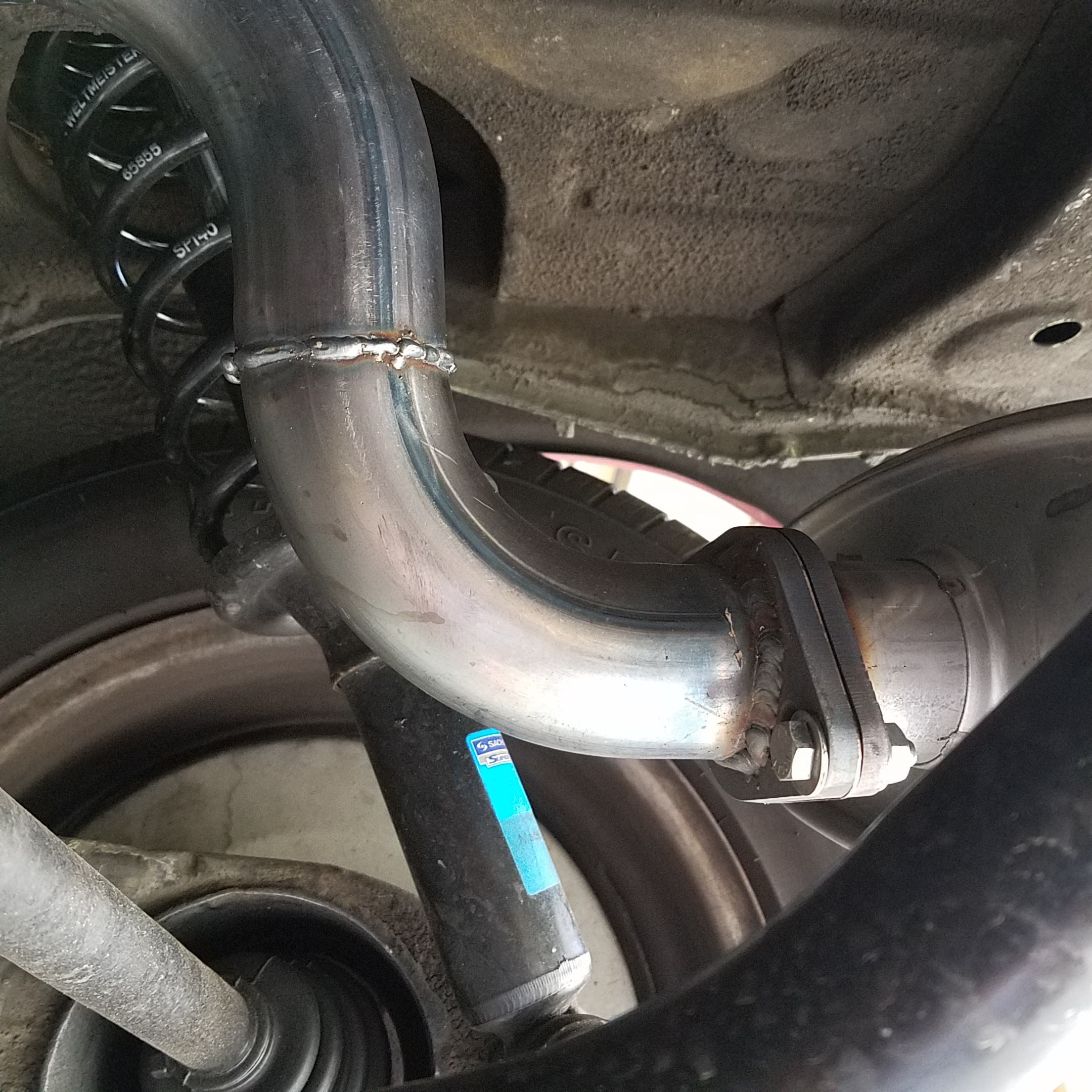

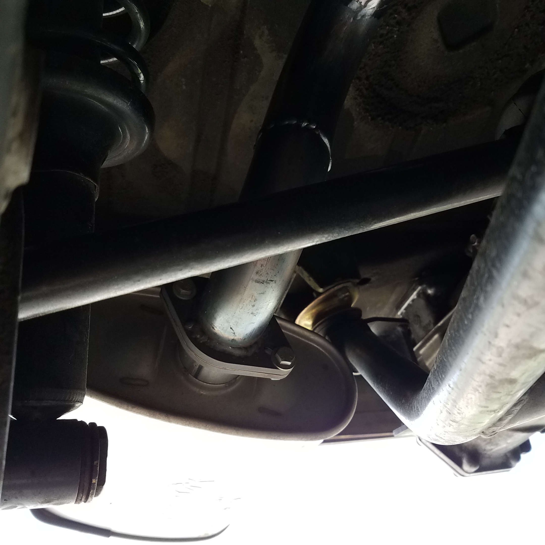

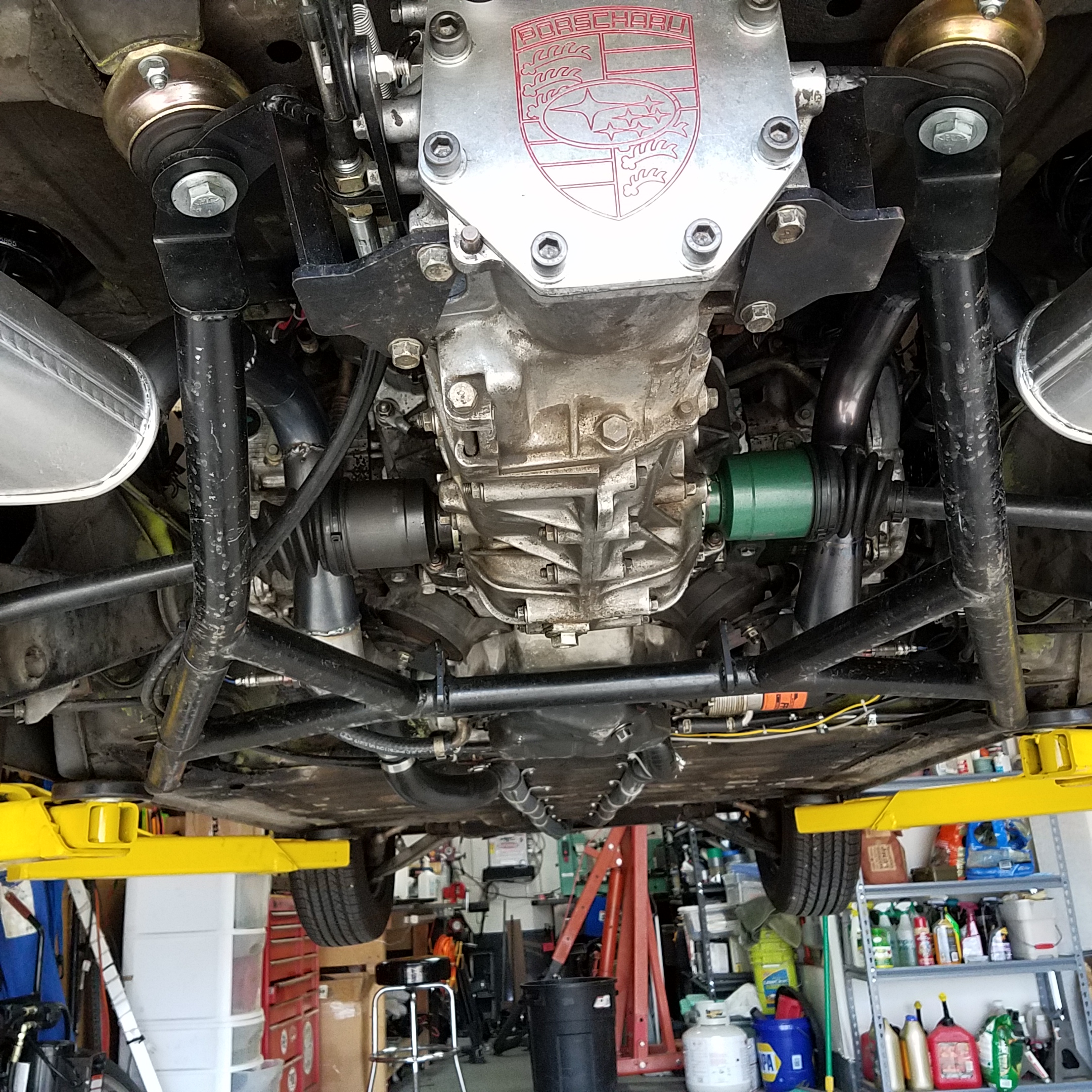

QUOTE(mgp4591 @ Jun 25 2017, 11:53 AM) *
QUOTE(rnellums @ Jun 25 2017, 07:18 AM) *
The trick to quiet is small tubes. Iim running 2.5" all the way back and even with three mufflers there is a lot of drone. Sounds great when I'm wailing on it though...
I will be moving to headers like Ray's in the near future. Much more enjoyable all around.
2-1/2 is probably overkill considering the displacement and the short run of the exhaust. I like the two outlets in the glasspak but I agree that the small pipe approach is the best for sound control. You'll have all the power you'll need with the header and pipe setup like Rays, especially split like his is and the sound seems to be spot on. I'd like to see more of how the exhaust is run after the header exit pipe... Congrats Ray! (IMG:style_emoticons/default/aktion035.gif)
I finally got some pictures of the installed exhaust system. Still loving the sound!
