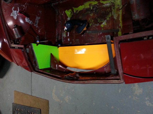

I am not sure it would be of any use. The shrouds where made to fit the radiator mount that I fabricated. I am more than willing to share what I have. I made the patterns for the shrouds out of poster paper.

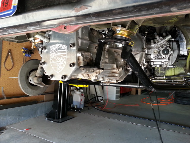

The engine and transmission are installed! One step closer to (IMG:style_emoticons/default/driving.gif)

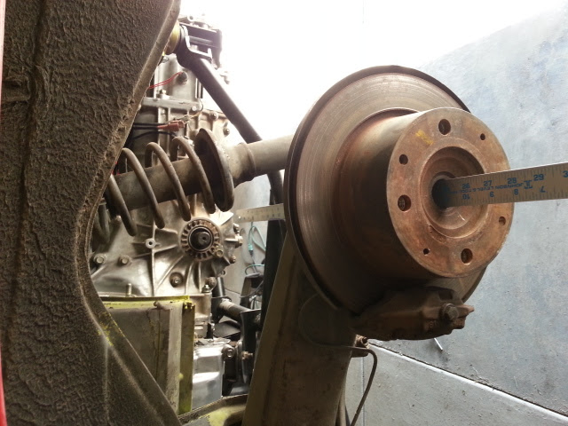

Not sure if the axle alignment is correct? I realize that the suspension is unloaded but the Subaru sub axles appear to be about 2.5" forward of the hubs. I am using Ian's cradle so there is no adjustment fore or aft. Any ideas?

Your Axles should be fine there. Shouldn't add such an angle you will have an issue. Especially with your build. If you were doing a 6 or WRX crazy build. HP wise it might be something to worry about. I'd check mine but it is off for paint. I'd see how it looks with your Axles bolted up with your CV's. I remember Renegade's v8 builds used a 1 1/2" set back blocks for the transmission. Seen some that were pushed back even farther & did fine. I'm thinking the extra couple inches forward is to help with your intake & maybe not needing to cut the trunk (IMG:style_emoticons/default/confused24.gif)

Cool. Thanks for the reply! I was able to flip my intake so I didn't have to cut my trunk for that, but I did have to put a small hole in it for the clutch release arm. I am now trying to figure out the fuel system. The EJ253 doesn't appear to have a return line from the fuel rails to fuel tank??? I am guessing I will have to source a fuel pressure regulator that has a bypass to allow the unused fuel to return to the tank or I could just keep the pedal to the floor and not have any un-burned fuel. (IMG:style_emoticons/default/happy11.gif)

I had to have a cutout for my starter too. Doesn't come into the trunk a lot but wouldn't fit under (IMG:style_emoticons/default/sad.gif) . Ditto on the clutch arm. I have a return line on my setup (IMG:style_emoticons/default/confused24.gif) . Can't remember if there is a pressure regulator. Don't remember there being one there by my pump (IMG:style_emoticons/default/idea.gif) . Damn another thing I can't go out & look for you. I am finally getting to know my setup better (IMG:style_emoticons/default/rolleyes.gif) . One drawback to not doing the conversion myself originally.

Yeah I agree, your axles should be fine like that. Take a look at 914 axles. They're a lot more angled upward than those are sideways.

The lift is awesome!!!! It is easily the best purchase I have made in a long time. I was able to remove my engine/transmission twice today with out a single jack stand and without any help.
