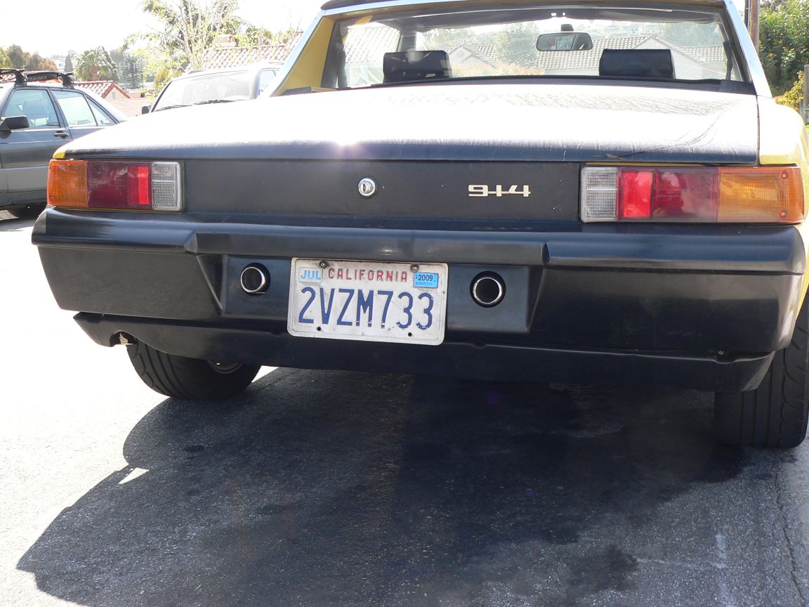

I finally got exhaust pipes installed! Until now, exhaust had been exiting underneath the trunk. Now it exits near the license plate. I haven't seen an exhaut like this on a 914. It almost remind me of the exhaust on a VW bug!
-Tony

I looked acouple of times through the posts, I have not seen a current sound bite (U tube) to hear the exhaust with mufflers. What kind of mufflers did you go with.
a sound bite of inside the car driving around, top on and off would be great.

I will definitely do some videos shortly! The mufflers are whatever generic thing the muffler shop had, probably some kind of flowmaster or equivalent.
Good luck with your conversion!
