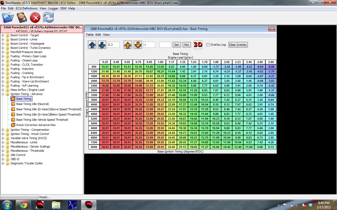

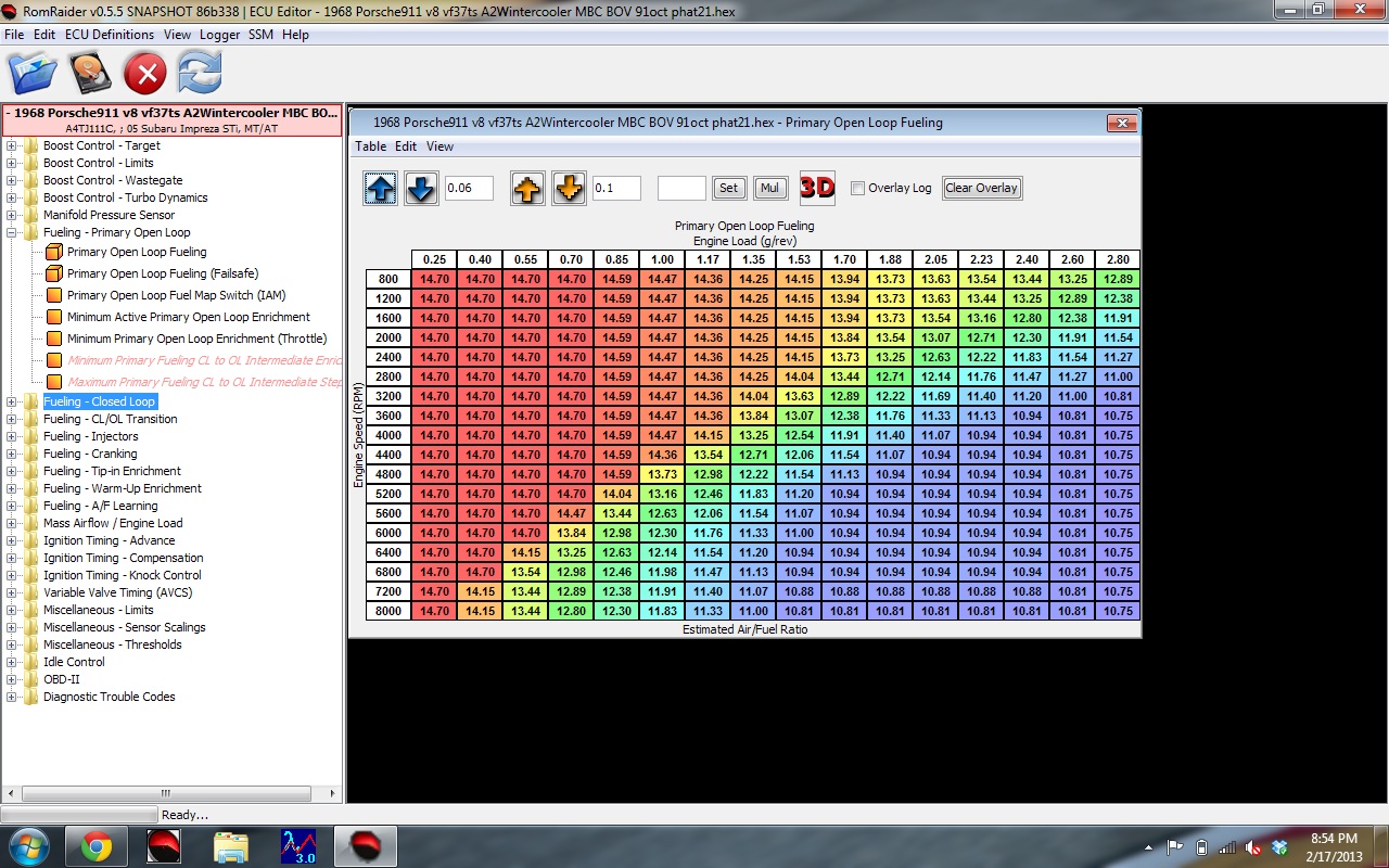

not sure if this would be any help but this is from my current tune. i dont know how to convert g/rev that the stock ecu uses to kPa that ms uses but perhaps as a reference its useful
(IMG:http://www.914world.com/bbs2/uploads_offsite/iwolfe.com-5340-1361164020.1.jpg)
(IMG:http://www.914world.com/bbs2/uploads_offsite/iwolfe.com-5340-1361164021.2.jpg)

Ron, How much boost are you running at WOT? This will allow me to convert the g/rev. This is a mass airflow conversion based on density and stroke volume for load.

note: I am running AVCS so that will alter base timing. let me boot up the laptop and ill screen shot that as well.

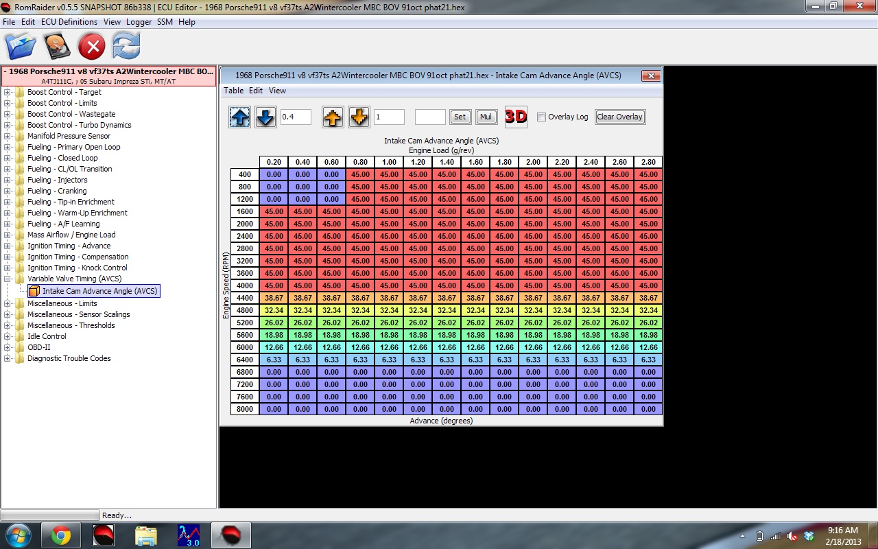

I am running a manual boost controller. both tuners i interviewed (one of whom did my tune) discouraged the ebc or even the hybrid i initially had set up. they said they'd do it but stated the tune with the mbc would be better so i pulled the ebc and just ran a straight mbc
here is the avcs table
(IMG:http://www.914world.com/bbs2/uploads_offsite/iwolfe.com-5340-1361208481.1.jpg)

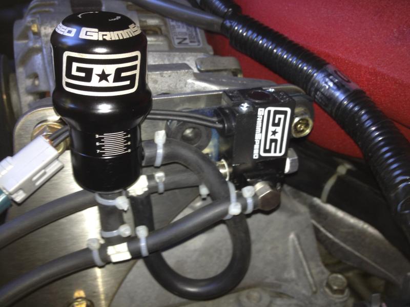

btw, ive got an extra MBC if you want it, a donation to the 2013 Build. its the one on the Left. the one of the right is the ebc i was going to run.
(IMG:http://www.914world.com/bbs2/uploads_offsite/iwolfe.com-5340-1361208823.1.JPG)

OK. g/rev = (pulse width / (2707.09 / injector flow rate))
Are you running stock injectors? These should be 540cc/hr. If so, I can easily calculate a pw table for MS.
The timing table really helps too.

Ron, Do you have any pulsewidth numbers? Your fuel table is the target AFR for the open loop running. this is a strange way of presenting load as it should be a target table for a closed-loop system.

QUOTE(jpnovak @ Feb 18 2013, 01:34 PM) *
@Chi Town - Thanks for the compliments
no, no pw numbers. i thought it was odd too. cant really wrap my brain around how the ecu responds to inputs and the tuning methodology. its not like the MS that uses the fuel/VE table for a fixed amount of fuel delivered under open loop situations. in the case of closed loop, compares measured ARF to the target AFR table and increases / decreases fuel from the VE table via pwm or something to that effect. this would be for closed loop operation or when tuning with VEAL or even manual by look at logs via mlv. this is a comparison of load (kpa) vs engine speed (rpm)
suby really relies on MAF and engine speed. MAF is basically a hot wire and is at a specific temperature, the more air passes over it, the cooler it will become. the ecu then adds more voltage to the MAF wire to heat it to that temp up and thus is able to determine how much air is flowing into the system based on that additional voltage. with that and the engine speed it knows where it is on the table. it compares the AFR to the target and give it more/less fuel. but what i dont get is how much fuel does it know to start with ??? closed or open. i dont get it

Ron, I think I cracked the code.
The 2.8 value should correspond to your 18psi. If you scale the rest of the values by a (260kPa/18psi) the lowest value corresponds to 23 kPa. My car idles about 31 kPa so this is just about right to idle in the lowest corner of the map.
The rest of the values are just a linear distribution of the load table. In my case, I just scale by MAP reading. Simple. Effective.
Now if I could just figure out a way so that I did not have to type all those numbers in by hand. Ouch!
I can use the timing table and the target AFR table. Your cam setup will be slightly different and this will effect fuel values. No problem. I will just tune to the target AFR. Easy. I admit I was unsure how lean/rich to make these engines under boost. I found some info that said 11:1 under WOT boost was a great target. I see you are mostly a 10.8:1 so this is slightly more rich.
I am also surprised how much timing is pulled out at 18psi. Must be ready for a big bang to delay timing and pressure onset that late. Such great information.

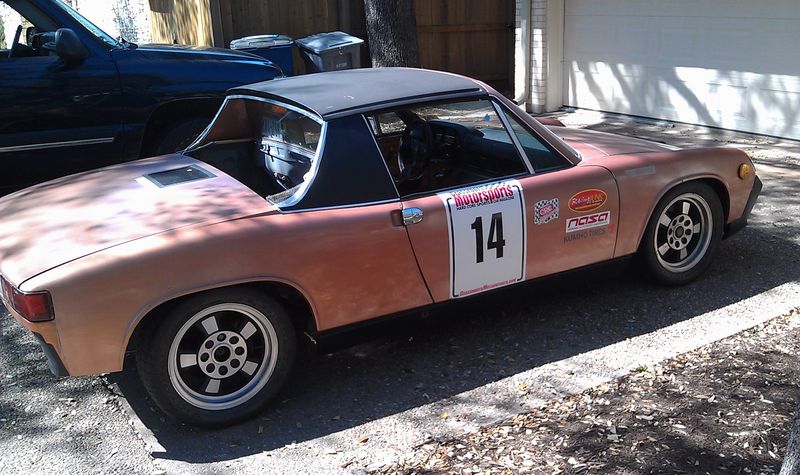

First, how many Victoracers can you fit in the trunk of your daily driver? In my case, One, Two, Thrr-eee. It takes 3 VictoRacers to fill up the daily driver trunk.
(IMG:http://www.914world.com/bbs2/uploads_offsite/forums.pelicanparts.com-10736-1361738160.1.jpg)

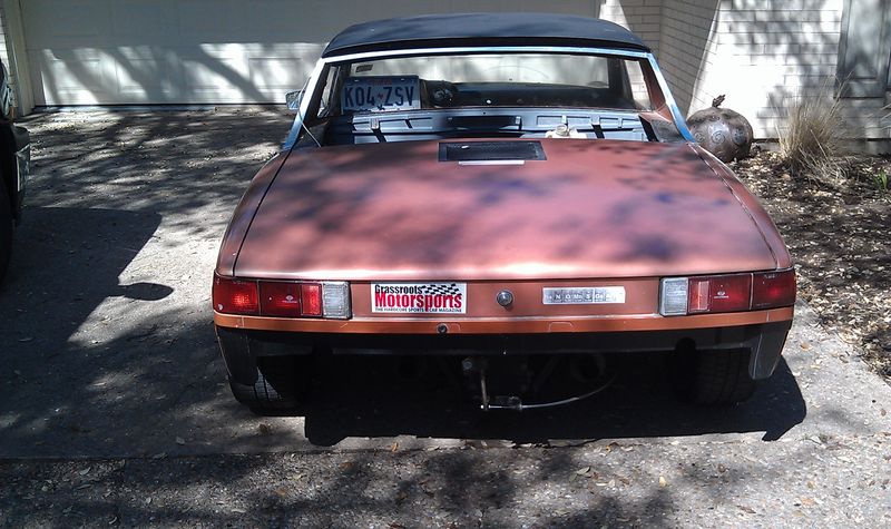

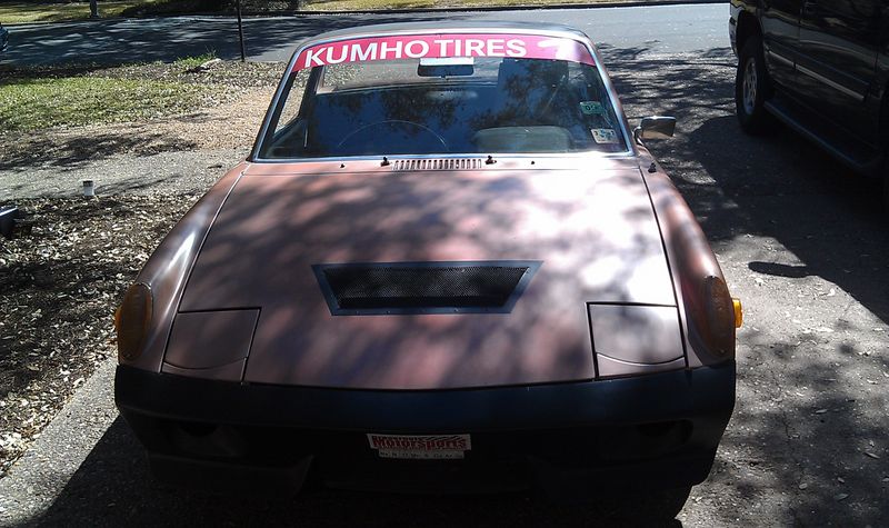

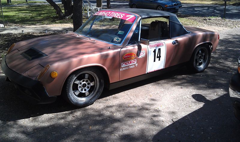

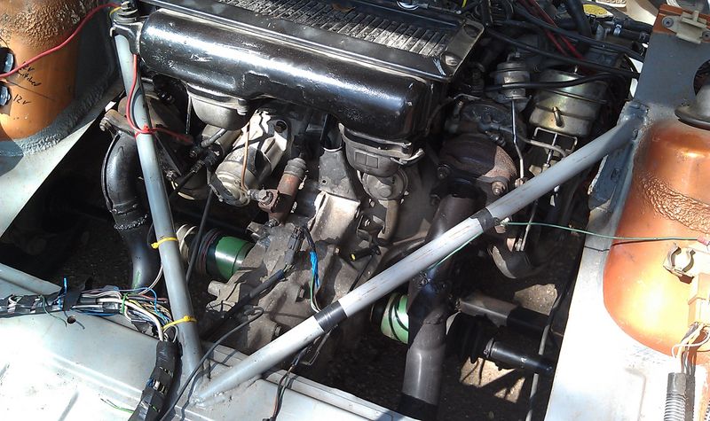

Armed with new rubber I went on to the next step. Today I started to tune the motor. Mostly low rpm. Still have not achieved boost. I need someone to drive while I tune. Auto tune (VEAL) works but I prefer to tune by hand.
Anyway, here are some pictures in the driveway.
(IMG:http://www.914world.com/bbs2/uploads_offsite/forums.pelicanparts.com-10736-1361738160.2.jpg)
(IMG:http://www.914world.com/bbs2/uploads_offsite/forums.pelicanparts.com-10736-1361738161.3.jpg)
(IMG:http://www.914world.com/bbs2/uploads_offsite/forums.pelicanparts.com-10736-1361738161.4.jpg)
(IMG:http://www.914world.com/bbs2/uploads_offsite/forums.pelicanparts.com-10736-1361738161.5.jpg)
(IMG:http://www.914world.com/bbs2/uploads_offsite/forums.pelicanparts.com-10736-1361738162.6.jpg)
