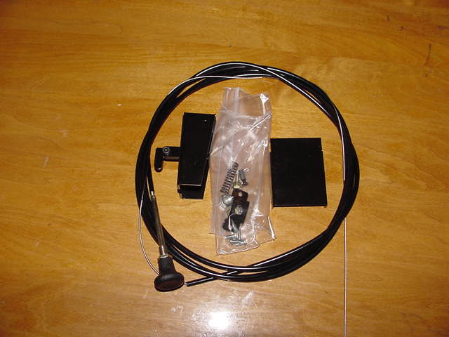

This mounts the release below the E-brake handle. Everything you will need is included. A cover for the release in the trunk is also provided. Please see http://engmanparts.com for details

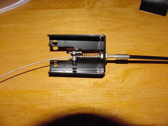

A look at the mechanism.

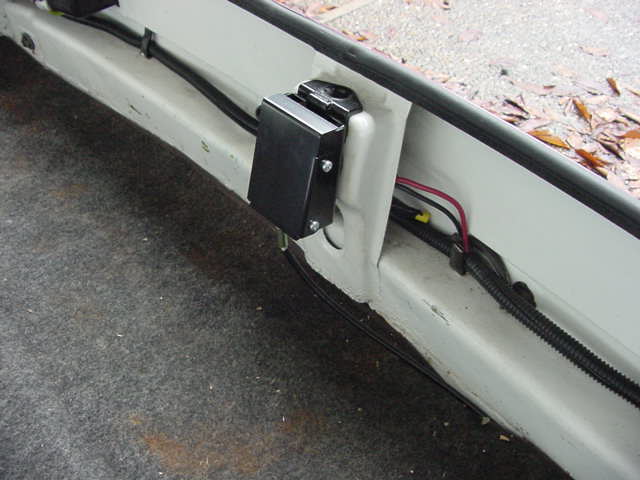

Here are pics of it in my 73.
Trunk

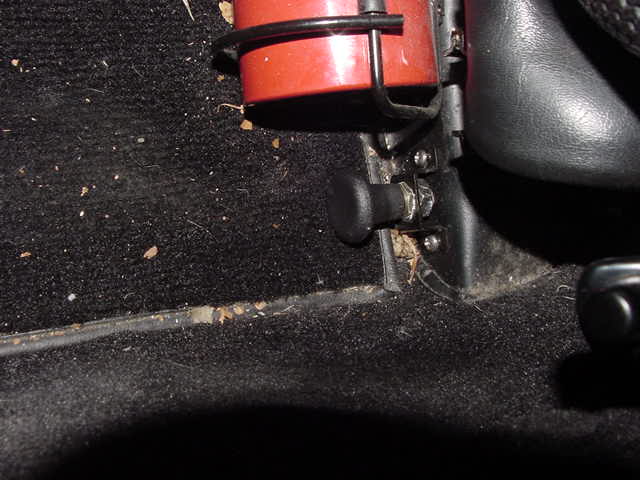

Pull handle for the release - located under the E-brake

Looking at your trunk picture: Is the cable entering the trunk directly beneath the mechanism ?
How is the cable fed to the cabin mount ?
I like your set up !
Engman
post Mar 30 2005, 05:01 PM
Zoisite
Posts: 1,349
Joined: 25-March 03
From: New Albany, IN
Member No.: 475
The cable follows the witing harness for the tailights thru the engine compartment, exits thru a hole below the engine lid release, and come out under the e-brake handle. You do have to drill some holes for the cable and cable mount pull. This is all in the instructions with a template for drilling the release pull mount.
