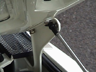

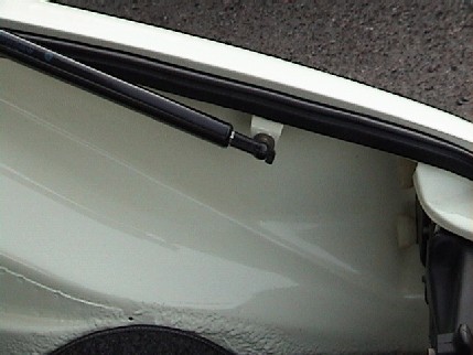

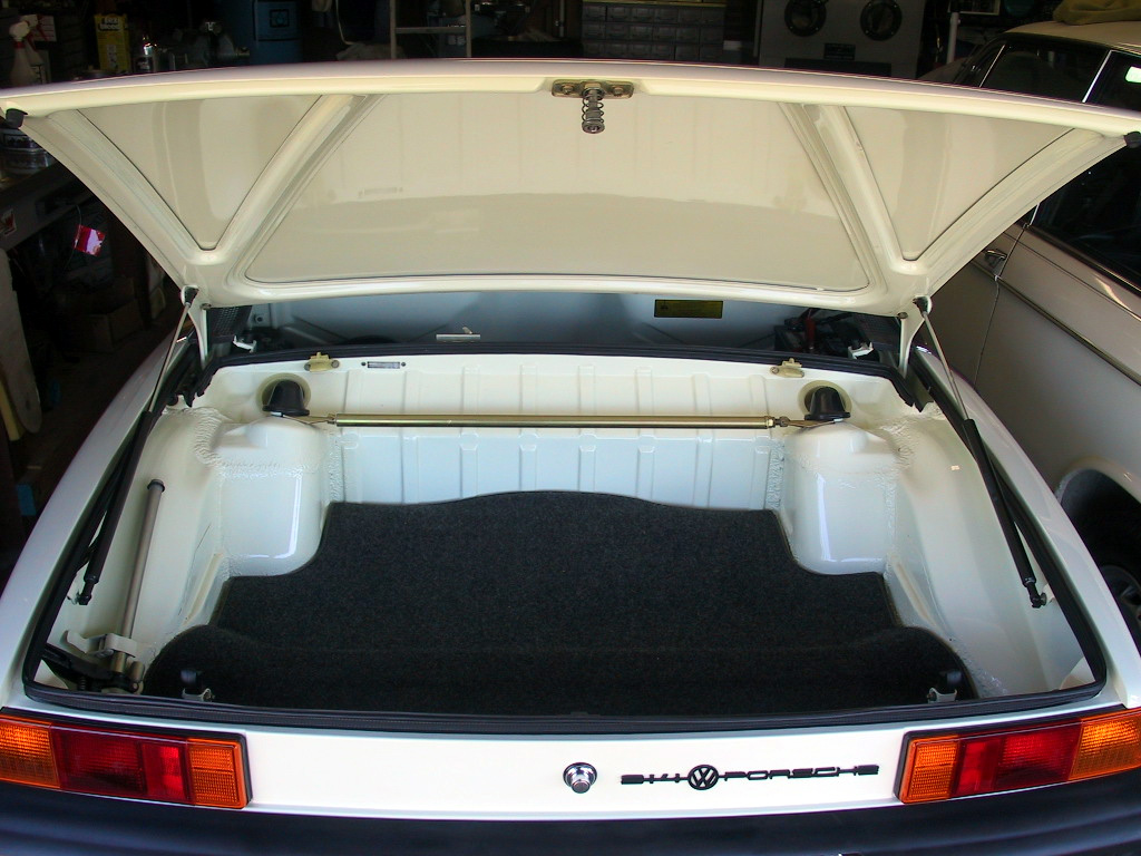

3 cars I've installed these on ... never a problem ... one 3 years ago .... Now I don't worry about torn from the body hinge brackets or replacement of those stupid rollers and the potential blood. I can put my targa top in the trunk with no problems and with the same effort it took when it had torsion bars. If you're a CW more power to you ... keep dealin' with those idiot torsion springs. With his kit you don't have to cut the seal.
Worried about screws .... spot weld the brackets. Jeeeeeeezzzzzz

Thanks, everyone, for your help/opinion. SLITS, special thanks for taking the time to post pics of the directions.

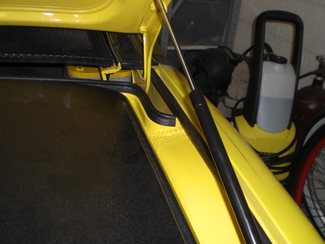

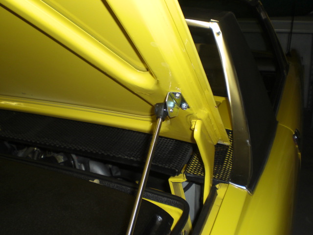

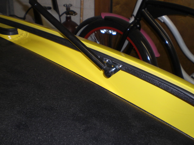

I just got a set of these shocks that were donated to the Route 66 run by ??(sorry I can't remember) The directions called for cutting the front of the trunk (IMG:style_emoticons/default/blink.gif) . I couldn't bring myself to doing it so I mounted them in a way that avoided any cutting. They work perfect, top fits in...did I mention no cutting? (IMG:style_emoticons/default/biggrin.gif)
MoveQik
post Mar 21 2008, 08:56 AM
What size wheels can I fit?
Posts: 4,667
Joined: 5-April 05
From: Scottsdale, AZ
Member No.: 3,881
Decklid
MoveQik
post Mar 21 2008, 08:59 AM
Posts: 4,667
Joined: 5-April 05
Member No.: 3,881
Trunk still intact (IMG:style_emoticons/default/biggrin.gif) The mounting brackets are reversed relative to which goes on the car vs decklid when compared to the "proper" way the instructions called for. But like I said, I couldn't see cutting the trunk for these things. It is never good when the instructions list a hacksaw as required tool for installation.
They do work perfectly installed this way. I wouldn't do it on a FG lid but stock lid is plenty strong.
